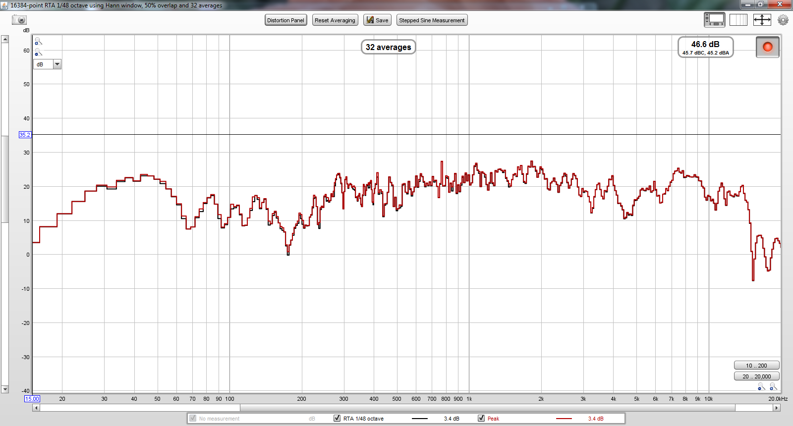

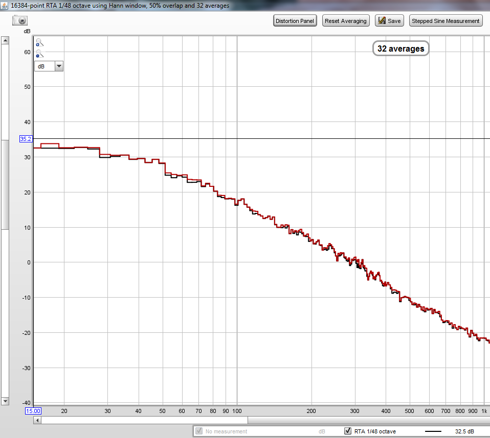

@nicoch58 - I wouldnt write these F15s off just yet. Although I'm a seasoned EE, that doesnt get me a free pass into the master speaker builder camp. These measures are continuous signal, non-anechoic and I dare say put any other speaker into someone's normal untreated living room, measure it in the same way - and you're going to get such ups and downs in the FR.

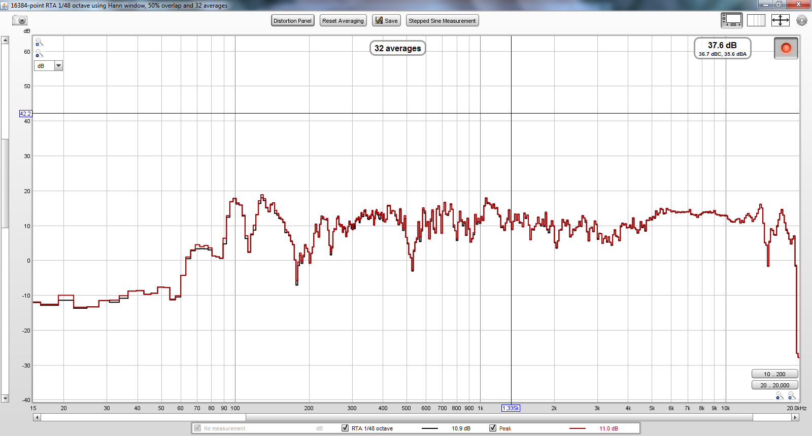

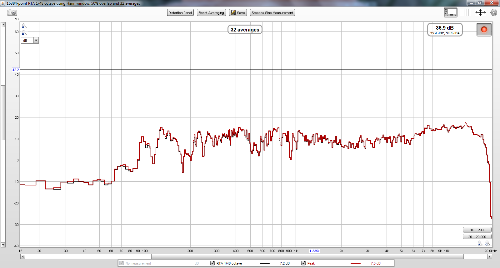

As a sanity check I tested a couple different small commercial speakers; a Boston CR55 and a Klipsch SB1. Both exhibited a similar ratty looking response seen from the Lii, with "near 20 db up/down" also - so it's the measurement that's at fault, not the speaker. Particularly when all three exhibit the same 10 db dip at the same just < 200 Hz mark. Unsure what dimension or piece of furniture placement is the cause, but suffice to say what I'm showing are in ordinary consumer use, not laboratory conditions.
I've been experimenting with grafting the woofer response onto the F15 to extend it - an octave below the 60Hz I'm getting from the lone driver would be nice. The 3rd plot is the F15 with the 18" moving some air along with it. With a little BruteFIR EQ, even flatter. I'm still in playing with it mode and I'll probably do miniDSP between my DAC and the two amps. Even if I replace that with an all-analog filter implementation after I get things dialed in.

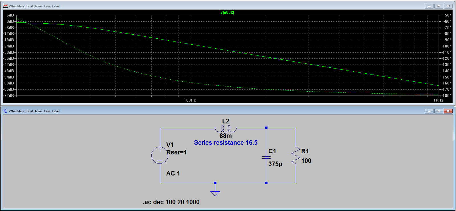

Today, I decided to clean up the pile 'o parts comprising the speaker level crossover for the 18" assist, by replacing it with a line level circuit.
The 'ol junkbox coughed up a pair of relays with 9V coils. I measured these with a GR impedance bridge (I've hung onto for ~30 years...for just such an occasion) at 88 mH. Using LTSpice, I simulated the circuit (pic below), being sure to include the parasitic resistance of the inductor. Again getting lucky with parts I happen to have lying around for proof of concept.
Using the headphone output of the DAC to drive it, I observed the voltage FR at the speaker terminals (2nd pic). We'll see if I can shelve this into a good spot in the overall measured FR tomorrow - knowing me, I probably have the bass up way high at the moment -

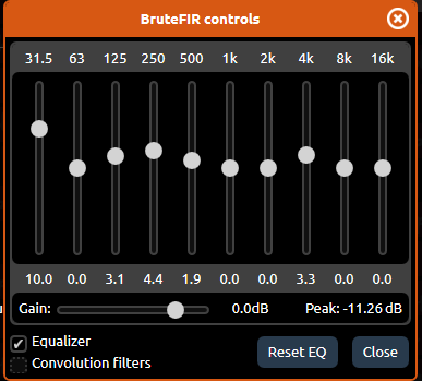

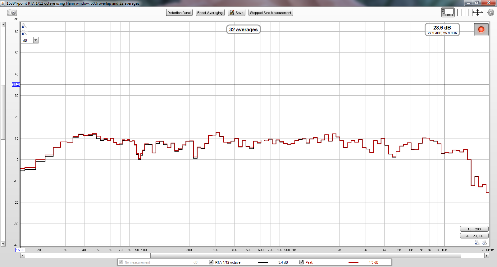

Today's FR and the Daphile Brute FIR panel to get it. I added another 110uf for a total of 475uf cap in the line level xover, shifting the low pass response a bit lower.
I had to run the 18s out of phase with the Liis to get it. Maybe I can turn down the 31.5Hz slider if I buy the Goldwoods...
Read elsewhere here that high Qts on OB can be a matter of taste, and other Qts performers can be accommodated with EQ and get - to some - a preferable sound. Sigh...
