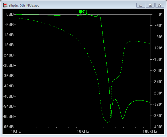

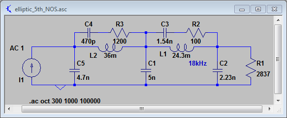

Elliptic filters are the kind that give the steepest slope of filtering for a given filter complexity (or number of inductors) but they've always been a bit tricky to design, especially for DAC purposes which require unequal termination to get the best utilization of DAC output current. I've until now been content with modifying Chebyshev filters to add stop-band zeroes because this process I understood and Chebyshev filters are simpler to design, especially with unequal terminations. Yesterday though was a milestone - I finally figured out a way to coax https://rf-tools.com/lc-filter/ to help design me an elliptic filter with unequal terminations. If you ask it to create an elliptic filter of any type without the input and output impedances being the same it'll tell you that's not supported. As my filters need to be driven by a current source and terminate in an I/V resistor they can't be designed directly with that tool. But after a lot of tweaking I was able to adjust the values in the equally terminated filter to suit a CCS-driven filter. Here is the frequency response of the result :
This is a filter intended to be used NOS and has a very useful amount of suppression of the first image frequency (almost 40dB) which is rather good for a design only needing 2 inductors. The price paid is in the passband ripple (about 1dB p-p) and the phase response which is slightly worse than the modified Chebyshev. As I get to understand the tweaking process better I think I'll be able to create lower passband ripple filters.
The rather strange termination value is the result of tweaking to get the passband as flat as possible. It is pretty close to what's needed to give a 2VRMS output signal direct from a +/-1mA output DAC which was the intent.

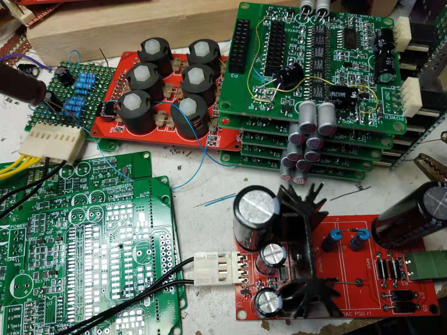

60 DAC stack - not yet balanced though - now playing music. Here the I/V stage (top left, on the perfboard) is only resistors to terminate the filter, no active components. The filter (on the red PCB) I'm using here is a spare DecaDAC 7th order one as it has about the right impedance. It doesn't have the same pin connections though hence the blue wires. Two PSUs are needed - one to power the DACs (7.5V, 600mA) and a negative one to provide headroom to the current output of the DACs (-12V, 150mA). Sonic results are very gratifying

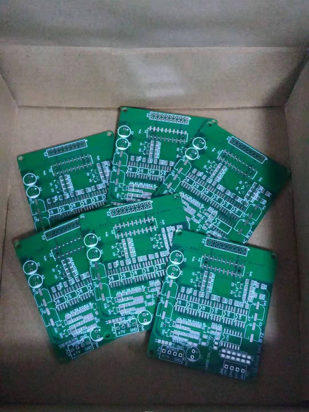

Revised (i.e. simplified) Stack boards came in today. We spent some time trying to get the height of the components down below 7mm as that's the spacing determined by the stacking connectors. The TH polymer caps have been swapped for SMD ones - so far these are the only small SMD caps I consider to have decent measurements, they're pretty much the same as the leaded versions. Whereas the normal SMD caps suck really bad (just try measuring their ESR), so we're sticking with leaded ones for where we don't need super-low impedance. They're laid down on their sides.
