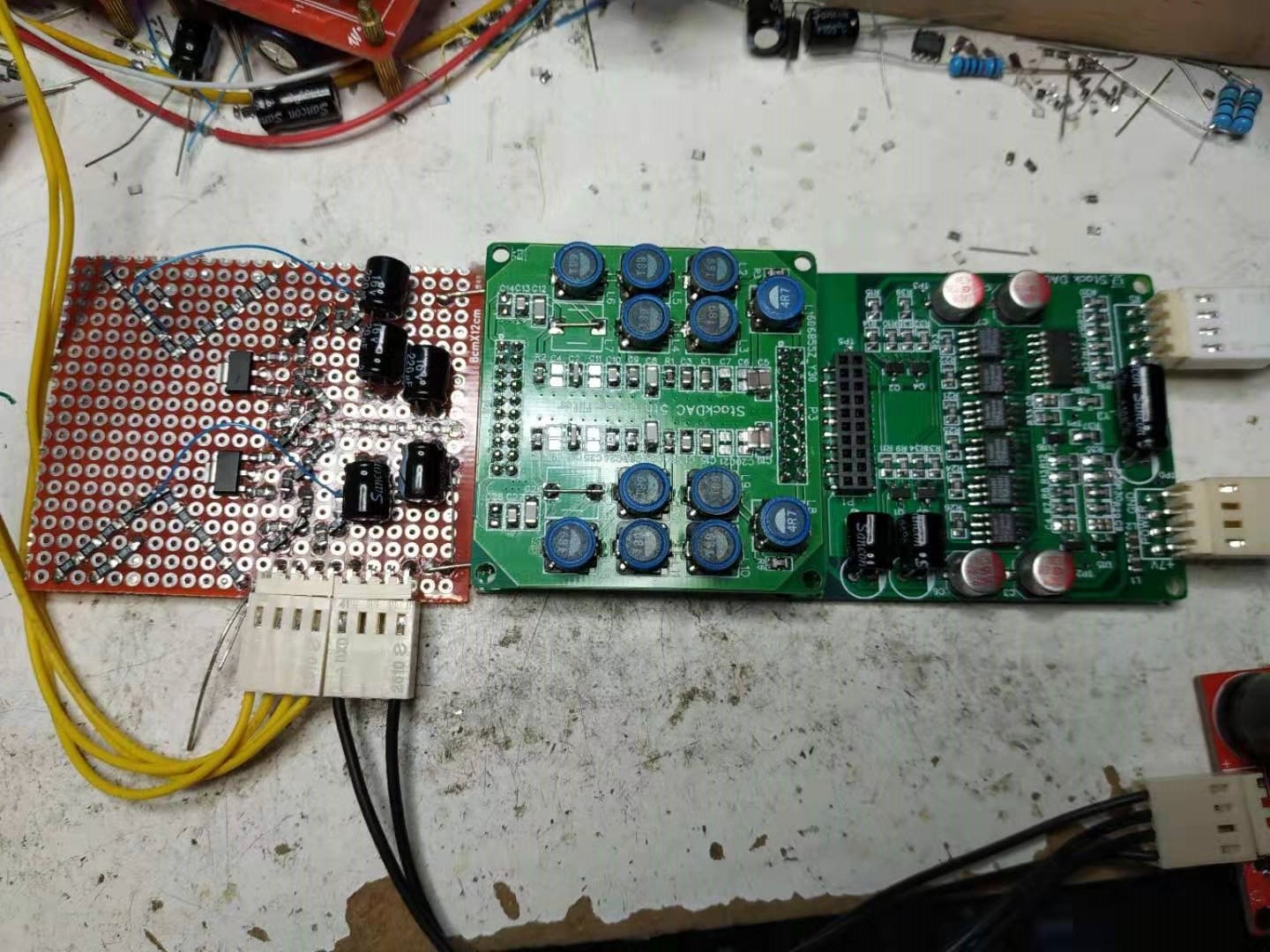

These past few days I've been working on power supplies and the I/V stage. Here is the prototype I/V stage (left-most board) hooked up into a basic implementation of Stack DAC :
The DAC board needs +7V and the I/V board, -12V. So, at present, two power supplies but I am looking into a way of combining those two rails into one board. In the middle is a 5th order elliptic filter board.
Since the DAC boards act as simple current sources (unipolar) the I/V stage can be as simple as just a resistor. But the resistor has to be to the -ve rail and if the output uses GND as a reference then the power supply adds some noise in bridging those two nodes. If you don't need the GND to be the output reference - for example your amp's input is trafo isolated - then you're good to use the -12V as your output 'GND' reference. But for many, GND is needed as output reference so my I/V design creates an ultra-low noise power supply locally using a string of IR LEDs and adds buffers to give a low output impedance even with a single board in the stack.
Last night we did a quick A/B between a single board and two boards (12 DACs vs 24) in the stack. Wifey said the single board sounded 'more messy' which I interpret as 'higher noise'. To my ears the bass improvement is the most noticeable, two boards gives more solidity to the ambient acoustic and seemingly more 'weight' to lower frequencies.

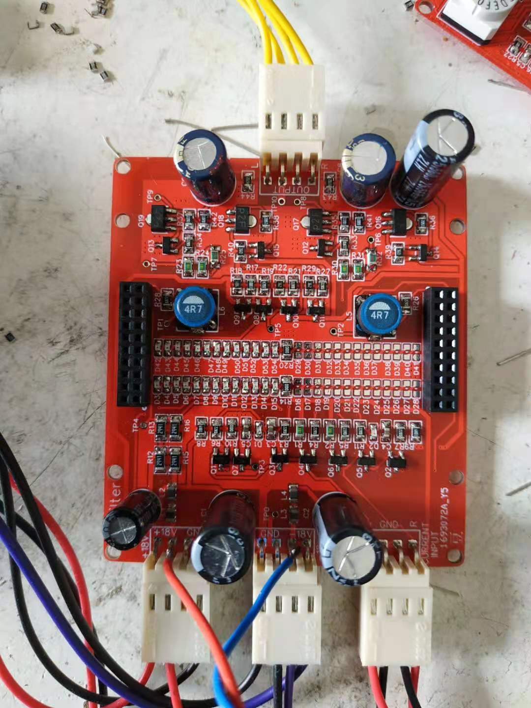

For those who are curious to understand what difference a filter makes, we've made a board which replaces the filter with a couple of 0R resistors so you can compare. The filter in this pic needs pre-selected inductors to get a respectable frequency response but I have a design with lower component sensitivity coming which works with Mouser inductors. Then you can build a filter yourself if you're inclined without worrying too much about inductor tolerances.

Oh, I forgot to mention I upgraded the filters since I took the pic a few posts above. I now have 7th order elliptic - this slightly out-performs my older 7th order filter as seen on DecaDAC since that was quasi-elliptic and didn't manage quite as much stop-band rejection.

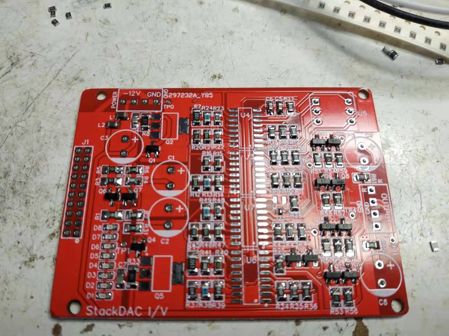

I'm almost done populating the first PCB version of the I/V stage. It has an output level control which is a step removed from a volume control in that adjusting it while music is playing is going to induce a 'clunk' due to a change in DC offset. At least in SE mode, in balanced mode that'll be suppressed, it remains to be seen by how much.
First board is up and running, the only errors on the board I've found so far are footprints for some resistors being too large, easily bodged. I am thinking a few more TPs too, to check that the resistor arrays are all stuffed correctly. Now onto the 2nd board so I can try balanced. The level control does clunk, but not quite as badly as I imagined. In balanced mode I need to find a way to put the two level controls in parallel....
Can this board work as an I/V for Miro's AD1862 DAC?First board is up and running, the only errors on the board I've found so far are footprints for some resistors being too large, easily bodged. I am thinking a few more TPs too, to check that the resistor arrays are all stuffed correctly. Now onto the 2nd board so I can try balanced. The level control does clunk, but not quite as badly as I imagined. In balanced mode I need to find a way to put the two level controls in parallel....
No, this board is designed for DACs outputting lots of current. A single Stack board gives 18mA p-p whereas an AD1862 gives 2mA p-p.

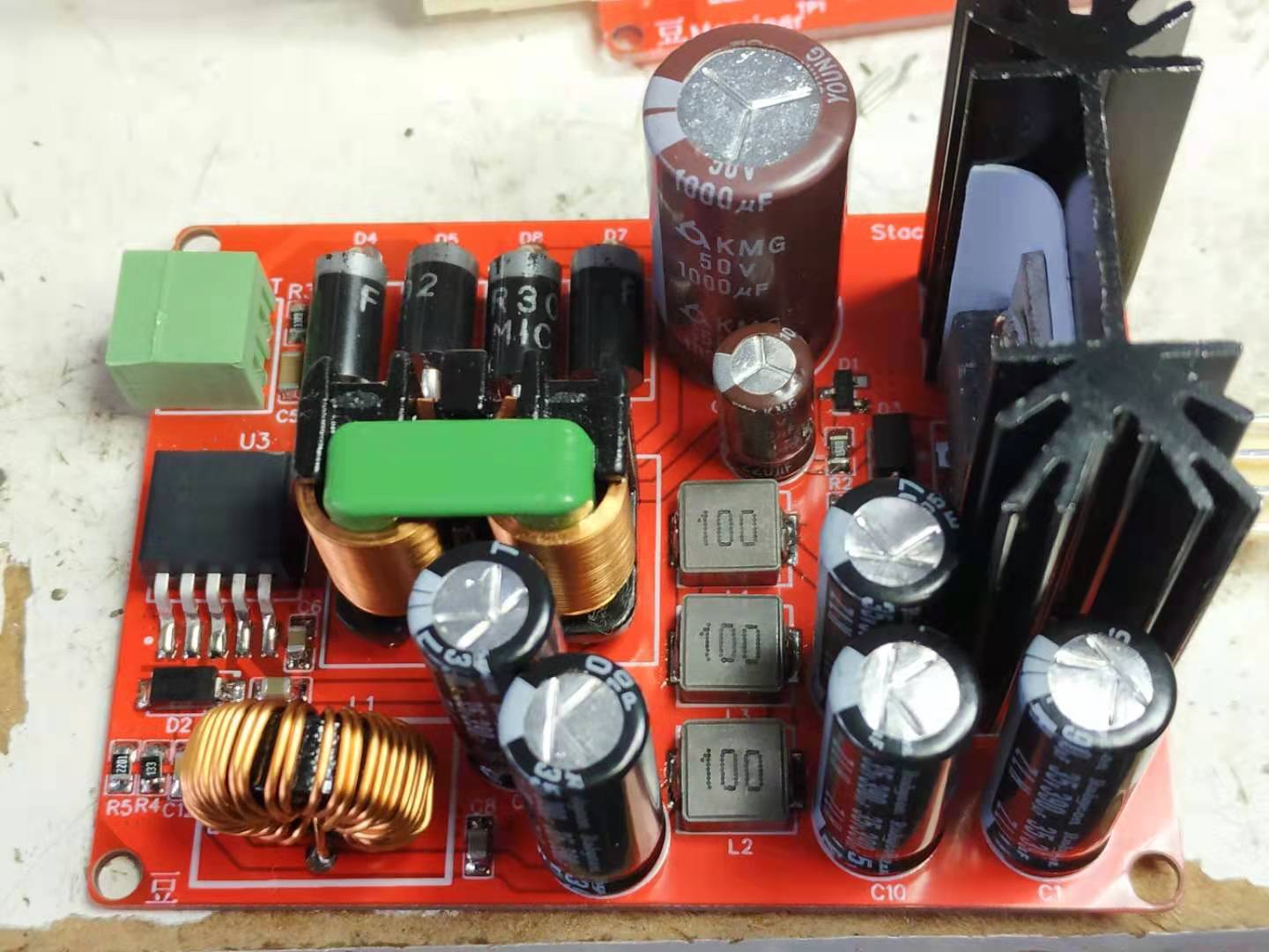

Wifey's been working on the layout for the PSU which can cope with 120 chips (1.2A) - its using a switcher followed by an LC filter and a linear regulator to reduce the output noise. Without the switcher, the heatsink for the regulator would have to be much bigger. You'll need to supply a 20VA mains trafo to feed it with AC. Of course that's only one of the two PSUs required, the -12V one though doesn't have such a heavy current requirement.

The boards have come back and I've built up a couple - here's one of them :
There's a new kind of common-mode choke (that green bar in the middle is its core) which uses flat wire. Definitely a step forward in measured performance compared to the older type with traditional round wire. The three '100' inductors are needed to spread out the heat from the low pass filter - originally I had just a single 33uH inductor but it was getting so hot I figured it should be split into 3. A certain DCR is required as damping for the filter, changing to a lower ESR inductor would introduce unwanted peaking.

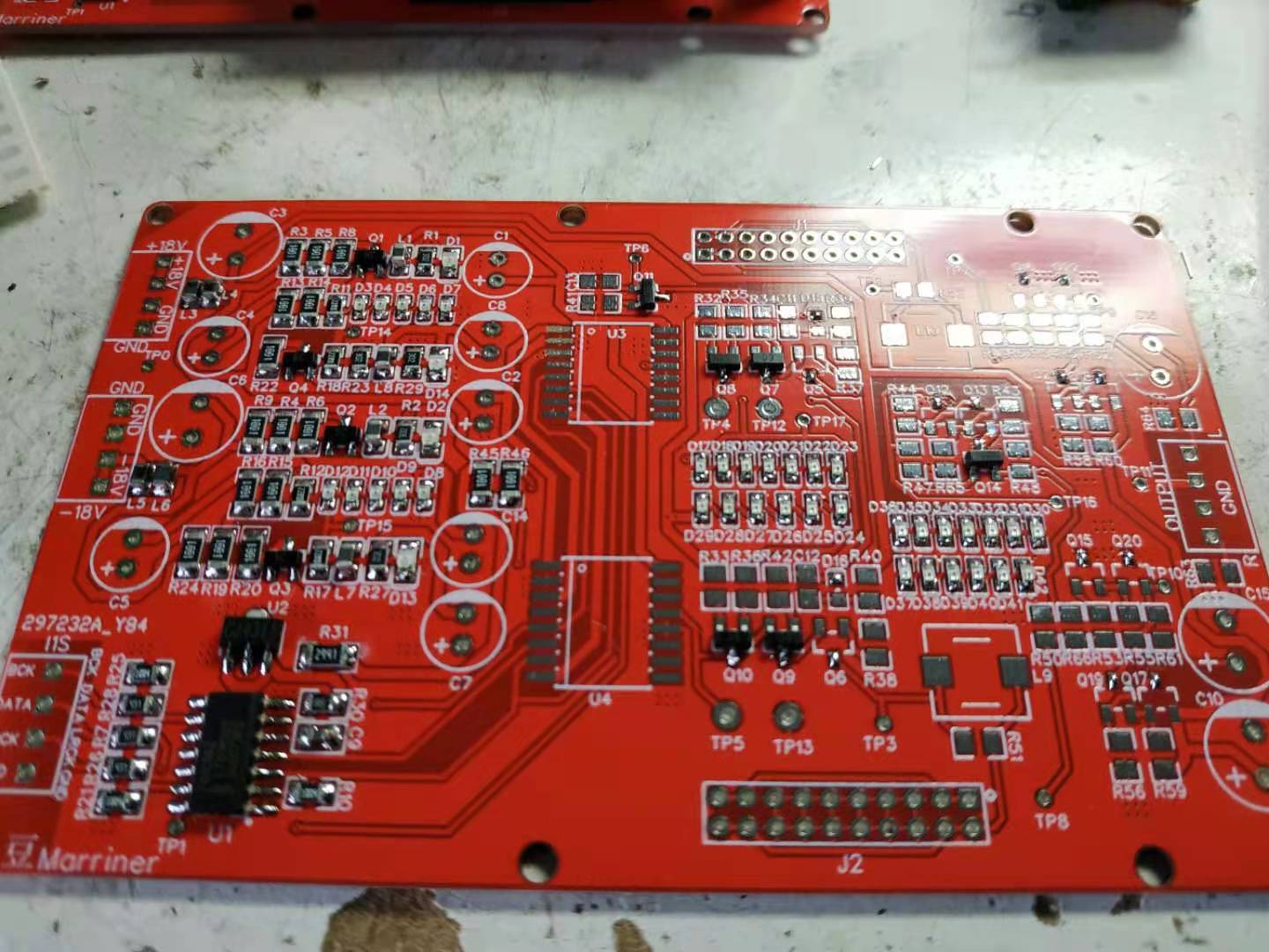

Here's the first prototype stand-alone I/V stage. What this is, is a PCM56 DAC minus the PCM56s (and digital interface). It has a +/-1mA current input to a cascoded common-base (discrete) stage, followed by a passive filter (not fitted for the pic). You can use a wide selection of R2R DACs (AD1862, PCM1702/4 and the like) and have strong attenuation of the images in NOS from the 7th or 9th order LC filter which sits on top. Whilst the filters for this are mechanically compatible with DecaDAC and Celibidache, they're electrically different due to the I/V resistor on this board being a much higher value (1500ohm). For those who love MELFs, there is provision on this PCB to use 1k5 MELFs for I/V duty.
Eagle-eyed viewers will note there are unfilled LED footprints - that's because I plan to try running this at higher supply rails to get even lower noise from the current sources, +/-18V rails is how its set up at present.
