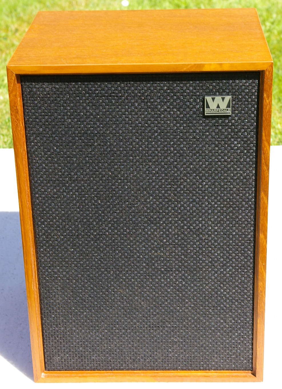

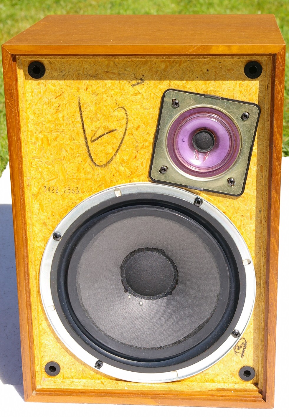

I know you love pics so here's some of my Wharfedale Denton 2 which, as you will know, is the little brother of the Linton 2.
The photos are salient to the thread as I am sure the two siblings share the same components.

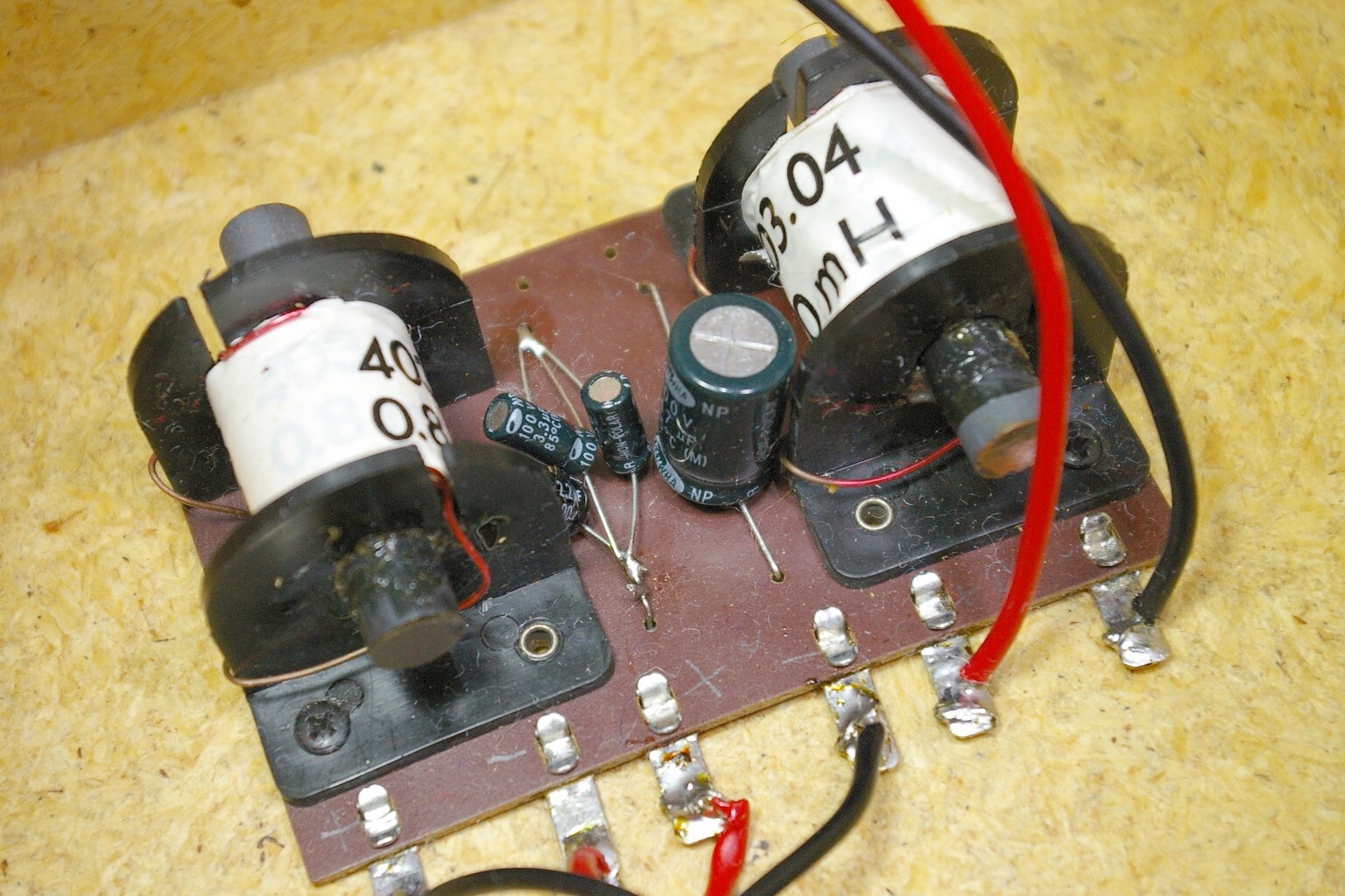

As you can see, I have recapped the crossover with fresh NP electrolytics.
However, recapping did not bring about the improvement in sound that I'd hoped for.
There is a distinct 'honk' in the upper bass that I'd like to cure (extra wadding didn't help).
The crossover is what I call a half section parallel network with 2mH & 50uF in the bass arm and 0.8mH & 16uF in the mid/treble arm. Bass dcr is 5.5 ohm.
Have you any suggestions that would help tame the 'honk'?

Whoops! Glad I opened the Denton 2 up again!
According to the pencil marks I made at the time of recapping, I have re-connected the mid/tweeter with reverse polarity (see the two terminals on the extreme left). This is likely the cause of my problem!
According to my sketch I made of the circuit at the time, the mid/treble should be wired in the same polarity as the bass.
Steve, before I swap the wires over, can you confirm the correct polarity?

That Denton crossover looks plain wrong to me. Previous ones I have seen are 1.25mH/25uf and 10uf/0.8mH at 1.2kHz. We should discuss the options in another thread. The Denton was always bass light to my ears, and I think it could be done differently. Even the Shelton XP2 looked better.

P.S. My refurbished Denton 2s are now singing sweetly at the end of my Rogers Ravensbrook amplifier. I had stupidly reversed the tweeter leads in one of the cabinets! All is now well!

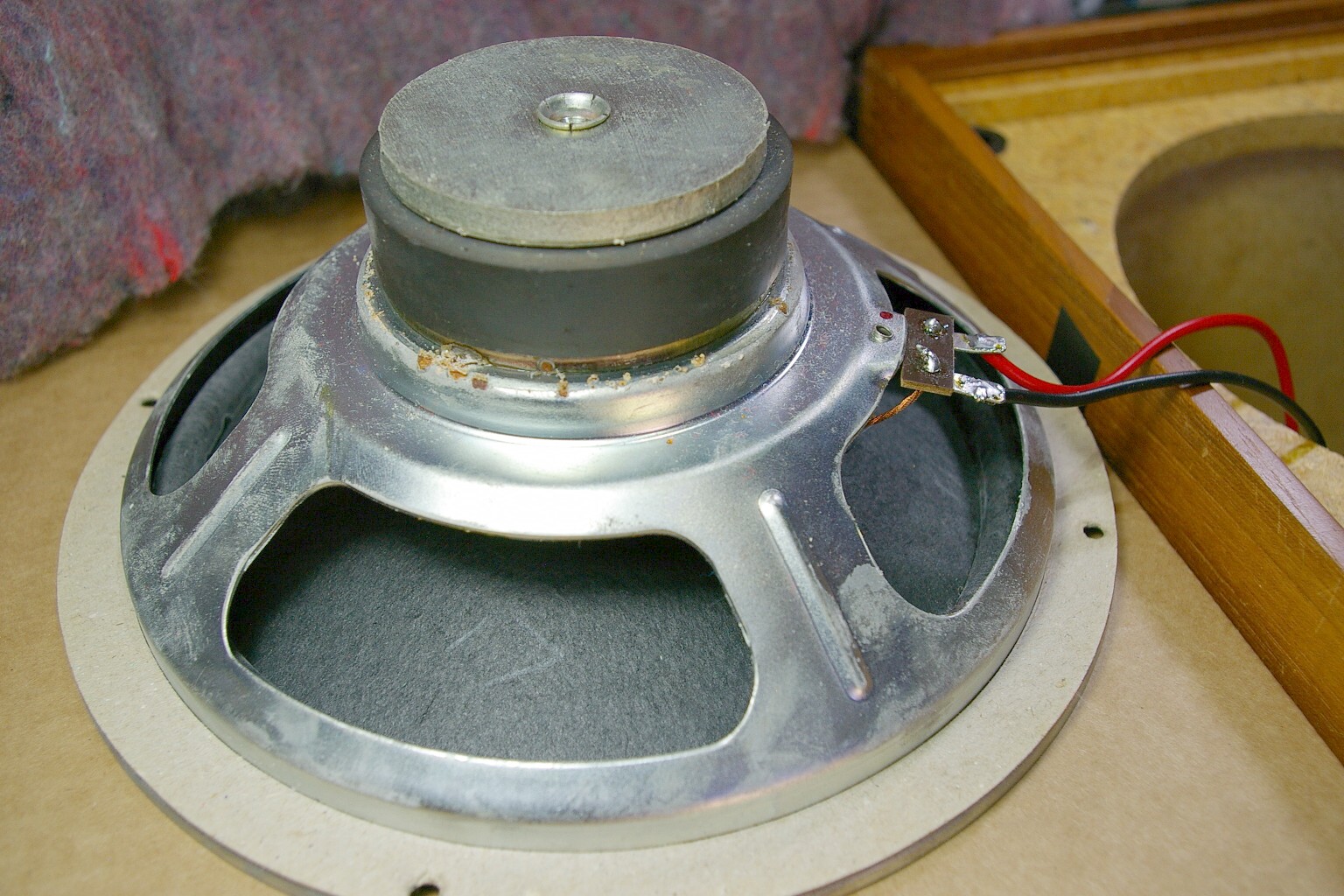

I think I may have digressed from my original post but I do agree with above and have myself dabbled with refurbishing some kef's in the past... (surprise surprise). My Linton 2 angle was more to do with the fact that they are just small enough, wooden and vintage enough (to paraphrase the wife) to be permitted outside of the loft and come downstairs and augment my more 'tasteful looking' set-up. Now as my Lintons were rediscovered hand-me-downs from my late teenage years (i.e. free) and some of the drivers are not in too great a shape there is no requirement to maintain 'authenticity' or keep them as museum pieces... hence the gist of my post was really looking to explore how to marry good modern drivers within a more 'vintage' shell that I can enjoy without shutting myself away from family life!
The Linton 2 woofers seem to be tough as old boots. As with any old driver, rotating 90 degrees can clear some voicecoil sag.

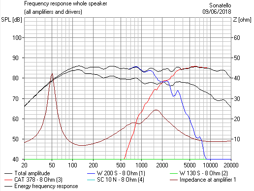

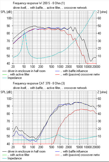

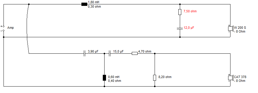

The Morel CAT 378 is one way to go: MOREL CAT 378 Soft Dome Horn Tweeter - AmpsLab
I did some quick and dirty modelling with the limited FRD and ZMA files from Michael Chua. No phase included, so some guesswork. It came out a bit as I expected on a 2kHz crossover.
In practise with the lowish inductance Wharfedale woofer, that 7.5R will probably be 2.2R.
