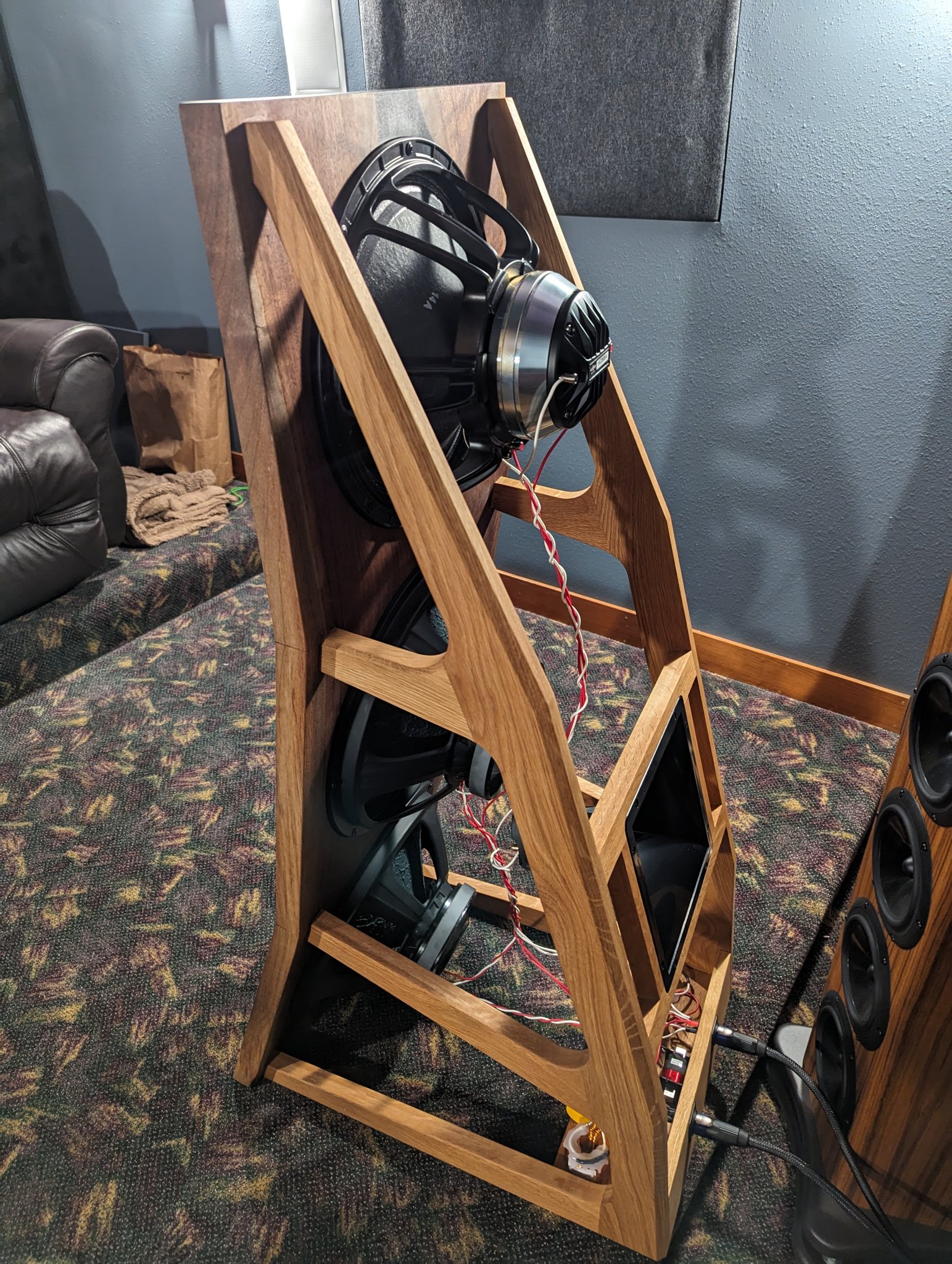

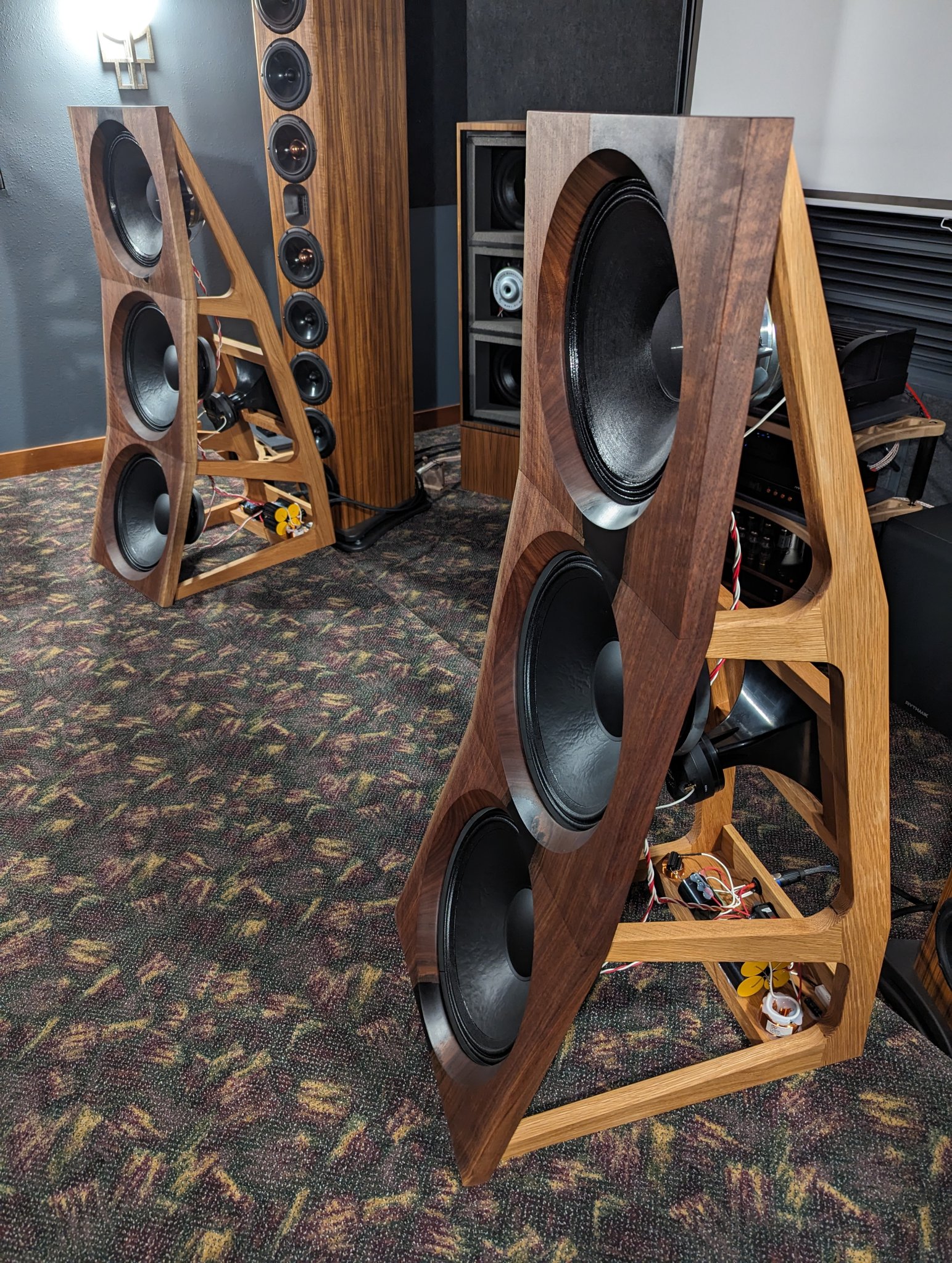

Well I finished my bitches brews last night. Everything is all set up. However, now I'm entering the part of the project where I need some help. I need to set up the MiniDSP with the FIR filters and set it up for bi-amping. I know the original files were for the MiniDSP 2x4HD, and I have the MiniDSP SHD. Have any new files been created since the ones linked in the evo2.org write-up? I'm also using the 14cxn88 instead of the 15cxn88, so I assume I'd have some tweaking to do regardless. I've never done this part before so I could use some direction!
Beautiful work, Subs!! 🥰 I can't wait to hear your thoughts once the DSP is tuned up. I'm currently considering between the NX Treme and a variation of the Bitches Brew – not many have had the chance to experience both in a well-configured setup. This promises to be quite intriguing, and I'm eagerly anticipating your insights. ![cheers :cheers: :cheers:](https://files.diyaudio.com/forums/images/smilies/cheers.gif)

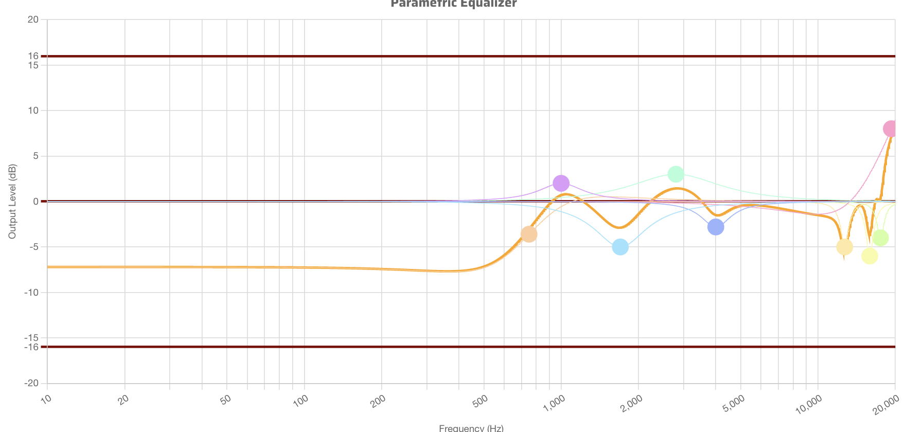

@Subsonic1050 I played with the Bitches Brew crossover a little more and since the 14CXN88 is going to be a little different anyway, you can use my overall approach with whatever differences you encounter. There are nuances I deem important to get good phase, step and impulse response, with as little FIR DSP "cheating" as humanly possible.
(I don't have anything against FIR, but many DSP processors only have 2 FIR channels. You don't get separate FIR for each driver, so you have no choice but to use it sparingly.)

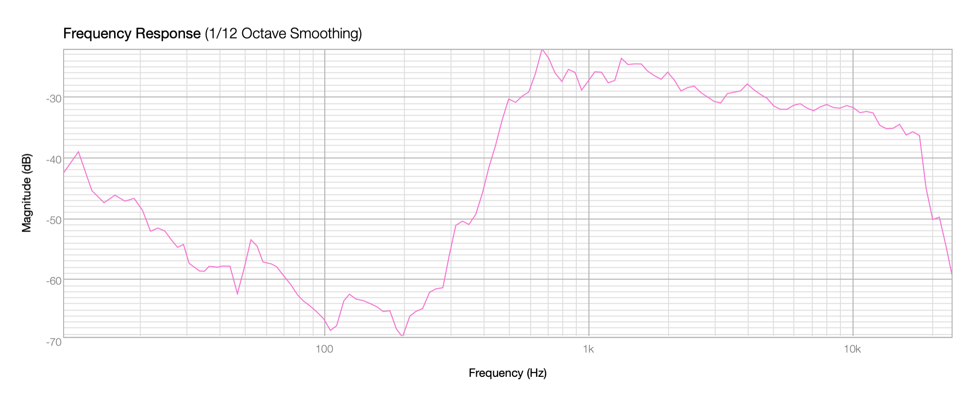

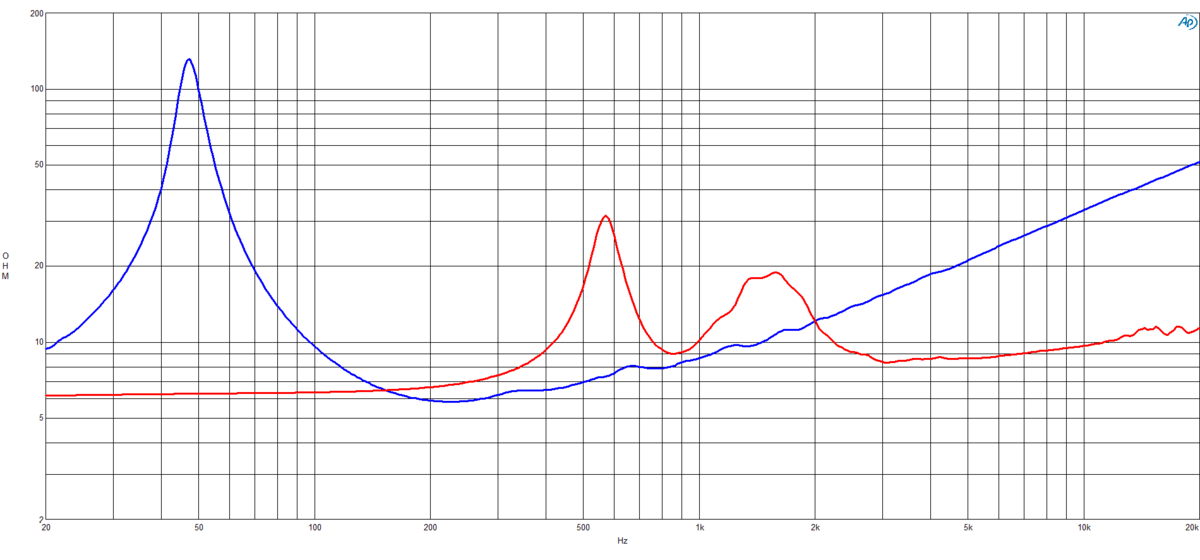

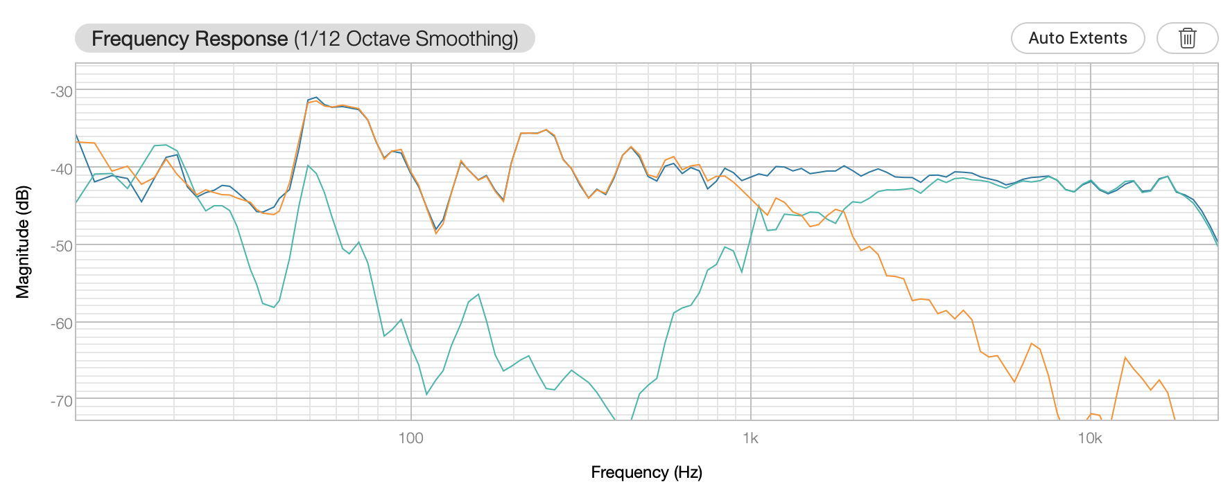

Below: acoustic slopes, microphone about 0.5M away from the 15CXN88. If I had a magic genie I'd have 6dB acoustic slopes both directions, but that's impossible. Instead the woofer is tapering downwards at about 8dB per octave, tweeter is more like 24dB/octave below 800Hz, with a full octave of even-steven overlap from 1-2KHz.
The way I achieved this was to use NO low pass filters on the woofer, only notch and shelf filters. The natural acoustic rolloff of the woofer is the only factor above 3KHz. The 3KHz notch you see below just helps a woofer that extends up to 5KHz roll off nicely above 1KHz:

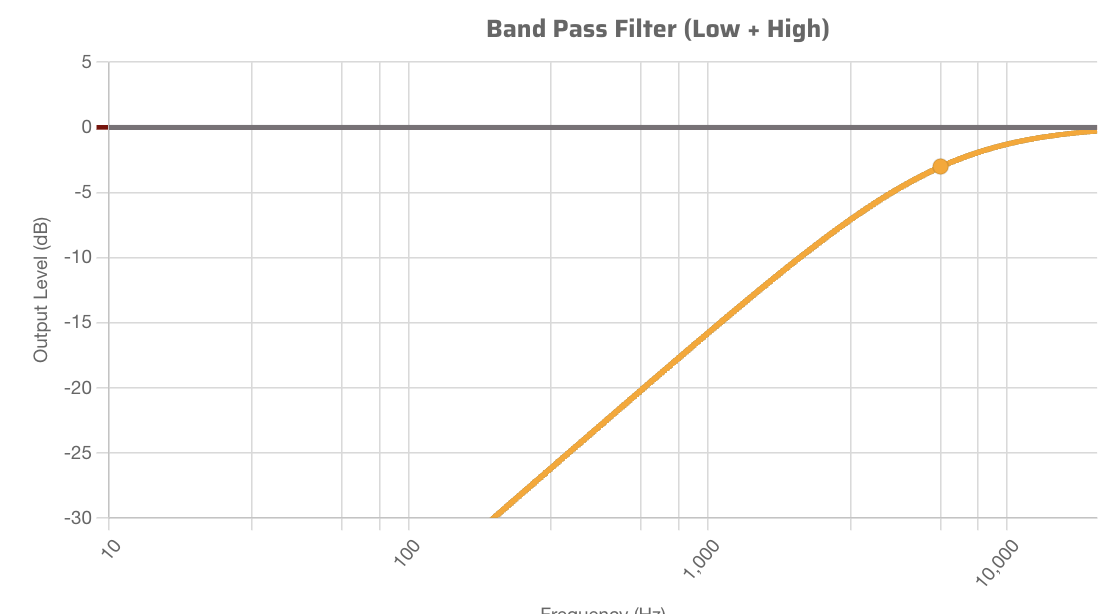

In the tweeter section, I only use a 6dB high pass at 6KHz
...combined with a shelf filter that kicks in below 800Hz, which adds about 8dB more protection:
I'm using the same approach as in the DSP Assisted Reflex which is using a shelf filter instead of a standard high or low pass filter to reduce phase shift. If you look at the impedance curve of the 15CXN88 tweeter section below, you see that at 850Hz the driver can take a pounding, but at the 570Hz lower resonance, it is very vulnerable to excess excursion with very little output, just like a bass reflex:
This is why I want to attenuate below 1KHz, but with as little phase shift as possible. I feel the 6dB filter at 6K combined with 8-10dB of shelving is more than enough protection for a 3" compression driver in a home system. If this was a PA system I'd give up some phase response and use steeper filters.

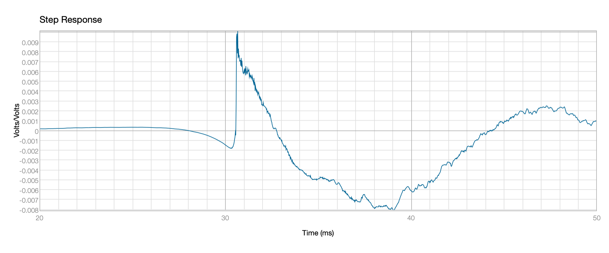

The result is near perfect phase and extremely clean step response:
There is also, as referenced elsewhere, a very simple 360 degree maximum phase FIR filter. It corrects the phase shift of having to wire the mids in reverse polarity. It also adds some fine-grained EQ for the tweeters in the top octave. So if you use DIRAC to do your final phase correction, the DIRAC will have very little work to do.
The approach I use in the Live Edge Dipoles is almost identical. It also means that if you don't use FIR (plus some people might build these using only analog components), you still get a great sounding speaker. I've also attached the latest Flex Eight configuration files for those who are interested.

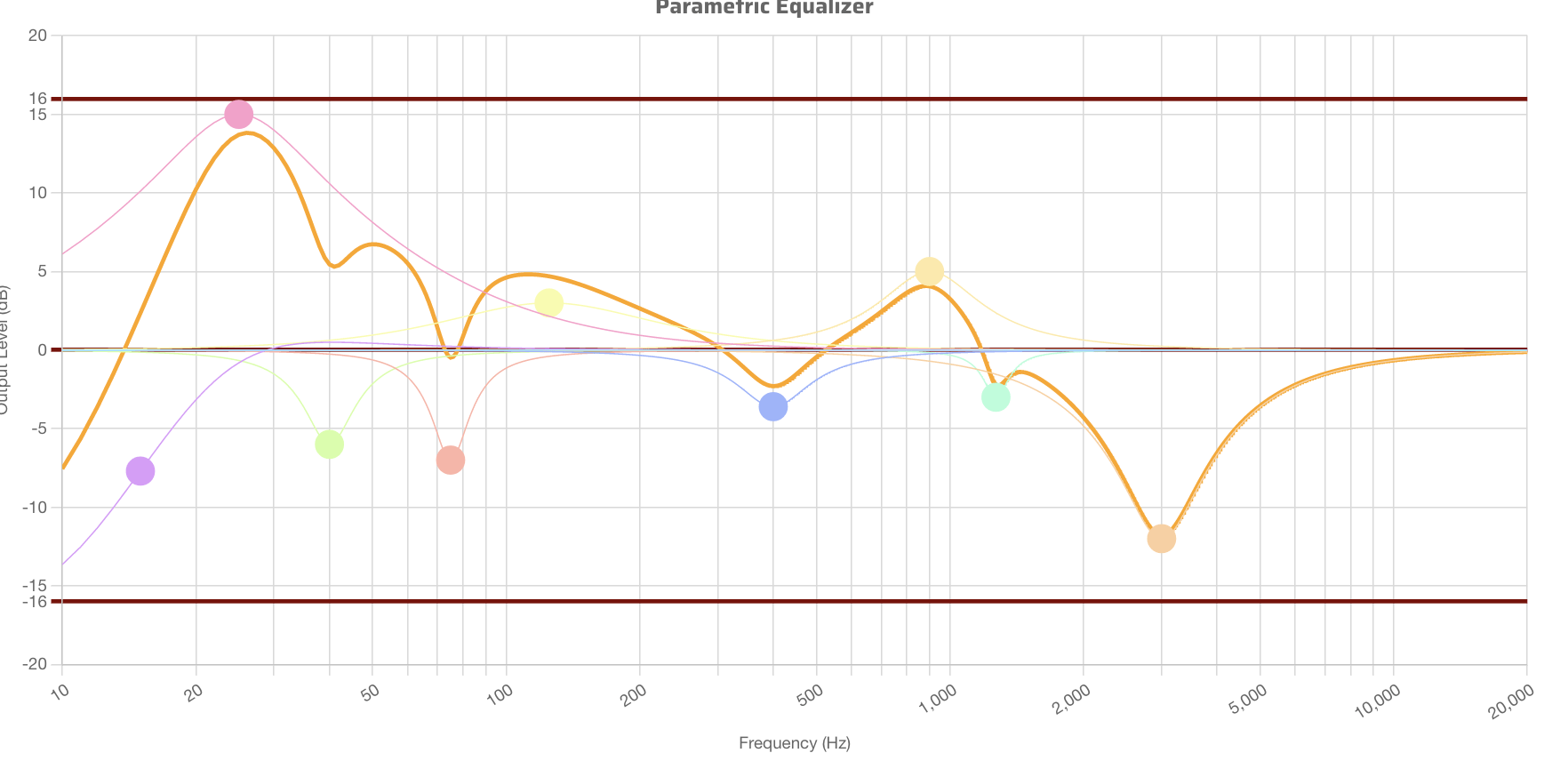

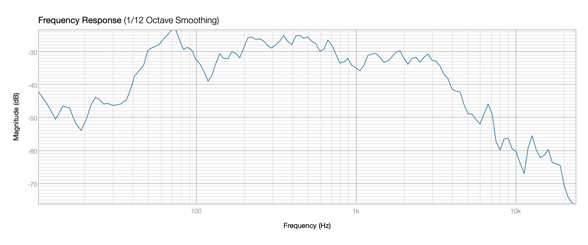

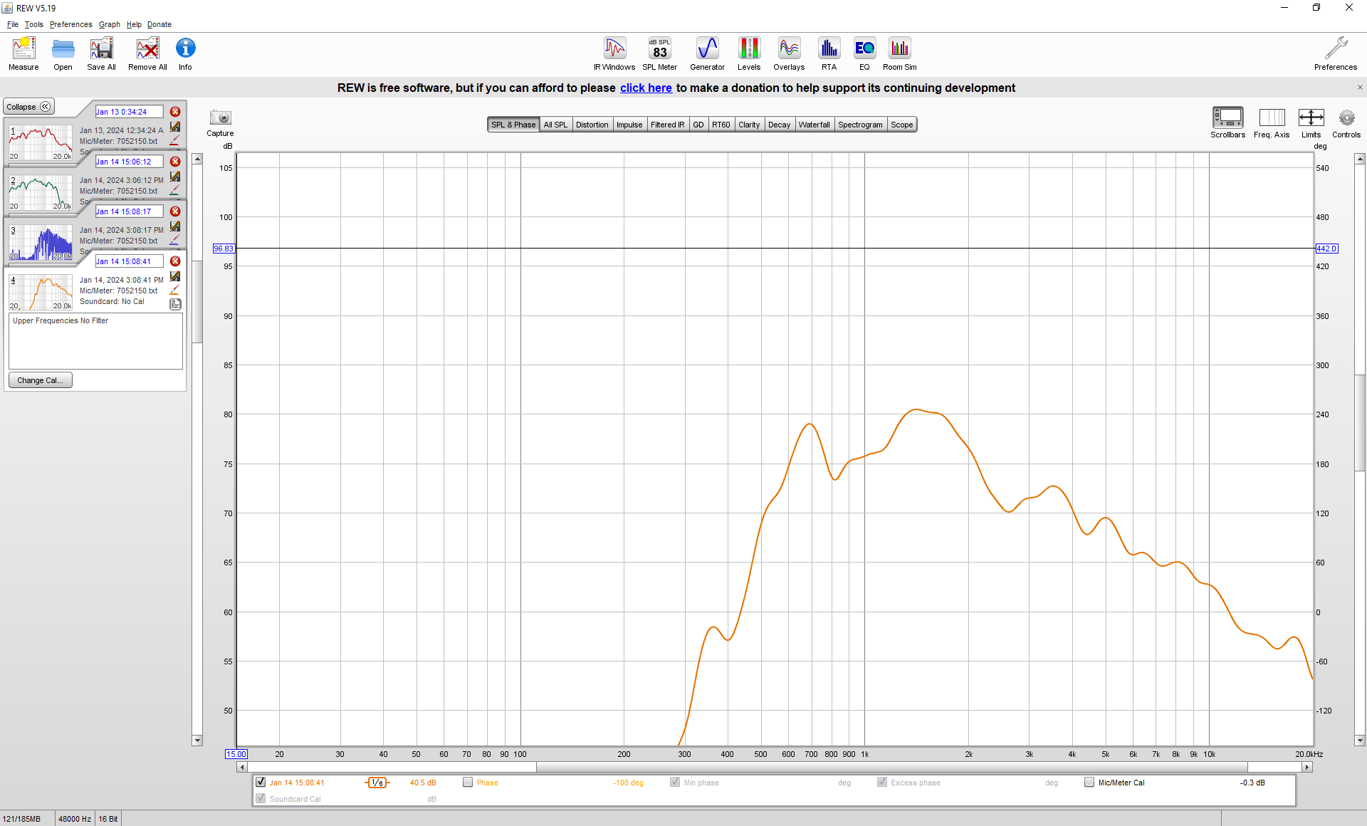

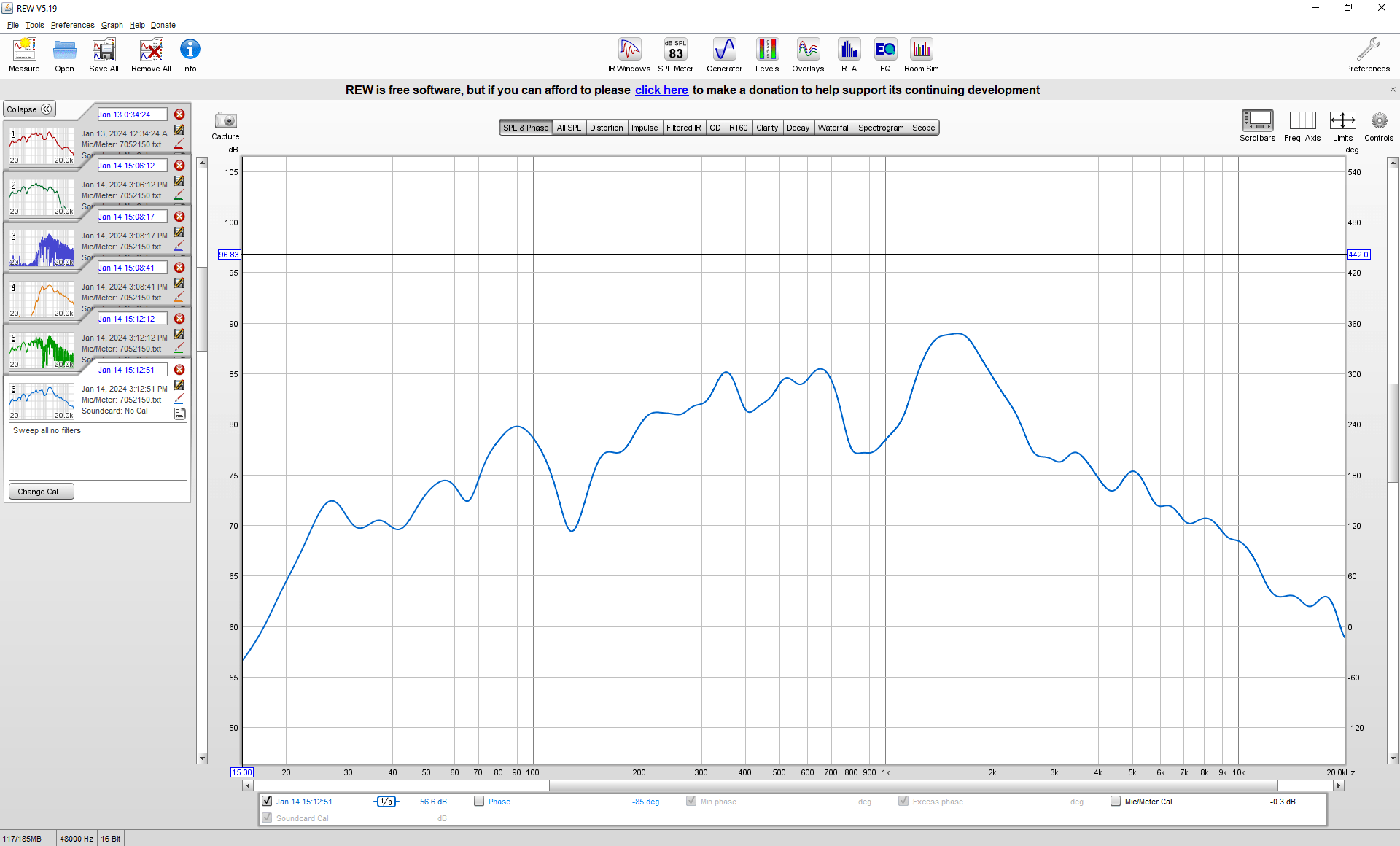

Hi Perry, thanks for all this great information! I'm attaching my frequency sweeps for both the high frequencies only, low frequencies only, and I also put in a combined sweep. The dB levels don't match on the combined sweep with the previous ones because I did do some volume matching between the 2 integrated amps for that one to get the "flattest" response I could - even though it's very not flat.
Your new filter is much appreciated, but when I used your last filter set, which was very similar but with just a few tweaks as far as I can tell the sound was WAY off. It's hard to describe just how wrong it sounded. It sounded like the speakers were under water. The sound without any filters is 100x better than with the filters applied. That's why I was hoping to run a frequency sweep WITH the filters on, so I can see what in the world it's doing. It must be wild. As you can see from the frequency sweeps I sent, without further correction these speakers are very far from a flat response - and it must be far worse when I apply the filters you are using. Do my sweeps look anything like yours without correction?
Managing these issues in either case is an interesting topic, however as a blanket statement this would have several flaws.Only in a coax is it good (and not bad) to have a 1+ octave overlap between woofer and tweeter, because in a constant directivity coax there are no off-axis lobing problems. So the coax configuration lends itself to a shallow slope crossover with no penalties.

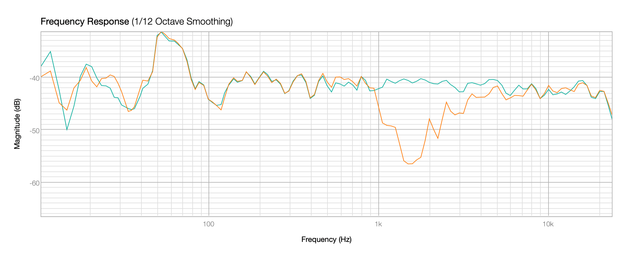

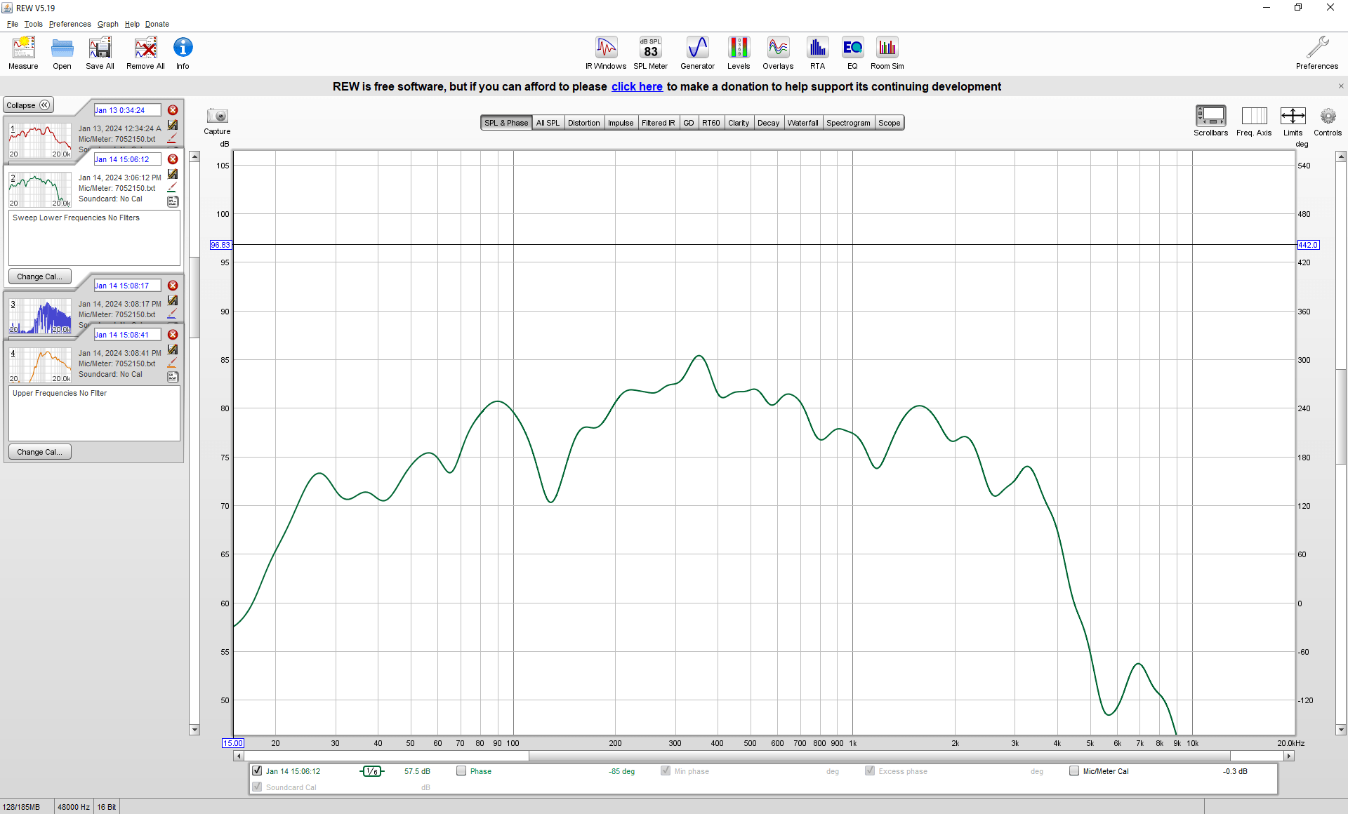

Here are the raw, in-room curves (including any reflections) with no EQ:Hi Perry, thanks for all this great information! I'm attaching my frequency sweeps for both the high frequencies only, low frequencies only, and I also put in a combined sweep. The dB levels don't match on the combined sweep with the previous ones because I did do some volume matching between the 2 integrated amps for that one to get the "flattest" response I could - even though it's very not flat.
LF
Below, HF:
I'm puzzled that your tweeters drop from 80dB at 1KHz to 58dB at 15KHz. Mine only drop 10-15dB, yours more than 20dB.
Your LF seems somewhere in the ballpark of what I would expect.
Double check the polarity, the mids should be reverse polarity of the subs.
Double check the polarity of which drivers? When you say the mids should be the reverse polarity of the subs - I'm thinking you're talking about the 14" coax driver should be the reverse of the 2 15" woofers. But what would that have to do with the drop in the high frequency range?
