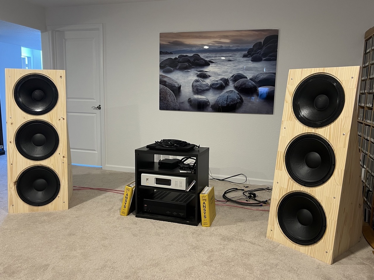

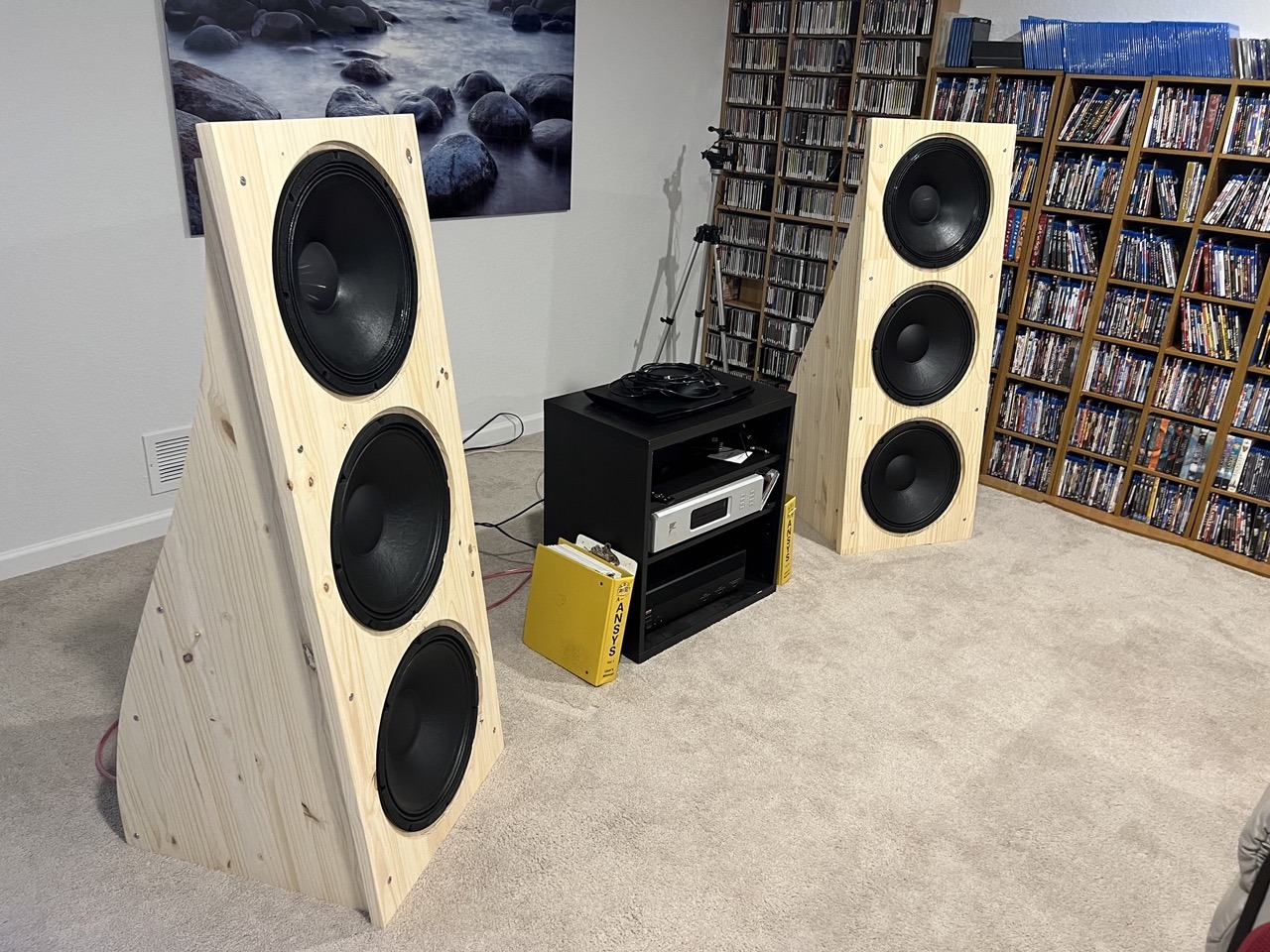

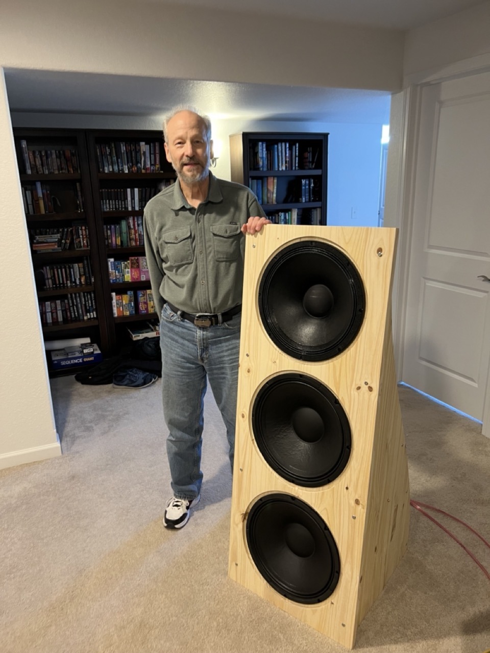

Today I stopped by @jrhilgers John Hilgers' place and listened to his incarnation of the Bitches Brews. Reinhard Metz, who's written articles for AudioXpress and has built speakers, tube amps, solid state amps AND an airplane, came along, and we had a great time. John, nice tube amps you built and excellent job executing the design!
We also REALLY enjoyed John's Martin-Logan electrostatic Home Theater setup.
