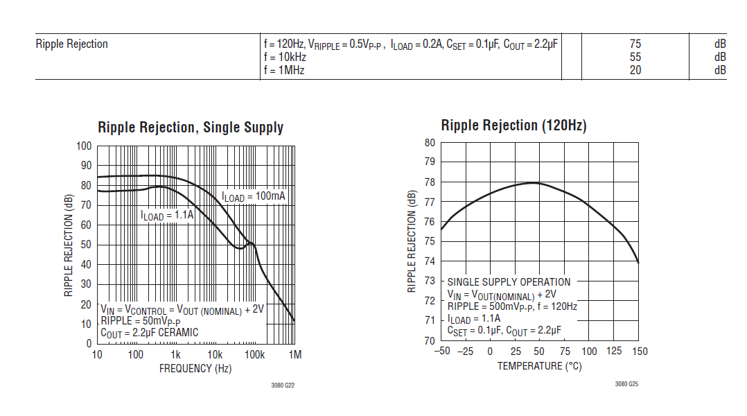

I only see 75 dB ripple rejection in the datasheet you linked ... ???I suggest looking at the LT3080. I ... have found LT's claims of 120 dB ripple rejection to hold up in real life!

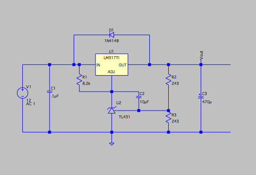

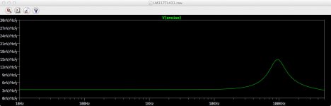

I'm interested in this thread as I have a modified 1A Velleman PSU based on the LM317 which I am looking to upgrade as a little learning project. I use it to power an SSD in my music server from regulated 12V input. The PSU currently has a 10uF cap on the adjustment pin as shown in the LM317 data sheet (although I note it doesn't have the diode to discharge this cap).
I take it that using a TL431 will yield a better result than the 10uF cap configuration? Am I right to summarise that the conclusion is that shifting the TL431 cathode resistor (R3 in the original post) to the output of the LM317 increases complexity significantly because of the required compensation and so I should stick to the input configuration? Is D6 necessary? Lastly, is there any benefit to using an Onsemi NCP431 which I believe is an upgrade to the TL431? (I have searched for TL431 with ED suffix to no avail so far having found just A and B versions.)

One way to analyze this is to plot impedance vs. frequency, for a TL431 and also for a 10uF capacitor, on the same graph. If one of the two curves is lower than the other at all frequencies, it's a very easy decision. If not, (i.e. if the curves cross each other), then there's probably room for subjective human judgment to decide "which of these do I like best"?I take it that using a TL431 will yield a better result than the 10uF cap configuration?

I would stick with the input version, much simpler and safer to use.
But put a cap between Cathode and Vref, 1-10uF is a good value, it helps with noise, especially low frequency noise.
TL431ED is the model I have used in my simulation, it is an improved version that follows the TI TL431 datasheet better than other available models.
You could go with the Exar SPX2431AM, it is similar to the TL431 but with significantly reduced noise compared to the standard TL431
Standard TL431 is around 120nV/hZ at 1K and the SPX2431AM is 40nV/hZ at 1K.
The NCP431 looks to have around 600nV/hZ at 1K according to the dataheet, that is downright terrible.
D6 is there in case you short the input to the regulator, if that happens the output capacitor will discharge into to output of the regulator, potentially destroying it.
But put a cap between Cathode and Vref, 1-10uF is a good value....

Thanks. By chance have you modeled this versus the LM317 + 10uF cap to ground config? (A cheating response to Mark's comment else I would to wait to get home to London, find a model for the TL431 and try out my Spice modeling again.)
Just to clarify the 2nd point (I'm a newbie to this stuff) you mean a cap between cathode and the LM317 adj pin, right?

I meant a cap between Tl431 cathode and Tl431 Vref.

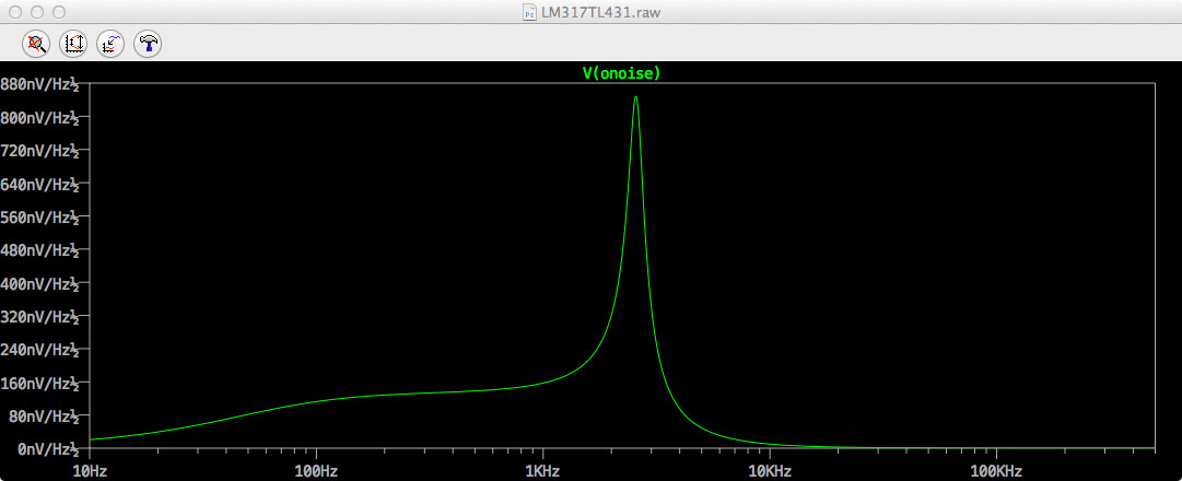

Coming back to this…Have I misunderstood you re the above as I am getting some not-so-great noise results. It would be better without C2. (Targeting 5V.) This is using the model for TL431 recommended by Helmut Sennewald on the LTspice forums.

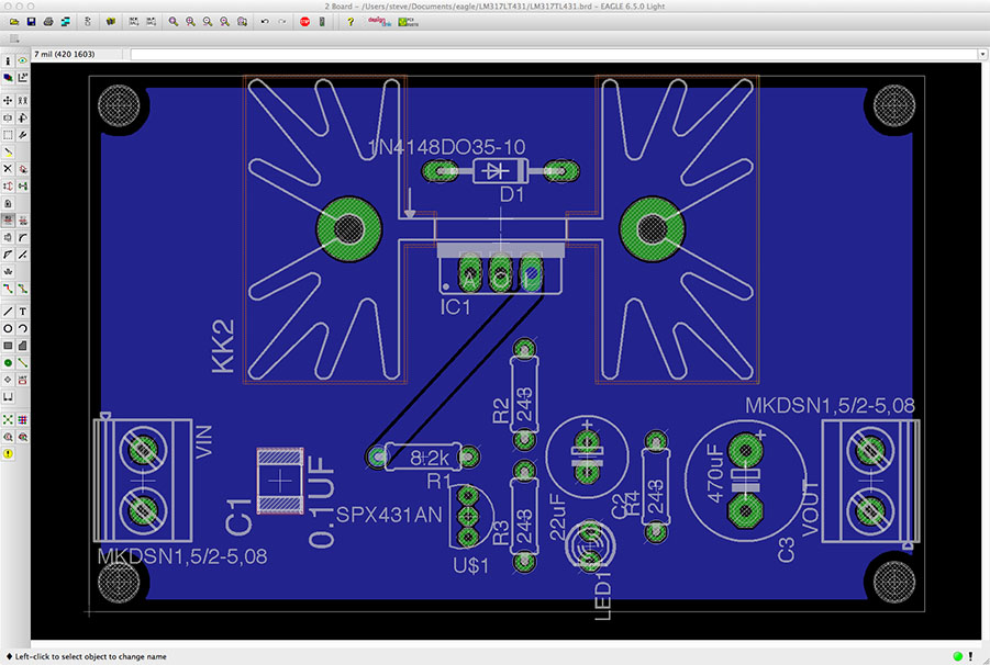

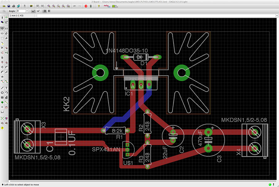

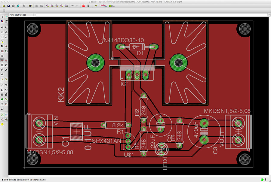

One thing I find puzzling is that I thought a ground or copper pour was meant to "blanket connect" all points connected to ground into the ground pour. But it seems the GND connected traces remain as such.
Hi. I named the pour but I didn't name any traces…but when I click on the ground trace running along the bottom it seems to already be named GND (consistent with the pour)
EDIT: okay I see now that I thought I had named the pours but I hadn't. Now fixed. Thanks!!
