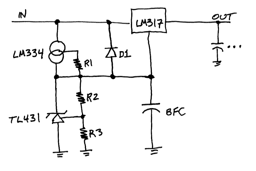

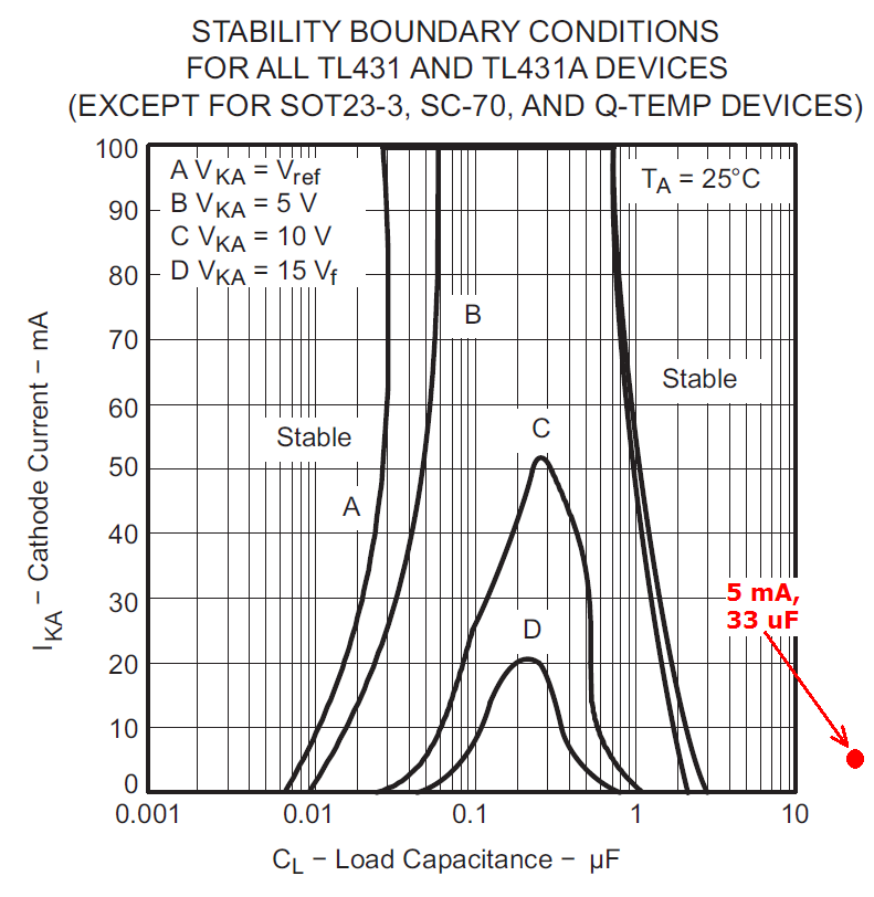

For those who don't want to worry about the stability of cascaded amplifiers, the input-biased variant may be pleasing. Especially in applications like a 12VDC input, 5VDC output regulator which powers a solid state disk. The 12VDC input won't have nearly as much ripple as the standard (trafo + rectifier + capacitor).
BFC is a Large Capacitor, at least 33uF {see red dot}. It keeps the TL431 delightfully stable, it shunts noise to ground, and it keeps the impedance low at the ADJ pin, even at high frequencies.
R1 is about 8.2 ohms, which sets the LM334 current source IC to deliver 8 milliamps.
The (R2/R3) ratio is chosen to be 0.50; therefore the TL431 cathode voltage is ((1 + 0.5) x 2.50) = 3.75 volts. This is applied to the LM317's ADJ pin, producing an output of 5.00 volts. {R2 = 1K2 and R3 = 2K4 would be reasonable choices}
D1 protects the LM317 if the input gets shorted to ground. When this happens, BFC is discharged through D1 instead of through the sensitive ADJ circuitry inside the LM317. I would select a low capacitance diode (based on datasheet MAX Cj@0V, not datasheet typical) like the 1N4149 in this position.
