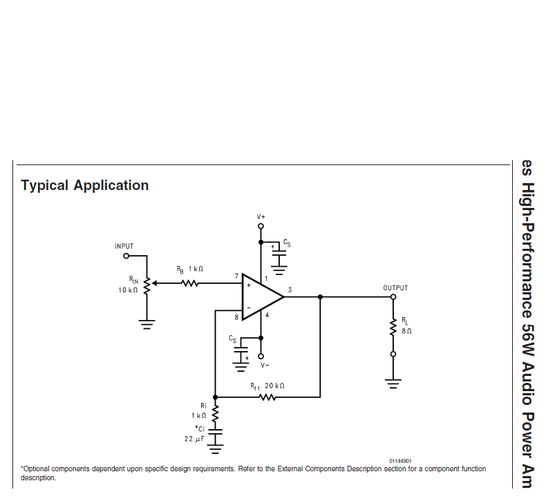

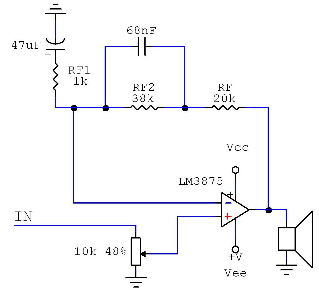

LM3875 gainclone too much treble

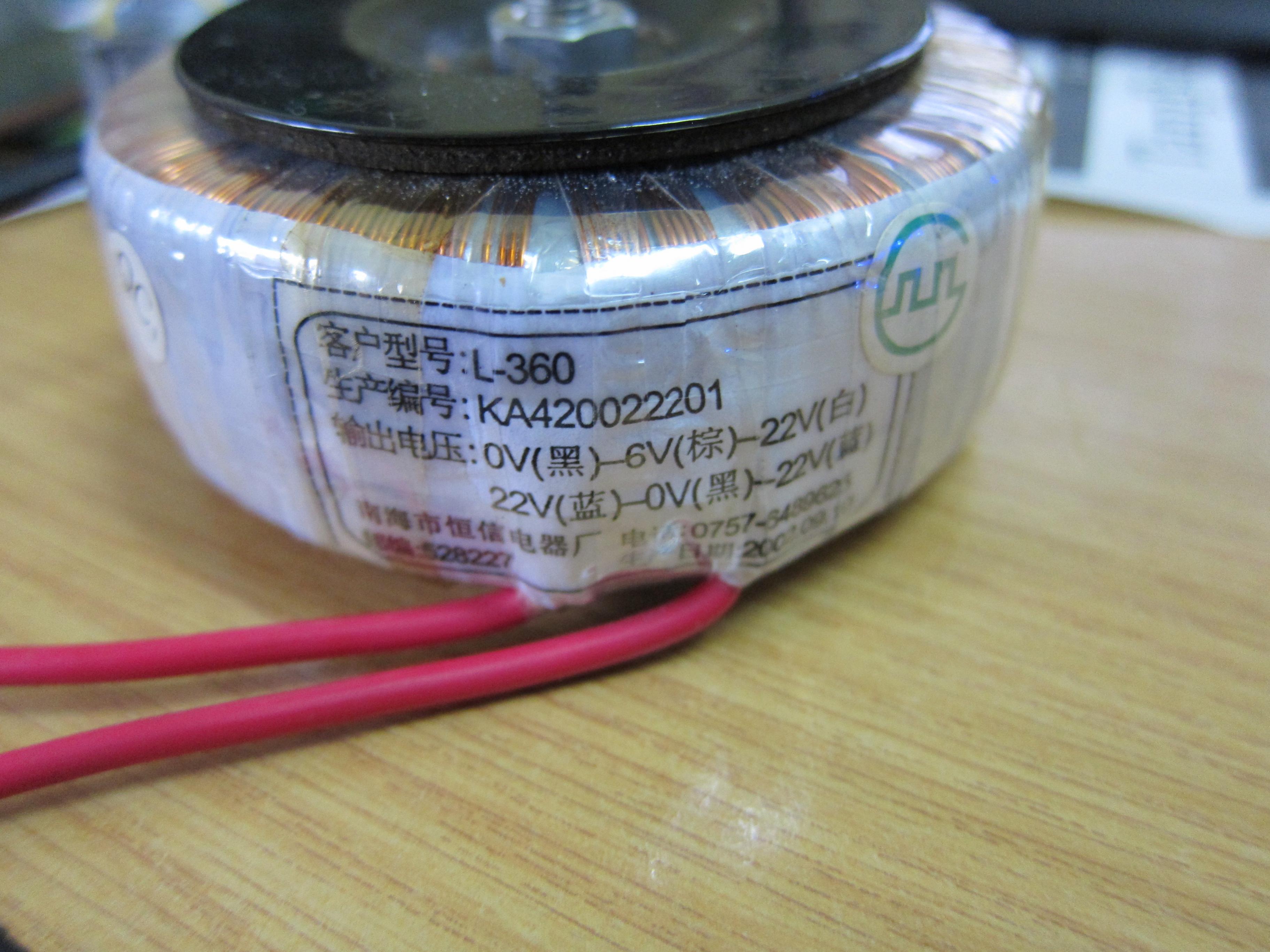

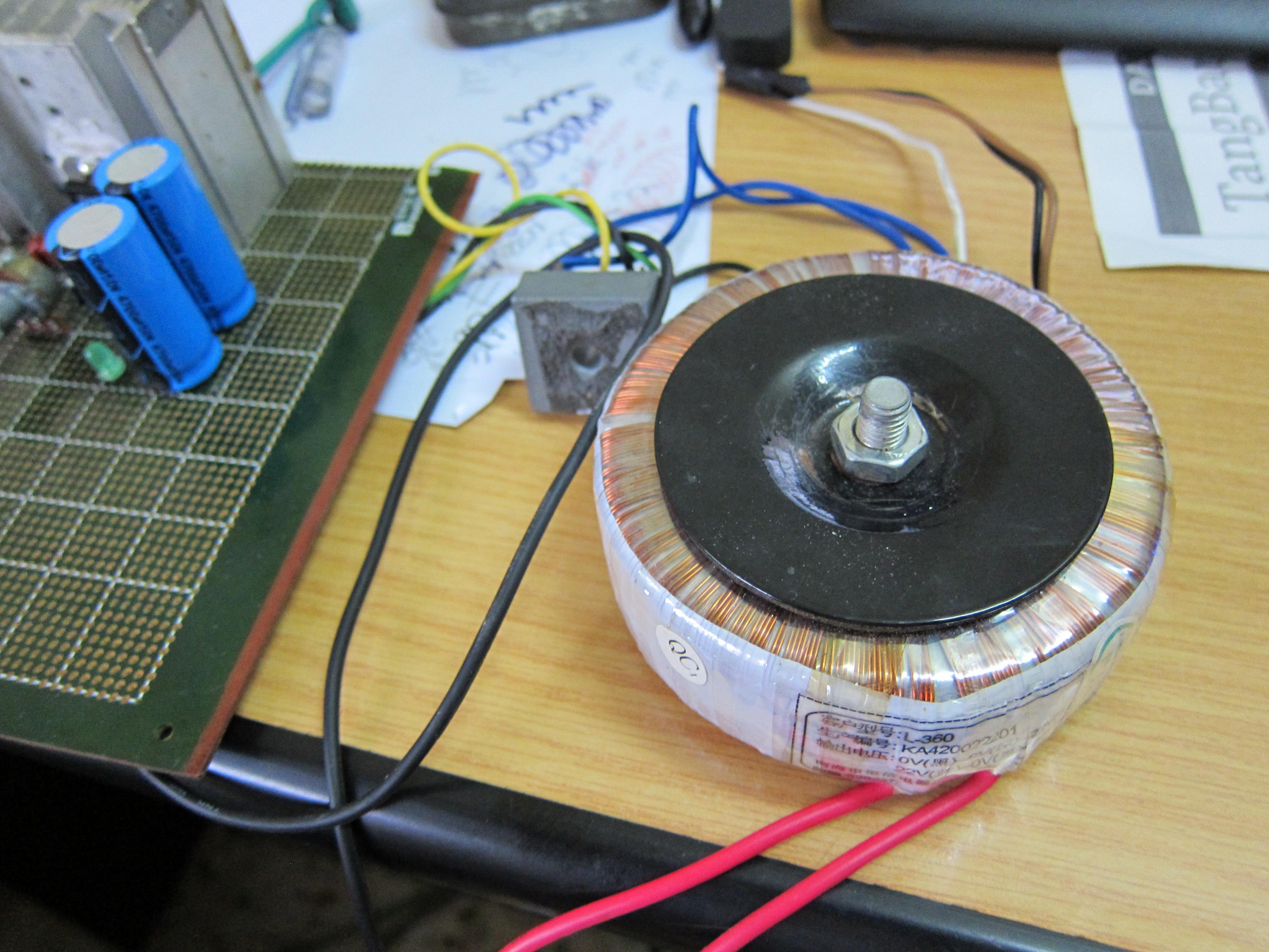

Power supply i am just using 4700uf for the positive and negative rail ... for the transformer i used a large toroid but i didnt know the VA rating because it didnt state on the transformer 😀(it was actually salvaged from a broken amplifier i have)

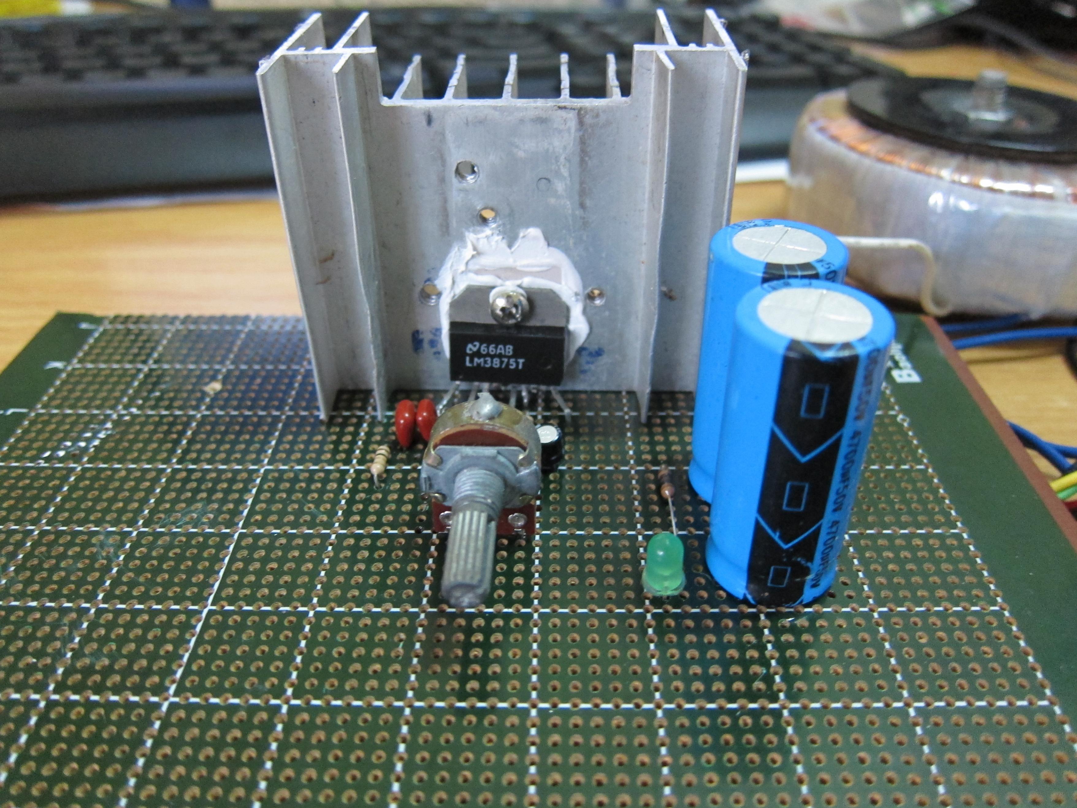

BTW here have some photos of the completed and working LM3875 amplifier i built
To get awesome bass I would recommend 20,000uf per rail. Also use a bridge rectifier with a high current rating 25A or 35A from my experience higher current rectifiers sound much better than lower ones. This is probably due to lower switching resistance. Also what is the power supply voltage? You didn't say but make sure it falls in the safe range.
