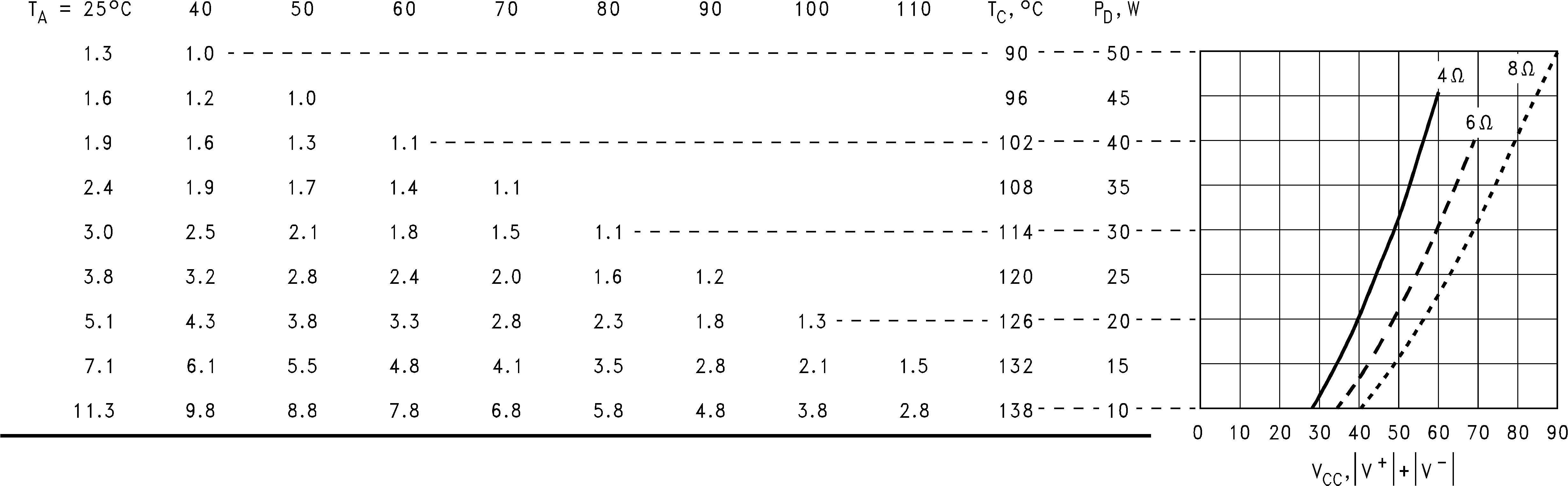

Further more, Why no one looks at the table shown ,which calculates the heatsink size.The minimum heatsink temperature preconized by the manufacturer at which it can still deploy it's maximum output power,does not start at 50°C nor 60°C( std. max.) but 90°C MIN.That is the coldest object you must mount this IC on, is a boiler, and can make it singing 80W.

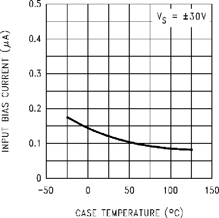

Are you sure ur not reading the meaning of the temperature graphs and descriptions backwards?
So the chip will produce those temperatures when pushed to a certain watt output?
I simply just do not believe in electronics running too hot. I'll stick with my big heatsinks and optional cooling fans.

I think you misunderstand MTBF and FIT data and how it is derived.
The accelerated life test at 125C is performed to allow a reasonable sample size (15838)to produce usable data in an acceptable amount of time (1000 Hrs).
The failure rate at elevated temperature is used to extrapolate the MTBF and FIT at 55C.
This is the data presented for the component, not the MTBF at 125C.
Furthermore, since there were no failures during the 1000 hour life test, they only have a 60% confidence level.
Testing for longer than 1000 hours might produce different MTBF data.
