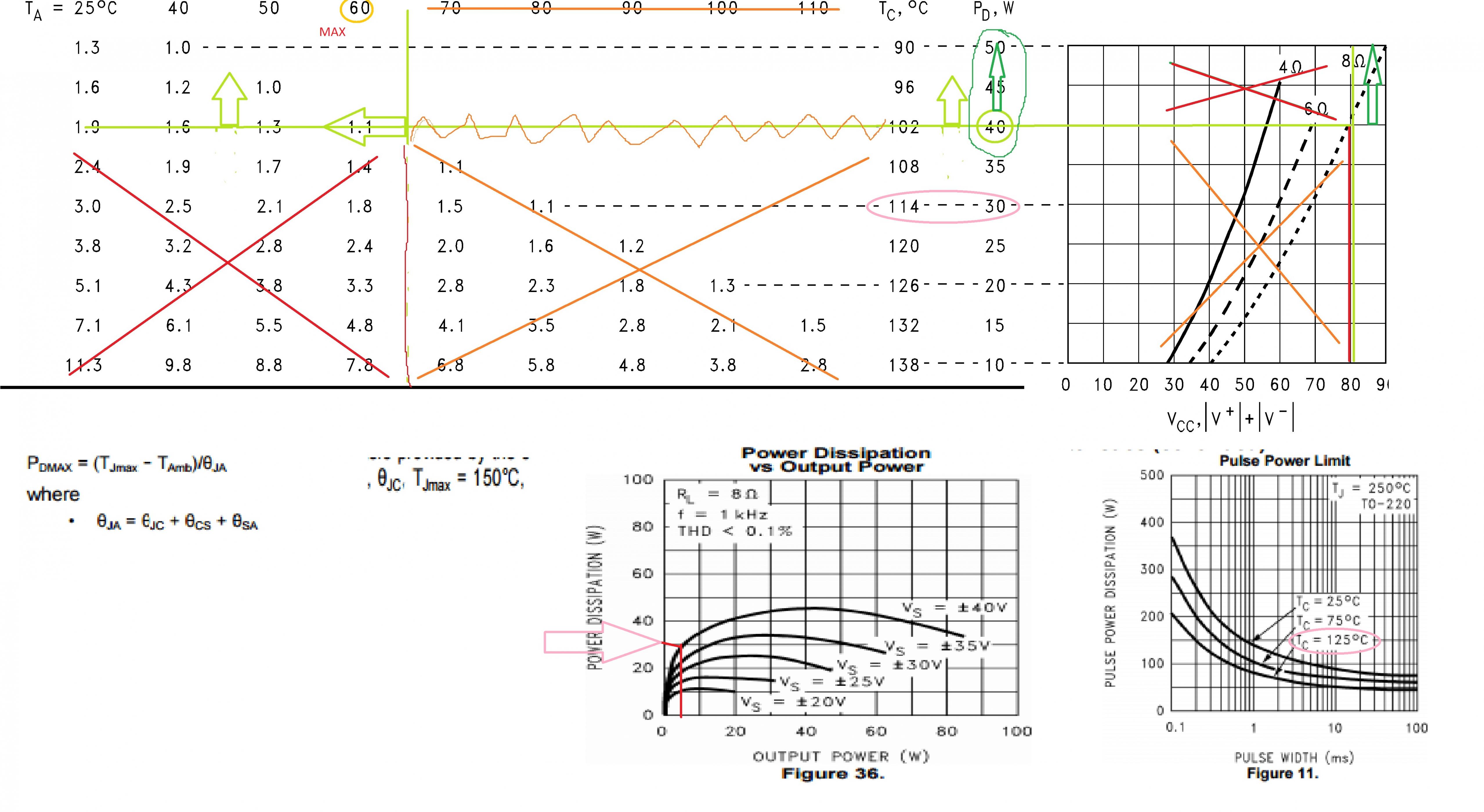

"Further more, Why no one looks at the table shown ,which calculates the heatsink size.The minimum heatsink temperature preconized by the manufacturer at which it can still deploy it's maximum output power,does not start at 50°C nor 60°C( std. max.) but 90°C MIN"
Nope.
And look at the total power supply voltage TI recomends at high temps. At the highest temps it is tot 30 volts. That is +- 15 volts.
And that is with a small heatsink at 25 degr ambient temp or a big(ich) heatsink at 90 degrees ambient.
The table also says 90 degr ambient and biggest possible heatsink for the package 1.2. The total dissipated power from the amp is MAX 25 watts. That is 25 x 1.5 watts max to the speakers before spike hits in. And before that the thd will rise to higher than spec levels.

And of cource
DMAX = (TJmax − TAmb)/θJA
TJmax is 150 degr
So PDMAX goes down with rising TAmb
PDMAX goes down with smaller heatsink as θJA gets larger
So maybe rising TAmb to more than 150 degrees will make it absorb heat? Don't argue against it please because is will interfere with my creativity
TJmax is 150 degr

I'm guessing you're talking about the channel resistance (RDS(ON)) of a MOSFET. Yeah. That has little relevance for the LM3886 which is all BJT....![]()
Wrong guess. A heatsink Rth-a goes down with increasing temperature. That is, the heatsink temperature increases slower than Rth*Pd where Rth is the thermal resistance @ 25 degrees. Check the data sheet of a large heatsink.
Reason is, you probably guessed, at high temperatures the radiation component increases significantly, it is proportional to the 4th power of the absolute temperature, following Stefan-Boltzman. At lower temperatures, it is the convection only that matters.
Same for all components of the thermal circuit. Unfortunately the Rth decrease with temperature is usually of little practical interest in audio, where the power is rather low, and so is the allowed temperature. Much more significant e.g. for SiC devices (@200 degrees or even more).
That is true. I actually write about that on my Taming the LM3886 - Thermal Design page. Conveniently, Aavid has done the math and calculated the temperature compensation factors for us.
It's also worth noting that most heat sinks - at least those available at common sources, such as Mouser, Digikey, et al. - have their thermal resistance specified for a temperature difference between ambient and heat sink of 70 ºC.

.The reservoir capacitors are charged at 40V ,so the amp can deliver short bursts of near 90W.
Let's see what happens at +/- 40Volts.
At steady state sinusodial signal:
At 8 ohm minimum 40 watts are dissipated from 20 watts electrical output and up.
With heatsink at max size we get max ambient temp at 60 degr C at 20 watts electrical output.
Then lets look at a case with 5 watts electrical output:
Disipated power is 30 watts and case temp of chip is 114 degrees C, assuming adequate heatsink and ambient temperature according to table.
At 114 (125) degrees C, the pulsewith must be less than 1 ms to get under 90 thermal watts. Longer pulsewith will melt the chip. We also see that higher start temp gives lover potential pulse voltage, so lesser dynamics.
Also note that at these case temperatures, 250 degrees C, the spike protection will shut down the chip in an audible way.
