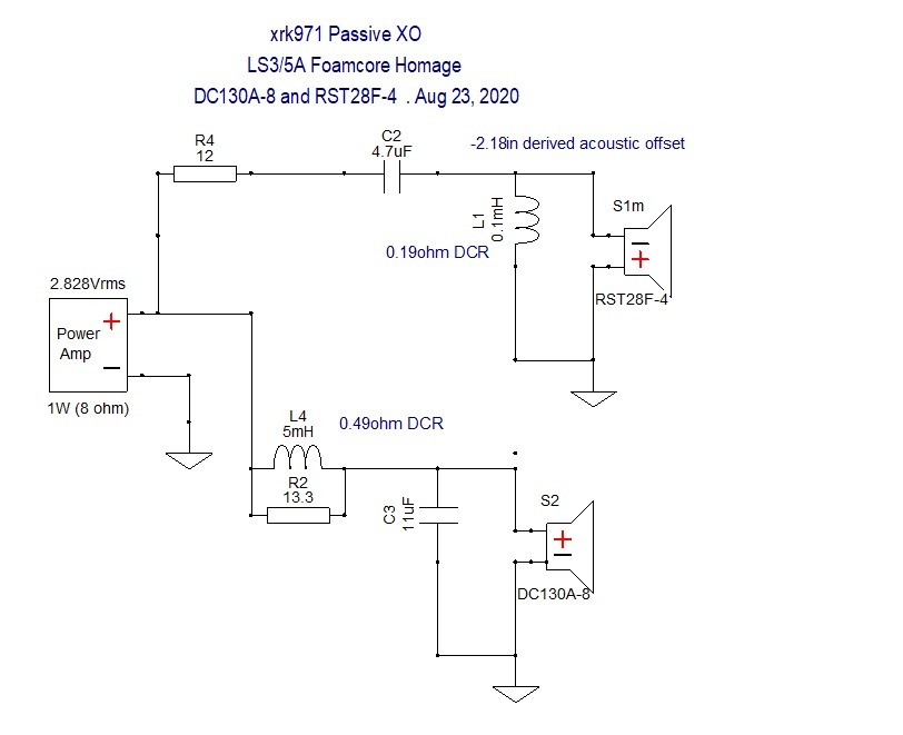

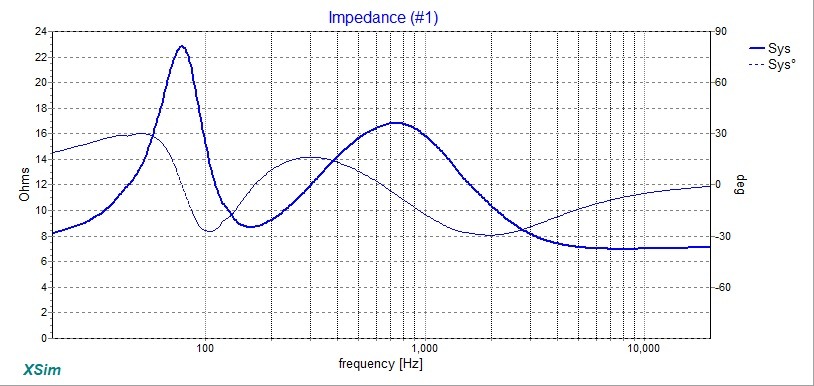

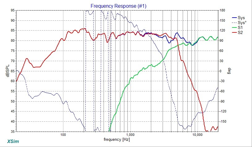

I thought of using one DC130-4, which ( I think) would present similar nominal impedance as two 8 ohms in parallel, but have different SPL and impedance profile; I can check that with a sim, which I know won't be accurate as it's not measured in box. However, if I input your XO into Xsim, and then try to replicate the slopes, that might get me in the general area. Apparently Dayton's supplied files are quite accurate.
I also thought of using Curt's TM crossover, as the Tritrix has the same baffle width and driver layout as your TL, but his TM is not a transmission line so it the XO may not be optimal?

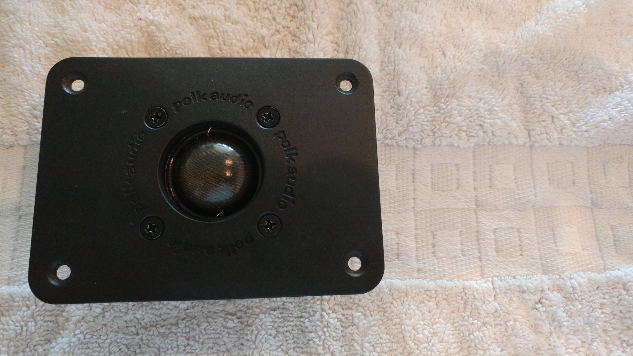

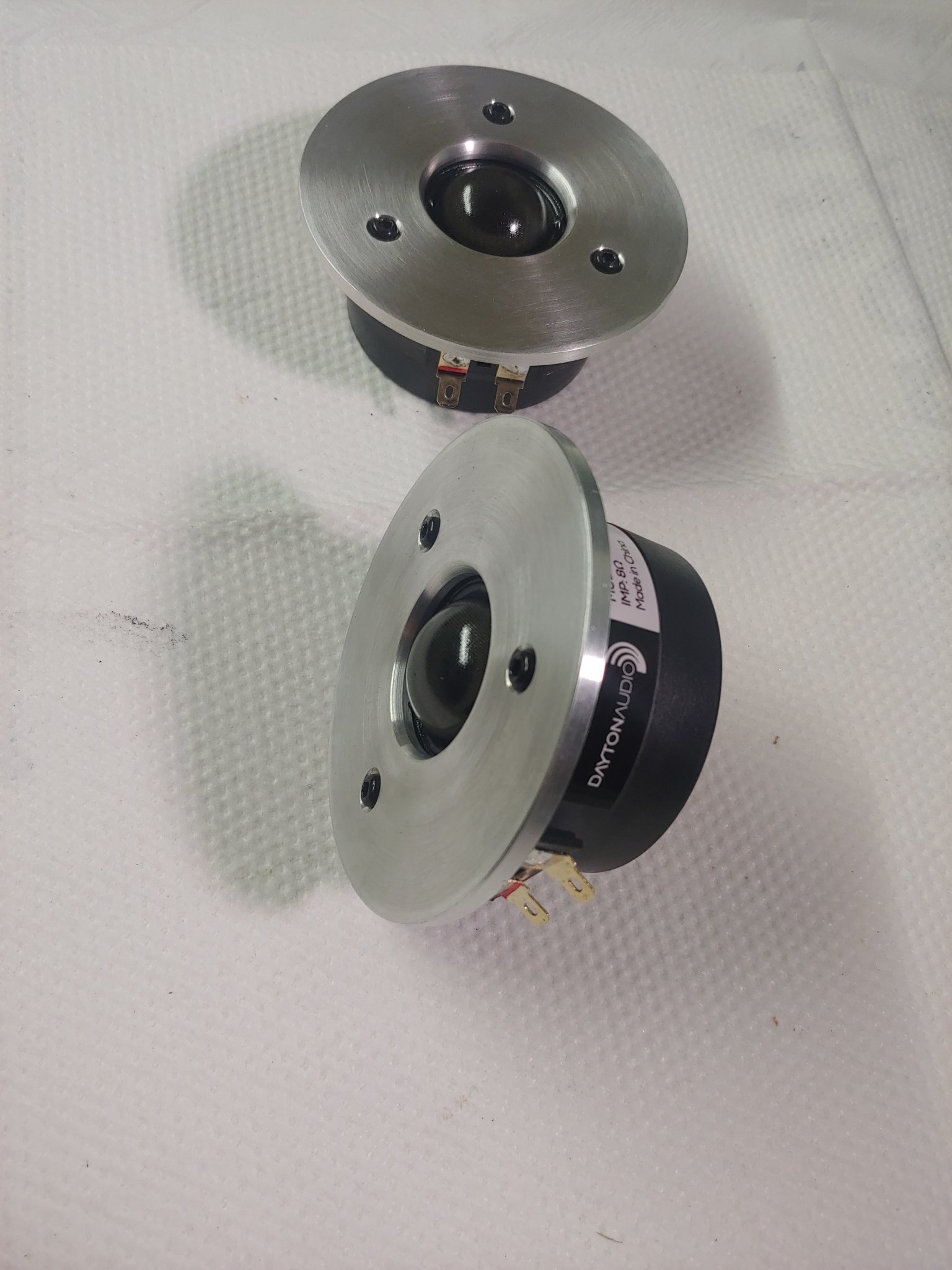

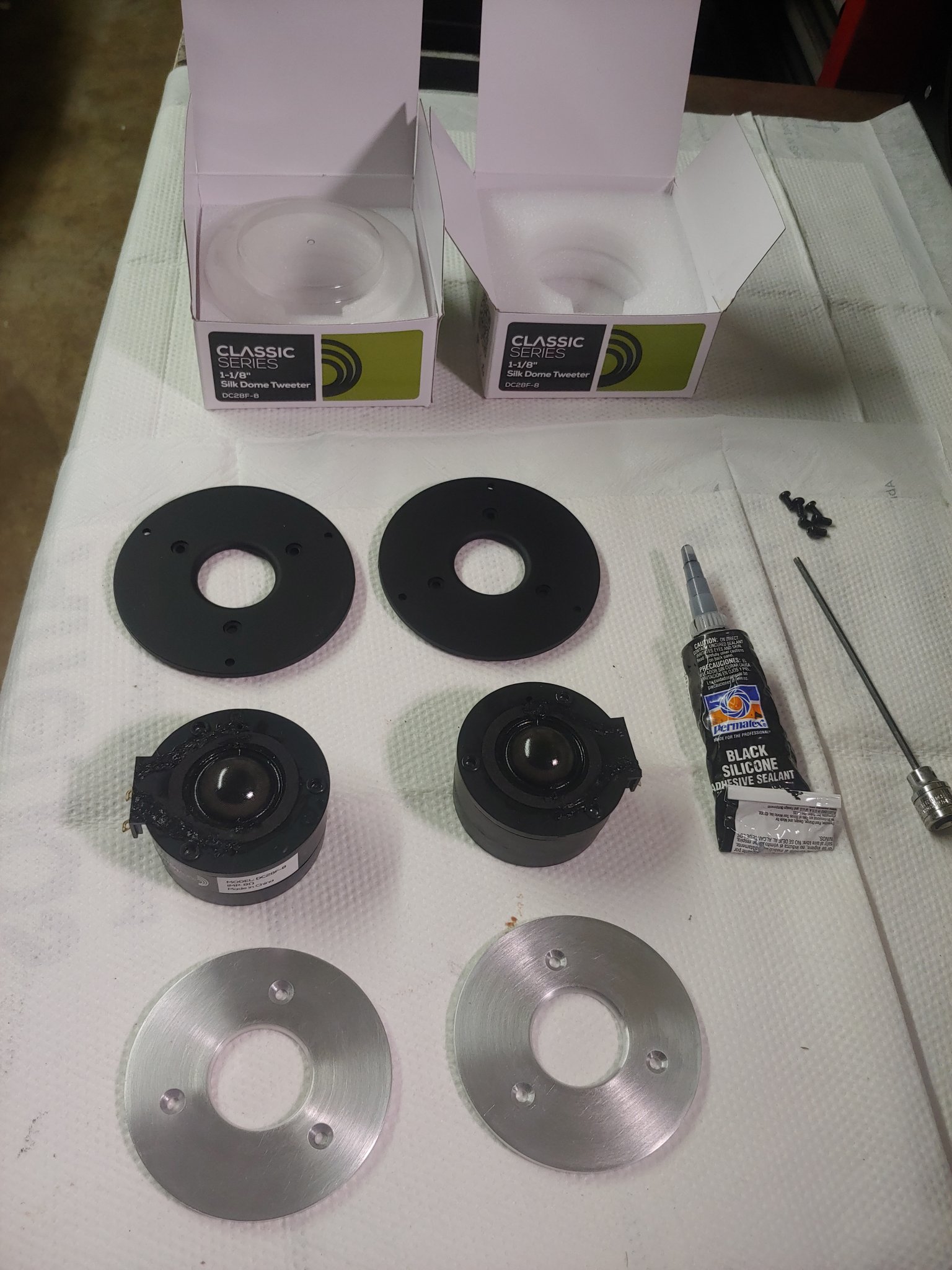

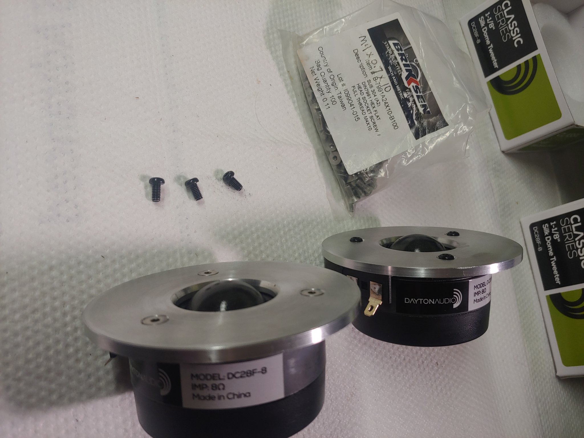

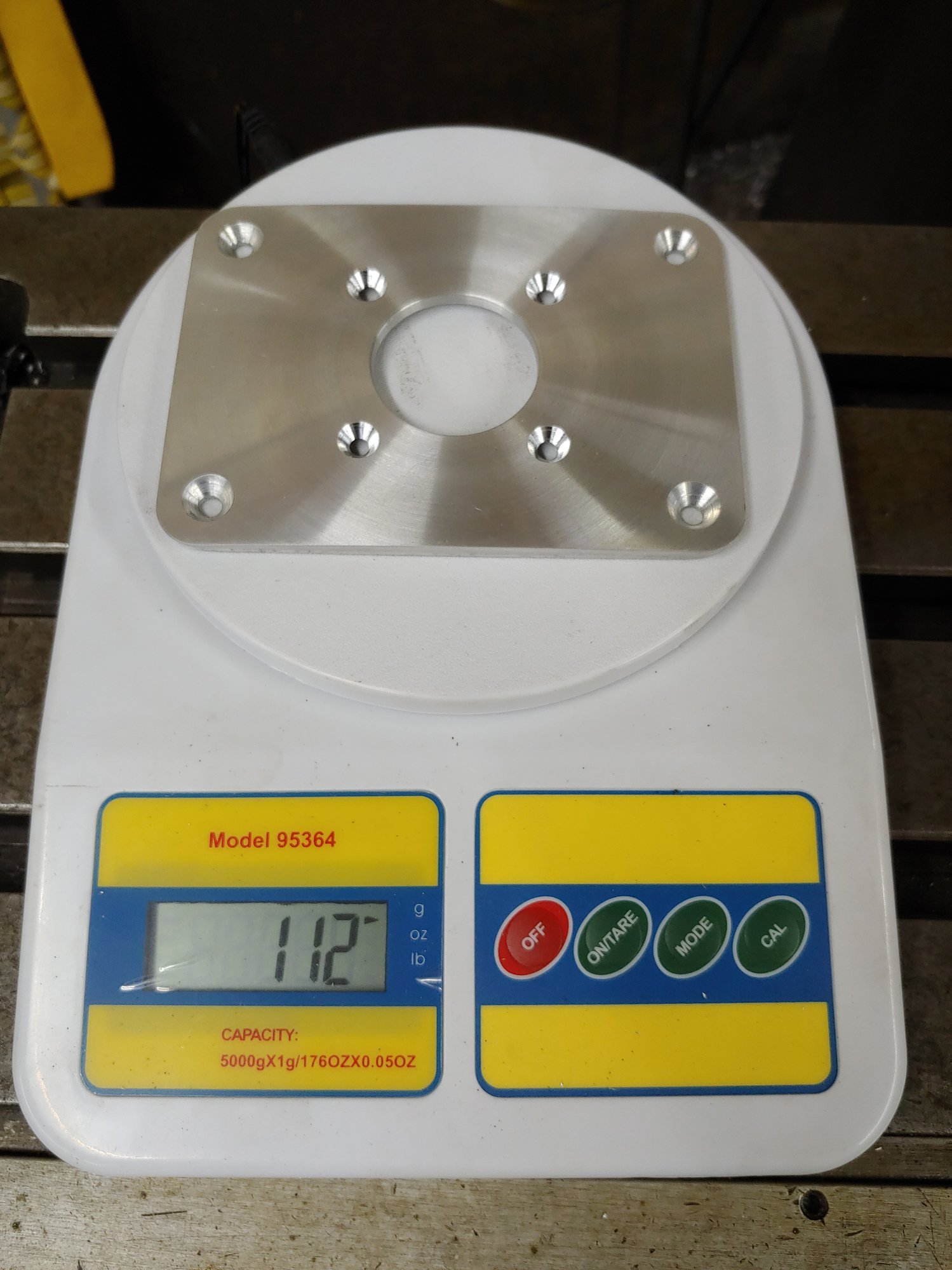

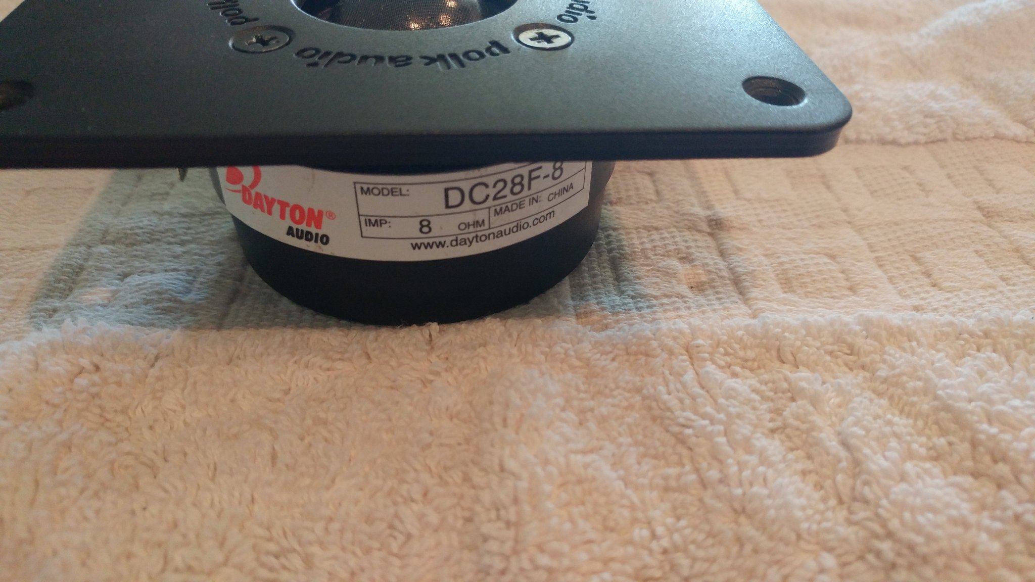

I'm putting these Dayton DC28F's in my 4th set of custom vintage Polks and have found that a billet faceplace brings out much better resolution in these sticky domes...Polar Measurements

Do the RST28's come with an alloy faceplate?Nice work on your custom faceplates. Might as well buy RST28F’s which are my go-to dome tweeters nowadays. I have about 5 designs that use them.
Thank you. It sounds like one too. I originally had a set of shop speakers with them and plastic bezels. I updated the bezel to billet and they came to life.Nice job. Looks like a thousand dollar tweeter!
I agree, 4 screws would be better in plastic, but they still did not have the best clarity/resolution until I machined the billet plates....They look marvellous, very classy: such a contrast with the standard surround.
Functional, too as the plastic with three screws isn't the strongest.
Well done
Geoff
Probably the stiffer faceplate results in a better damping of unwanted resonances. Had simple Q Acoustics bookshelf speakers and upgraded to the Concepts. The used drivers are the same but the additional pvc/rubber layer between chassis and tweeter results in a so much better clarity. Maybe a similar effect? The Metalplate will resonate in a different register than the thinner plastics faceplate.
I copied the Dayton throat profile, it is the same as plastic bezel contour.I wonder why a metal faceplate makes it sound different? Did you change the way the plate round over interfaced with the tweeter perimeter? Or just a stiffer mounting gave it more resolution?

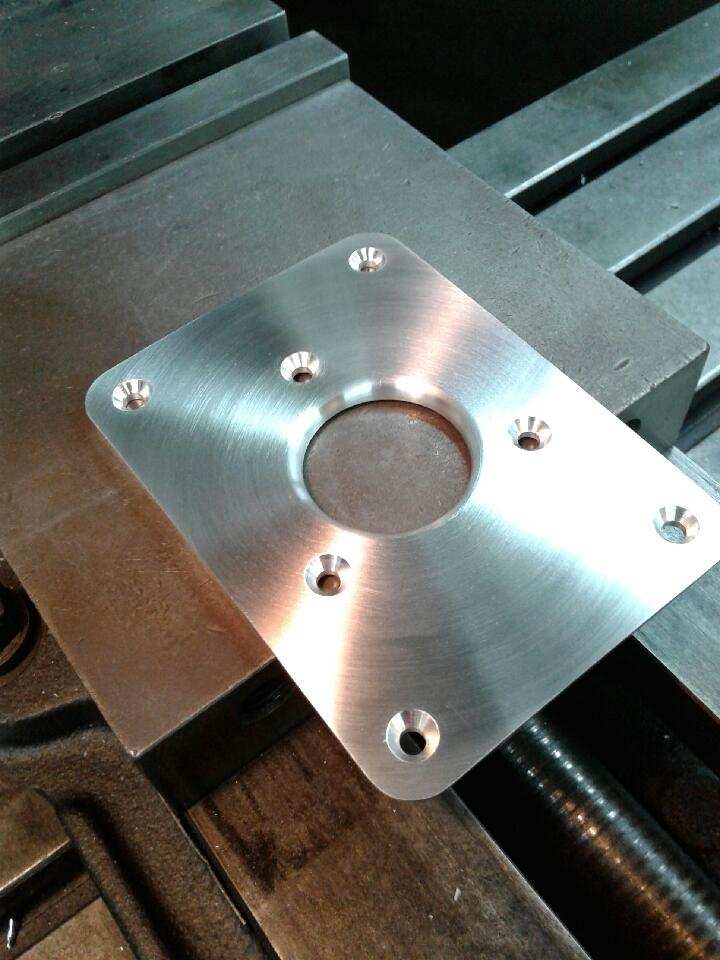

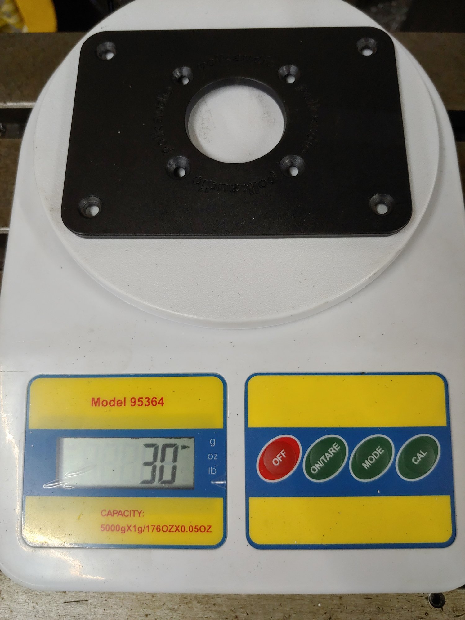

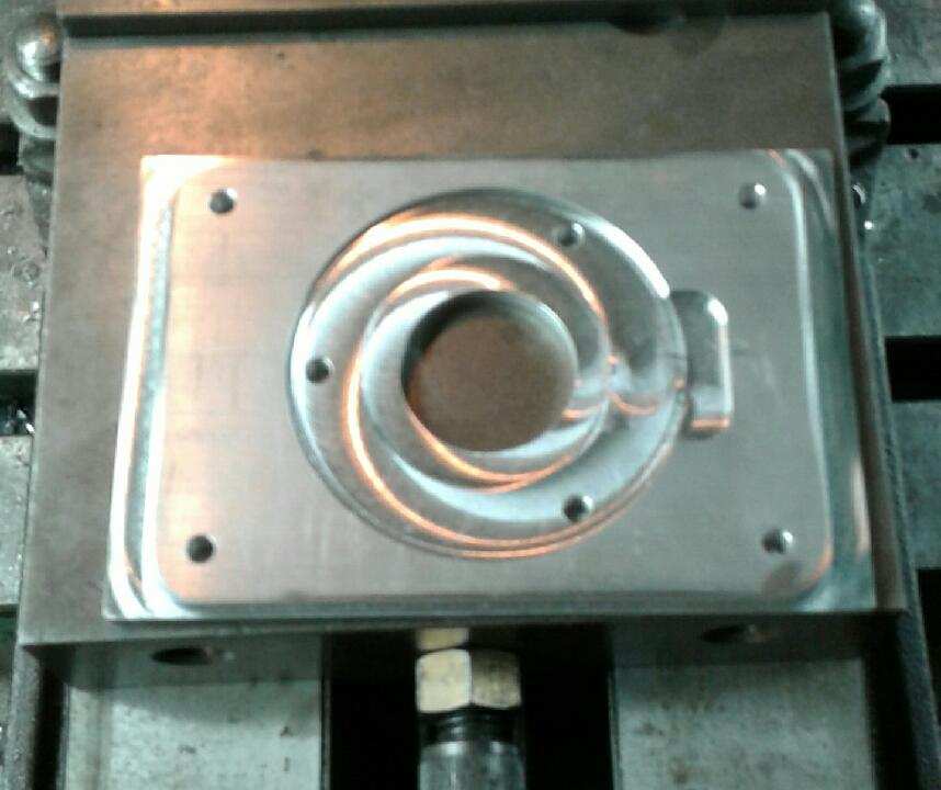

When I machined a batch of Polk billet plates, I copied their 15 deg throat profile and their large curved face radius on CNC...
The faceplate step / lip at the tweeter dome will have a considerable effect on HF dispersion as well as upper end FR, especially off axis. A good example of this is the dished lip profile Morel uses on some of their higher end domes, emplying a slight dish.
The FP material itself will have very little to do with the character of the tweeter HF response, depending on surfsce texture and some possible diffraction artifacts from screws or other fasteners protruding from the FP surface. It would be very hard to get any detectable ringing from a stiff metal faceplate mounted (essentially clamped) to a cabinet with the speaker playing even at considerably high levels. The only thing I could think of interacting with the faceplate is the mass sum of midrange energy causing minute flex or mechanical distortion in the thinner plastic FP. This modulating with the HF (IM distortion) - that could possibly smear the treble slightly. The metal FP would certainly completely eliminate that. There could also be a change in acoustic center offset between both drivers. That would be very noticeable, even more so if it moves the primary lobe further off tweeter axis.

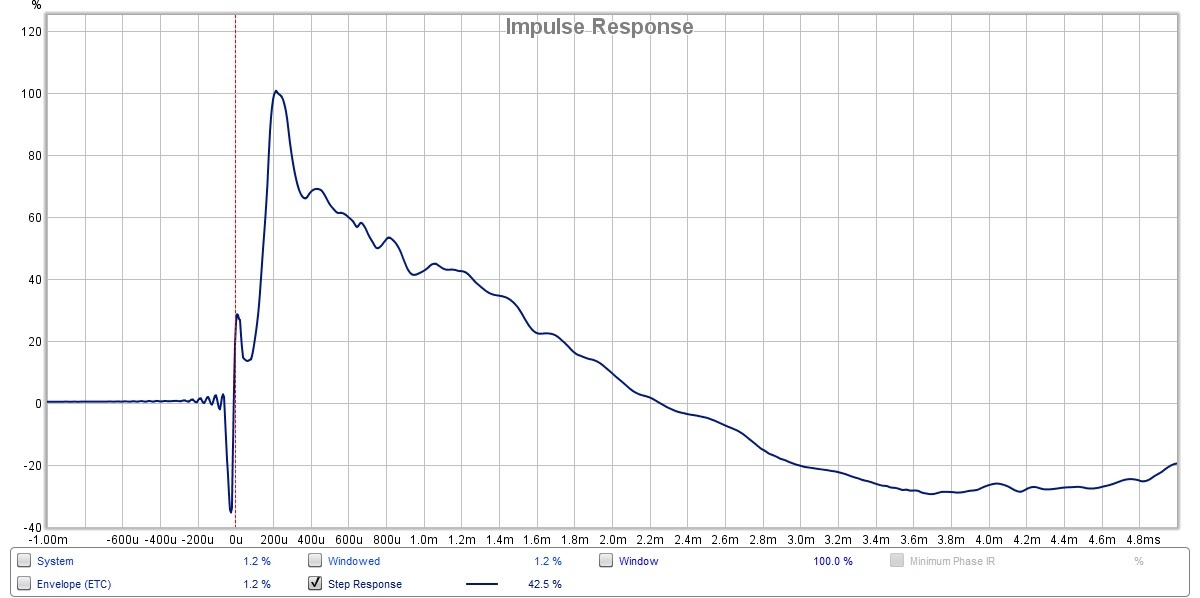

1/2in MDF is fine. For the baffle I suggest 3/4in to give enough room for screws to bite into. Or 1/2in plywood on baffle. If you want to use a passive XO, I can suggest switching the tweeter for the RST28F, and using the XO from this speaker. It sounds wonderful and is quasi transient perfect. More here.
Step response measured:

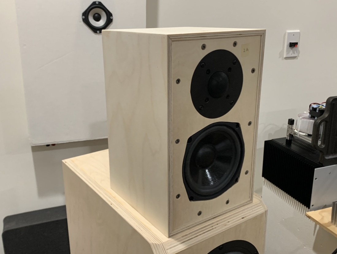

Plus you get the nice bass of the TL. Use 4.9in CTC distance from woofer to tweeter. Make baffle width 7.5in and the XO will work perfectly. Both drivers need to be flush mounted. Make the baffle look like this but add the TL vent of course.

With 6.0in inside width and 3/4in plywood sides you are at 7.5in external width. This is perfect because the crossover was designed for a 7.5in external width. The cabinet width affects the baffle step frequency and hence the tuning of the crossover.
If you are using DC28F, the impedance is 8ohms whereas RST28F is 4ohms. The crossover filter is off by 2 on the capacitor and inductor. It’s not a drop in fit with the current passive crossover.
Based on impedance scaling alone, double C2 to 10uF. You may need to adjust R4 to level match. Hard to say what L1 needs to be. It’s sort of going to be rough - you may be better off with DSP.
