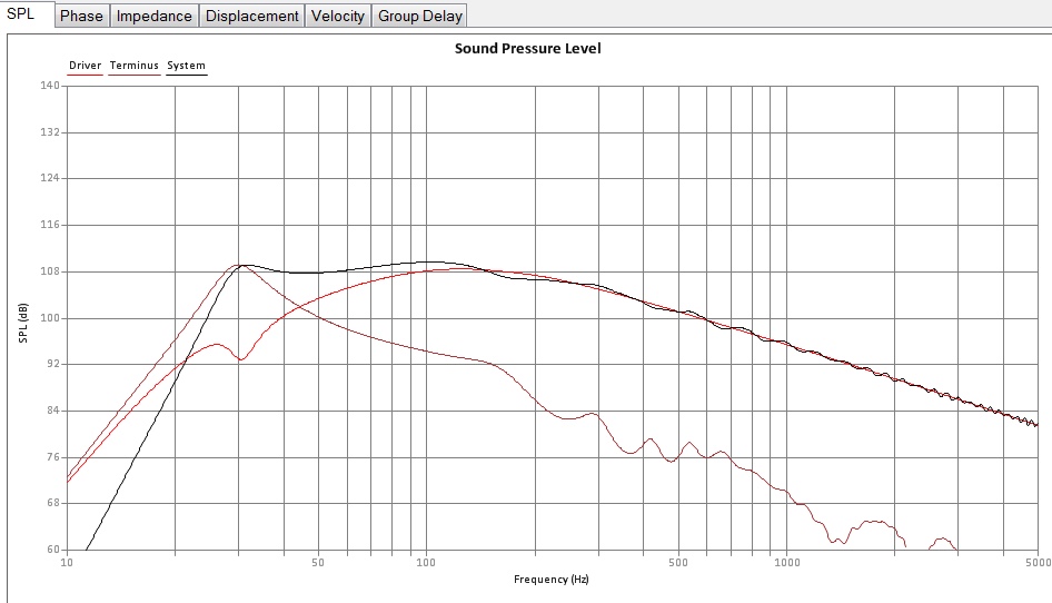

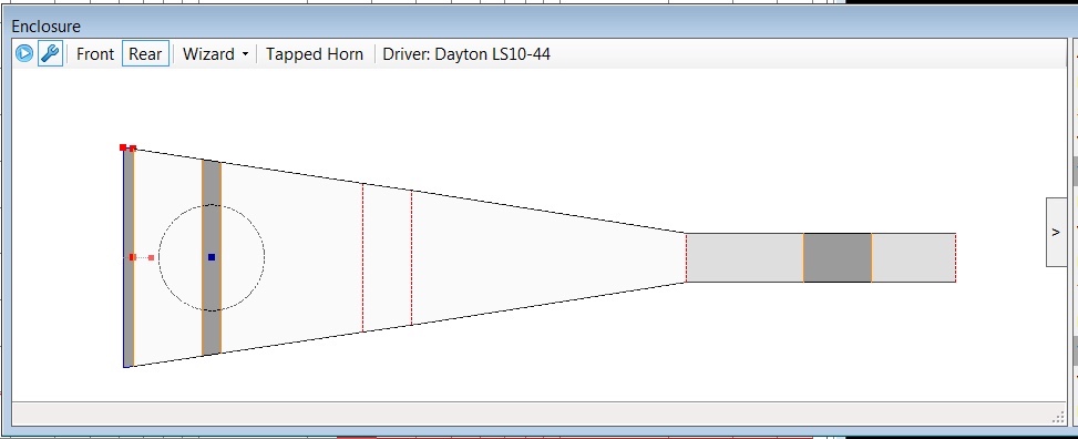

For what it is worth, I am using the LA software to design the TL and found a neat trick on stuffing / damping or whatever it is called. It seems that, as you also noted, the PMC TL's have more damping at the driver location. Using the LA software, I can split the TL in segments and fill each segment with damping material (kg / m3). That way, I can simulate the effect of the damping on the SPL curve, impedance, etc.
I found that there are 3 spots in the TL that effect the behaviour at its max, which is no surprise. At the closed end of the line (impact the roll-off at fb), behind the driver (impact the first and second harmonic bumps) and in the last segment (mostly middle of) which impacts the other harmonics.
Adding damping along the whole line, mostly results in lower SPL over the effective frequency range of the driver (no surprise I guess). It also flattens the bumps a bit, but not much.
HOW it sounds, I need to build it
See attached picture. I assume this can be explained in the science world, which is way beyond me. However, I think this approach could give me a nice first build version.
Comments / observations much appreciated.
