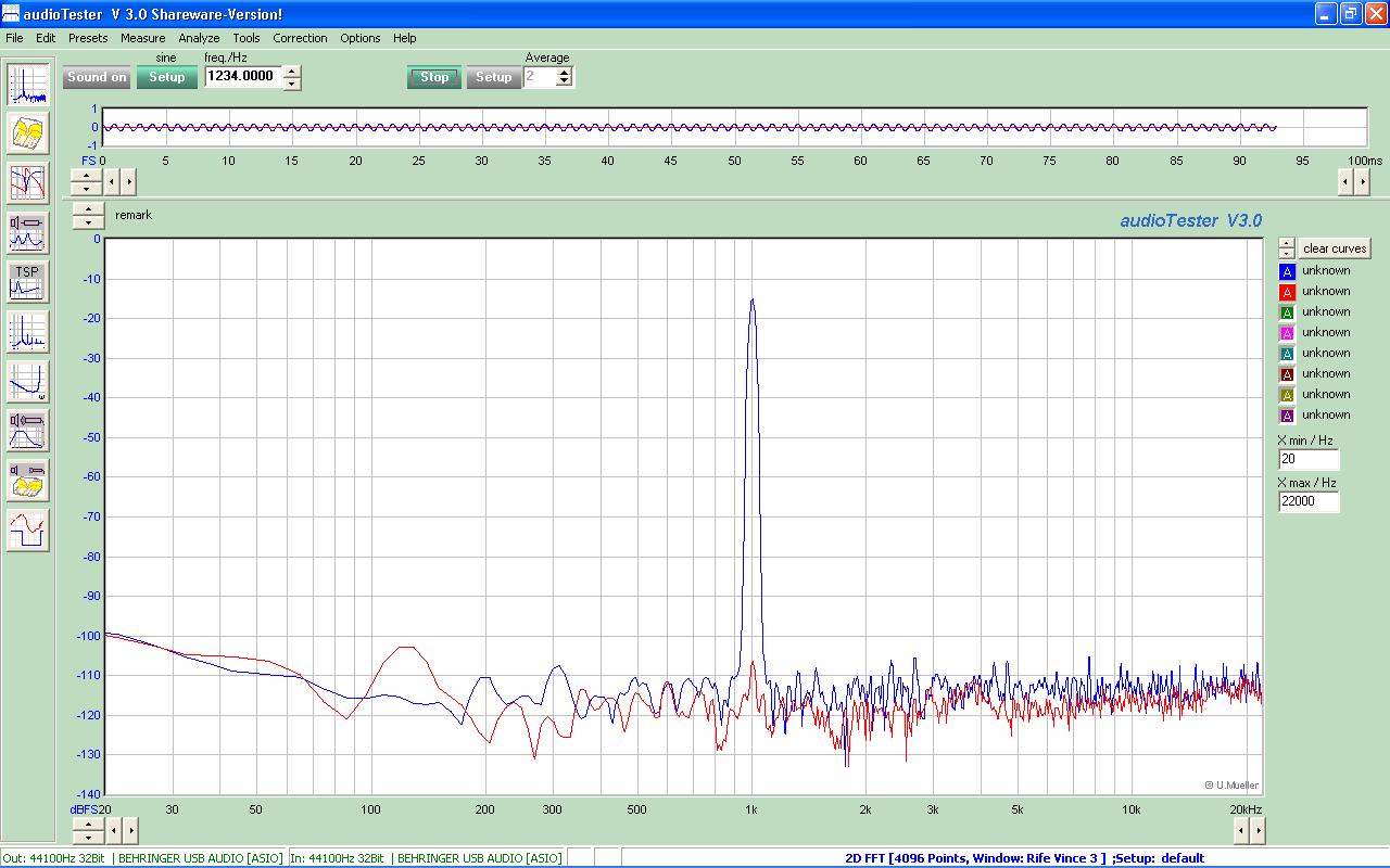

Hi
we are using the 1KHz oscillator to test our AD7760 based function blocks, and we are seeing some problems, they may be related to the DC block capacitor but we are not sure yet. We made first measurements with 47uF MLCC capacitor (ouch !!! our bad of course) we got somewhat below 8ppm THD, 101 db SNR, with 3rd harmonic being dominating.
Replacing the DC block with some 0.33uF large ugly blue 1000V rated capacitor of unknown technology and origin, we got 5.3 ppm THD, 105 SNR, but we completely lost 3rd harmonics? At least below 145dB !!
FFT attached, 1M point FFT, AD7760 with 625KSPS sampling rate default digital filters used (cut off 250KHz).
Can I assume safely that the 3rd harmonic what we did see with MLCC capacitor was indeed the capacitor non-linearity related spur?
In that case the 2nd harmonics that dominate with the other capacitor is most likely not any more at all related to the capacitor but some design problem with our ADC?
We do supply the 1KHz generator from four 9V batteries, output level is set to the maximum.
Any ideas how to get the remaining harmonics out? We will try more capacitors, but I bet those will not change the picture any more.
/Antti

1) your ADC will never be perfect.
2) Ceramic caps will limit the performance a lot.
3) only a few types of film caps will be linear enough to not be an issue, Teflon, polystyrene and polypropylene are commonly available.
4) The AGC is the bigger issue in distortion at this level. The Silonex parts are good but CDSE is non-linear with a high voltage coefficient. Keep the voltage across it as small as possible.
5) Some opamps are potentially lower in distortion. It seems hard to predict and you will need to just measure the results.
6) Use a twin T notch to see what the source distortion is. I get well below -130 for all the harmonics with the Shibasoku generator so I know its possible.
7) When you get all the pieces working better you will see more things to make better. There is no end to this.
8) Victors oscillator is more than good enough for almost any kind of testing and costs so little for what it is.

Victors 1KHz measurements, no notch method
Hi
after some fine tuning we got some pictures that look already pretty nice:
Both screens are from same FFT run, Blackman window, 65K points, sample rate is 625KHz. I guess those are not so bad plots for DIRECT without notch filter measurements.
Can someone comment if this is all that is possible, or would it be really possible to get rid of the last harmonics spurs?
Setup: Victors oscillator (batterie powered) > DC coupled to AD4940 +input, AD4940 -input to GND via 620 Ohm, AD4940 OCM floating (Decoupled with 0.1uF to GND). ADC is AD7760. Victors oscillator is not shielded just PCB.
To have on the desk an ADC with 160dB noise floor is already nice, but we want more
to get rid of the last few ppm of THD.
As of ALL measurements done with Victors generator, the spurs of 2nd and 3rd harmonic what we see at -138dB and -143dB are not in the generated signal?
Ok, we still have some fine tuning todo, the resistors in the differential path are maybe not all 0.1% ones and the power supply for AD4940 is a bit asymmetrical (+3V and -3V).
BTW, we will maybe be doing replica of the claimed PPB range oscillator, the funky one with those 180dB gain blocks.
