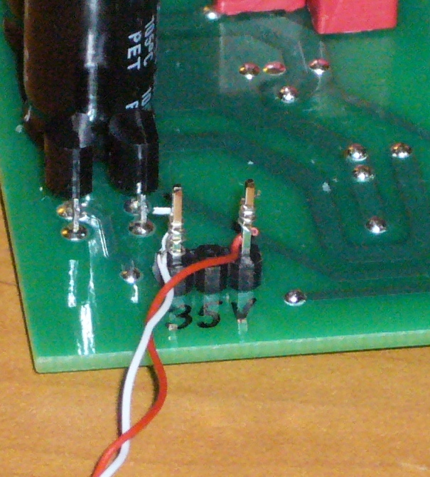

Does anyone know what this connector is called, and what is the name of the female socket that goes with it? Thanks.
Hi dirkwright,
It called a header and a header connector would mate.
There is all sorts.
David.
.025" square posts on .1" centers and he uses the first and third position on a three pin connector. Start here for the pins: 929400-01-36-RK 3M | 929400E-01-36-ND | DigiKey they list compatible connectors at the bottom but there are many others

Or just twist the wire around like you did, add some solder on top, and call it "MIL-STD"
Really![]()
Well, maybe so. I looked up the parts kindly mentioned by 1audio but they didn't seem right to me. I went digging through the Mouser catalog and I'm still not sure if I found the right part. There's a lot of things I don't know. I guess sometimes solder solves the unknown just as good.
This is a bit complicated... by digikey you need to search for HOUSING's
one choice
65240-003LF FCI | 609-1263-ND | DigiKey
76347-401LF FCI | 609-4453-1-ND | DigiKey
the first is the housing, the second is the "crimp" pin (you need 2 of them). If you do not have the crimp tool, it is still possible to attach the wire, use some some other tools, and optionally solder as well.
There are plenty of SIMILAR housing and pins, or then you can also buy femal pin stripe, but there it is pretty much more complicated to attach the wires nicely.
