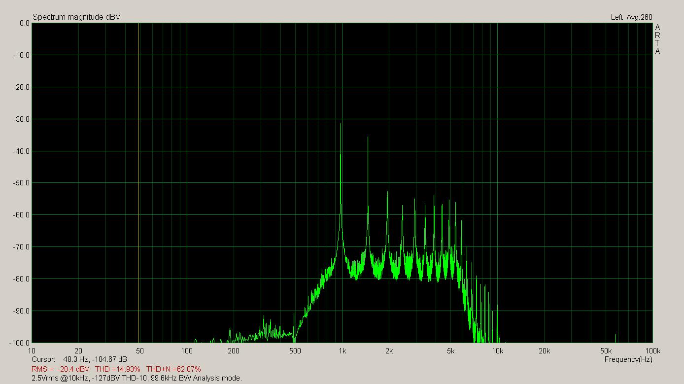

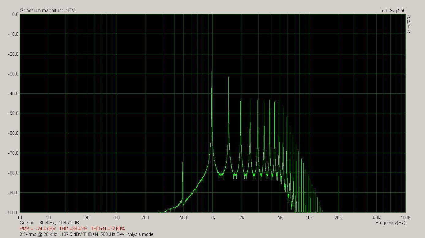

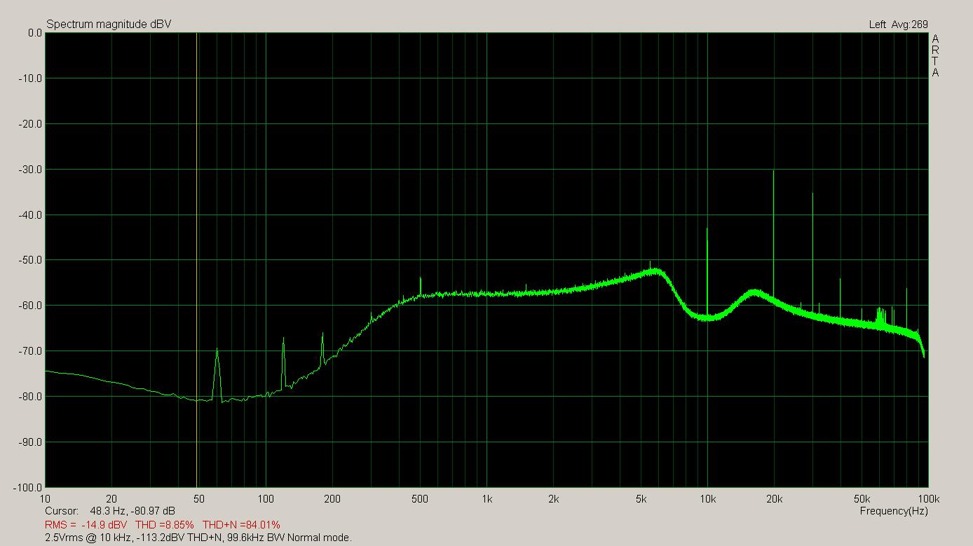

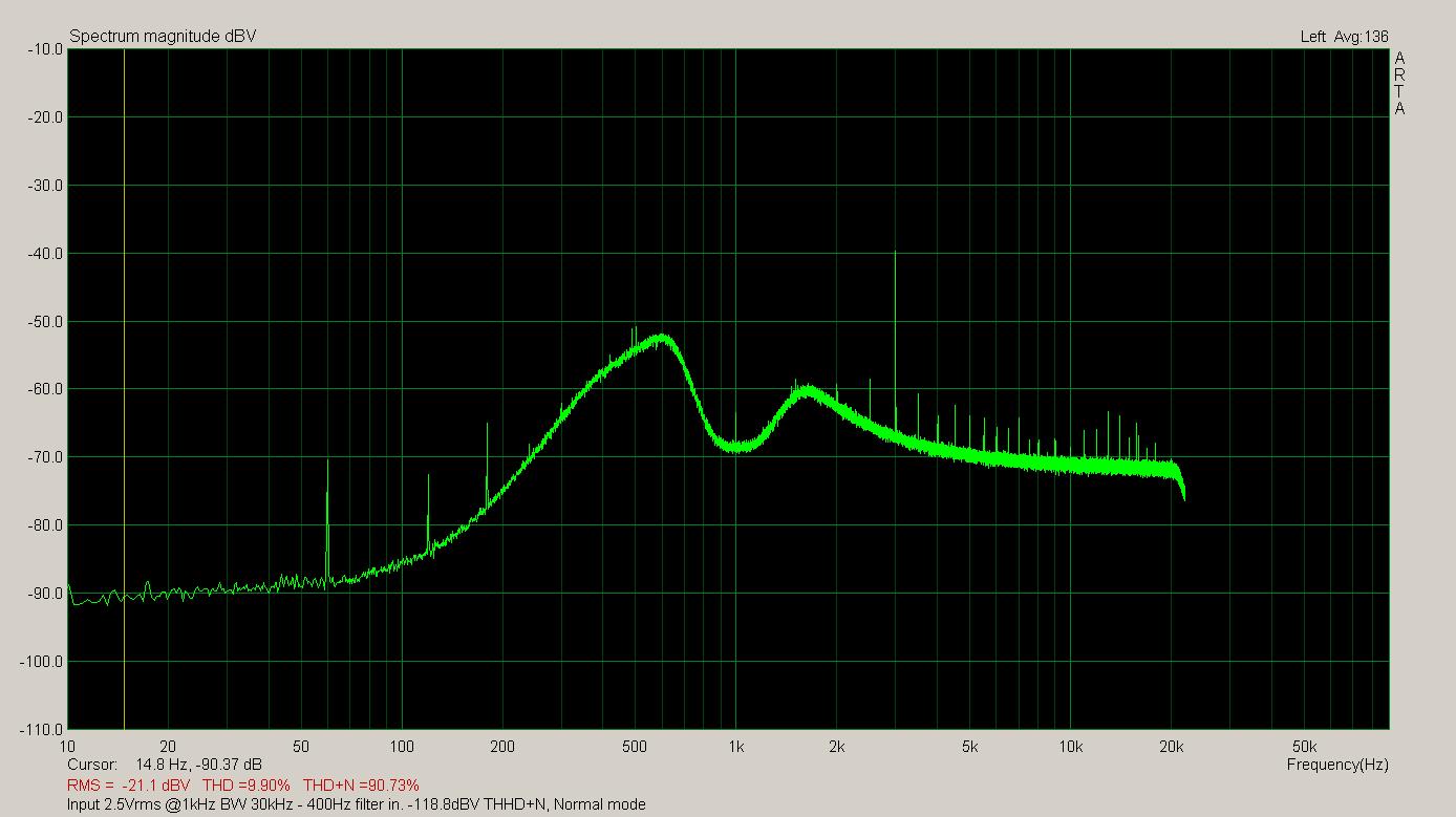

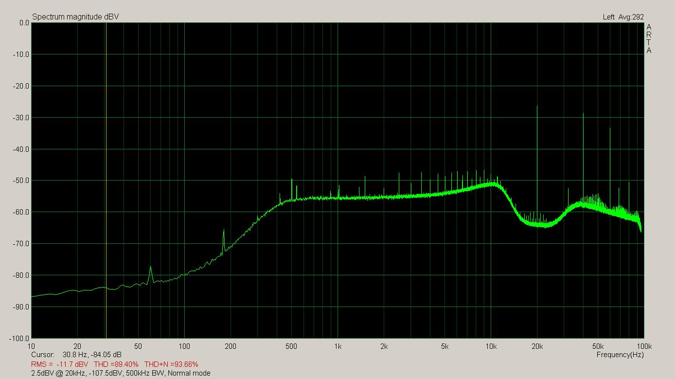

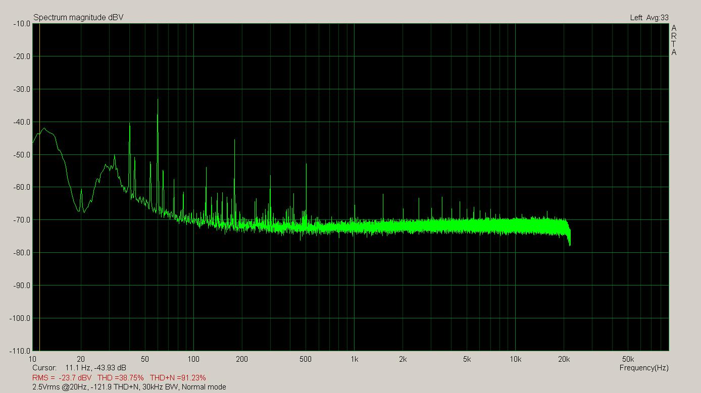

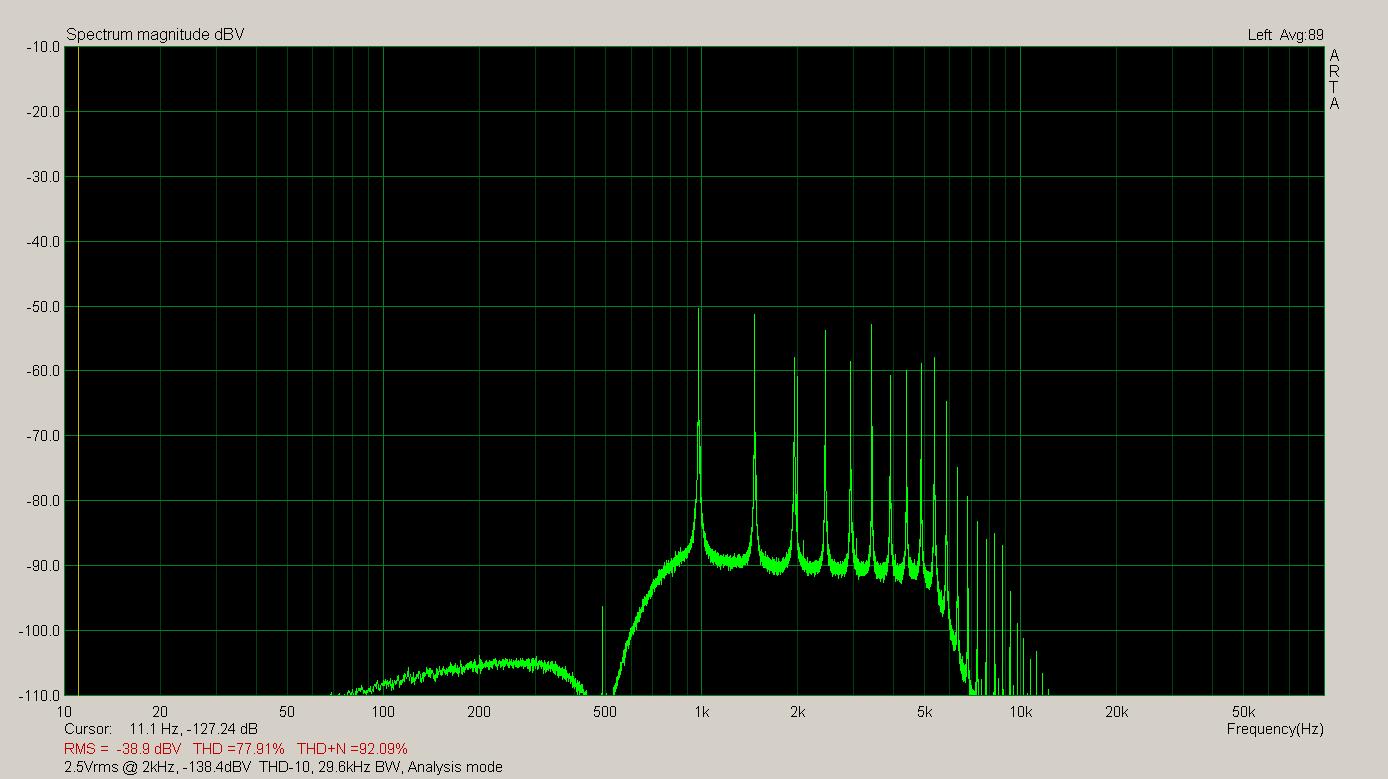

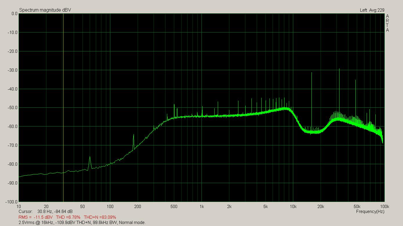

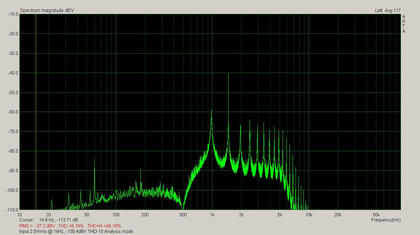

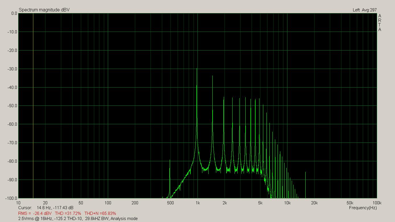

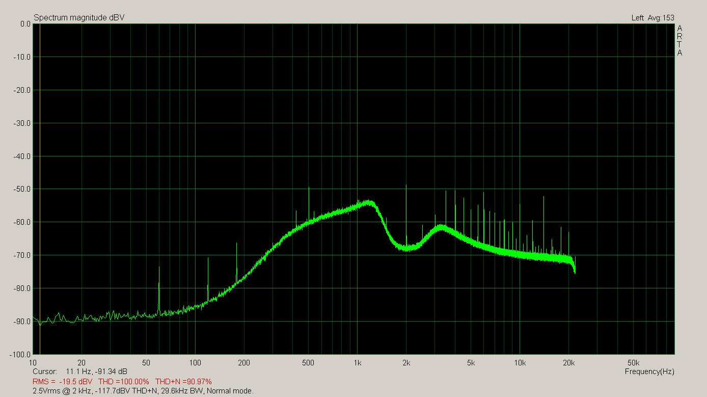

Bob you asked this question before in this thread and it's never been properly answered.
Here are measurement with a Shibasoku AD725D and my oscillator dlbSVO. The dlb are my initials and State Variable Oscillator.
Before presenting the measurements it is important to understand how the Shibasoku AD725D analyzer operates.
In Normal mode the analyzer operates as any other audio analyzer. The 725D ranges down to 0.0003%, -110 dBV FS of the meter. And when the meter is at full scale the monitor output is 1Vrms, 0dBV.
In Analysis mode the output of the 'Normal mode' is sampled synchronously to the input frequency. Unlike audio sampling the sampling frequency is variable with the input signal frequency. This divides the signal into phases equal to the sample rate. If I remember correctly each cycle is sampled 64 time per cycle in the low to mid frequency range. The sample rate generator is phase locked to the input signal. The samples are put through a discrete DSP where synchronous averaging is performed. Anything random like noise divided down and any constant signal is averages the same. So the noise is removed but not the signal.The processed signal is passed to a DAC and reconstructed at a fixed frequency of 488.281Hz a binary division of the 1MHz system clock. The output of the DAC is always 488.281Hz regardless of input signal frequency. This approach allows fixed tuned filters to be used on the reconstructed signal.
The Shibasoku AD725D analyses the first 10 harmonics and this is used to determine THD.
In addition the first five harmonic can be viewed individually by the push of a button and a single harmonic can be seen on the Analysis monitor output.
During these measurement I will be switching between the Normal monitor port and the analysis monitor port depending on the measurement taken. To keep things simple the range is fixed at 0.001% (-100dBV). I have an EMU0204 connected to the monitor output.
This and ARTA are calibrated for 1Vrms (0dBV) FS. Therefore FS on ARTA correspond to -100dBV. ARTA is to be read directly - 100dBV.
The measurement are as follows:
Shibasoku AD725D & dlbSVO
2.5Vrms @ 20Hz BW = 30.0 kHz -134.2 dBV THD-10, -120.9 dBV THD+N
2.5Vrms @ 1kHz BW = 29.6 kHz -138.4 dBV THD-10, -118.8 dBV THD+N
2.5Vrms @ 2kHz BW = 29.6 kHz -138.4 dBV THD-10, -117.7 dBV THD+N
2.5Vrms @ 10kHz BW = 99.6 kHz -127.0 dBV THD-10, -113.2 dBV THD+N
2.5Vrms @ 16kHz BW = 99.6 kHz -125.2 dBV THD-10, -109.9 dBV THD+N
2.5Vrms @ 20kHz BW = 500.0 kHz -123.1 dBV THD-10, -107.5 dBV THD+N
2.5Vrms @ 89kHz BW = 500.0 kHz - 99.0 dBV THD-10, - 97.6 dBV THD+N

pics1
2.5Vrms 16kHz -109.9dBV THD-10, 99.6kH BW, Normal mode .JPG109.4 KB · Views: 86
2.5Vrms 16kHz -125.2dBV THD-10, 99.6kH BW, Analysis mode .JPG110.7 KB · Views: 97
2.5Vrms 10kHz -113.2dBV THD+N, 99.6kH BW, Normal mode .JPG106.2 KB · Views: 86
2.5Vrms 10kHz -127.0dBV THD-10, 99.6kH BW, Analysis mode .JPG109.9 KB · Views: 84
2.5Vrms 2kHz -117.7dBV THD+N 29.6kHz BW, Normal mode .JPG107.6 KB · Views: 82
2.5Vrms @ 2kHz, -138.4dBV, THD-10, 29.6kHz BW, Analysis mode.JPG109 KB · Views: 249
2.5Vrms 1kHz -118.8dBV THD+N 30kHz BW - 400Hz filter in.JPG107.3 KB · Views: 259
2.5Vrms 20Hz -120.9dBV THD+N 30kHz BW, Normal mode .JPG111.6 KB · Views: 309
