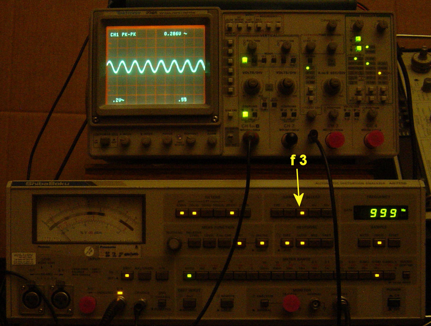

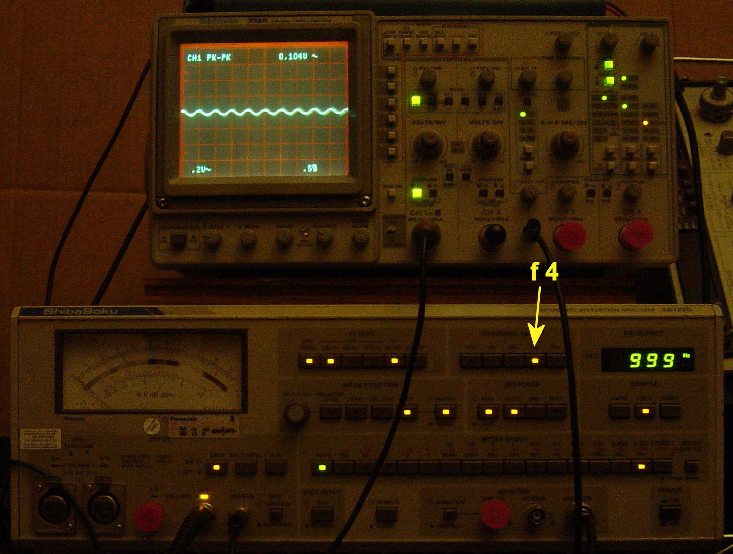

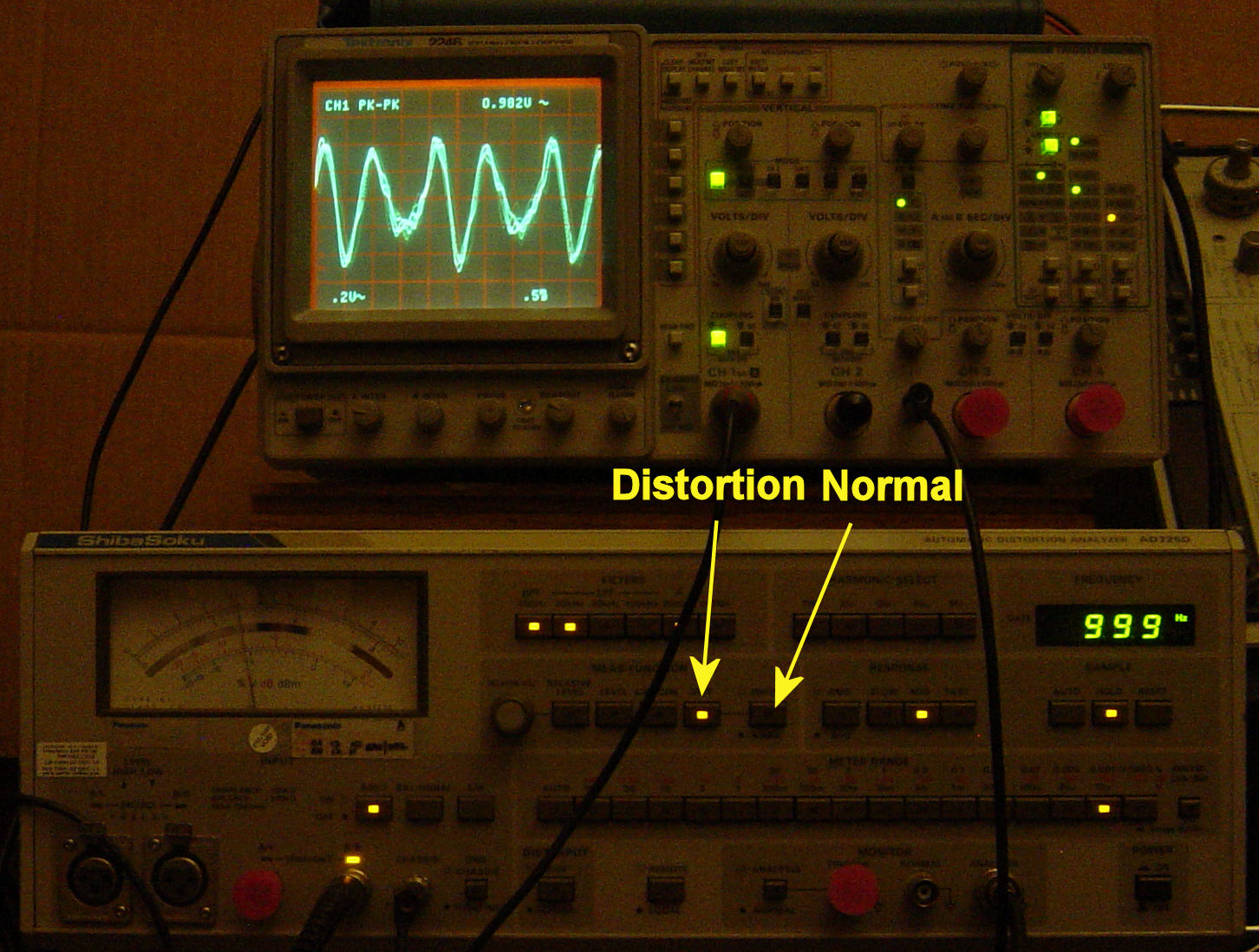

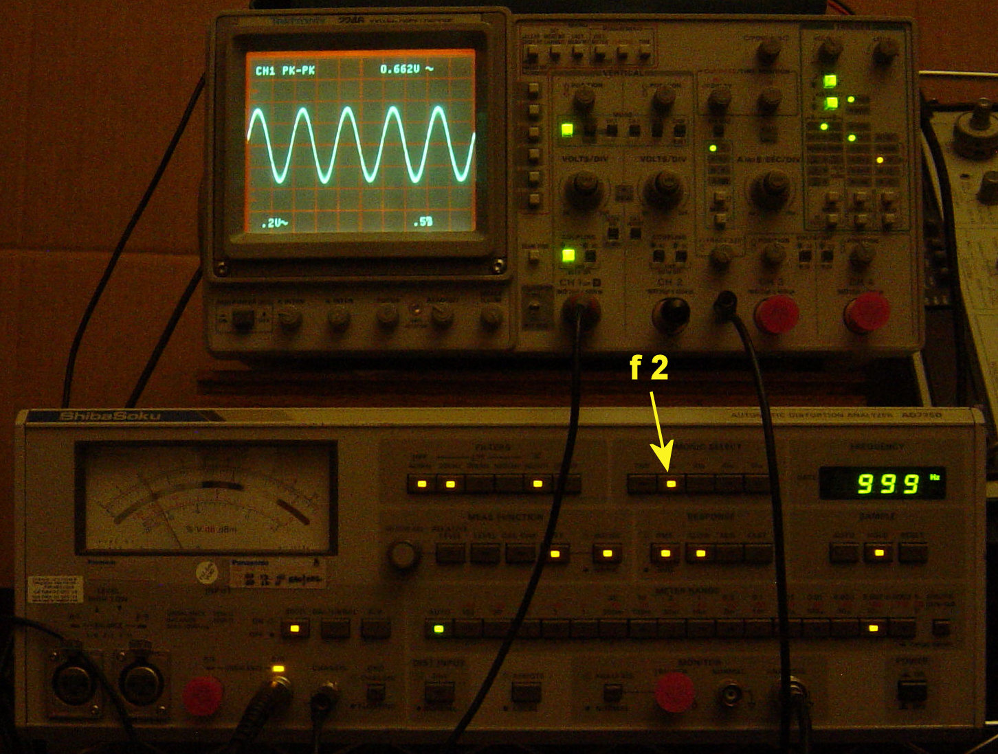

Before presenting the measurements it is important to understand how the Shibasoku AD725D analyzer operates.
In Normal mode the analyzer operates as any other audio analyzer. The 725D ranges down to 0.0003%, -110 dBV FS of the meter. And when the meter is at full scale the monitor output is 1Vrms, 0dBV.
In Analysis mode the output of the 'Normal mode' is sampled synchronously to the input frequency. Unlike audio sampling the sampling frequency is variable with the input signal frequency. This divides the signal into phases equal to the sample rate. If I remember correctly each cycle is sampled 64 time per cycle in the low to mid frequency range. The sample rate generator is phase locked to the input signal. The samples are put through a discrete DSP where synchronous averaging is performed. Anything random like noise divided down and any constant signal is averages the same. So the noise is removed but not the signal.The processed signal is passed to a DAC and reconstructed at a fixed frequency of 488.281Hz a binary division of the 1MHz system clock. The output of the DAC is always 488.281Hz regardless of input signal frequency. This approach allows fixed tuned filters to be used on the reconstructed signal.
The Shibasoku AD725D analyses the first 10 harmonics and this is used to determine THD.
In addition the first five harmonic can be viewed individually by the push of a button and a single harmonic can be seen on the Analysis monitor output.

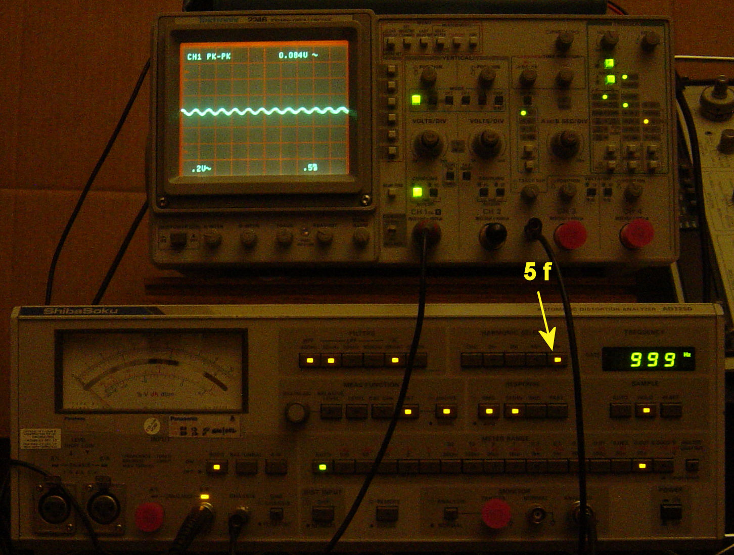

For anyone following along who doesn't have a Shibasoku 725,
I included some pics that might help explain what David is describing.
For these pics an HP339A was set to 1V output and input into the Shibasoku 725D, Then the Cal Check, (Input) Level, and Relative Adjust were adjusted the same meter reading (Normalized, for
lack of a better word).
Approx 1kHz, 1V Input.

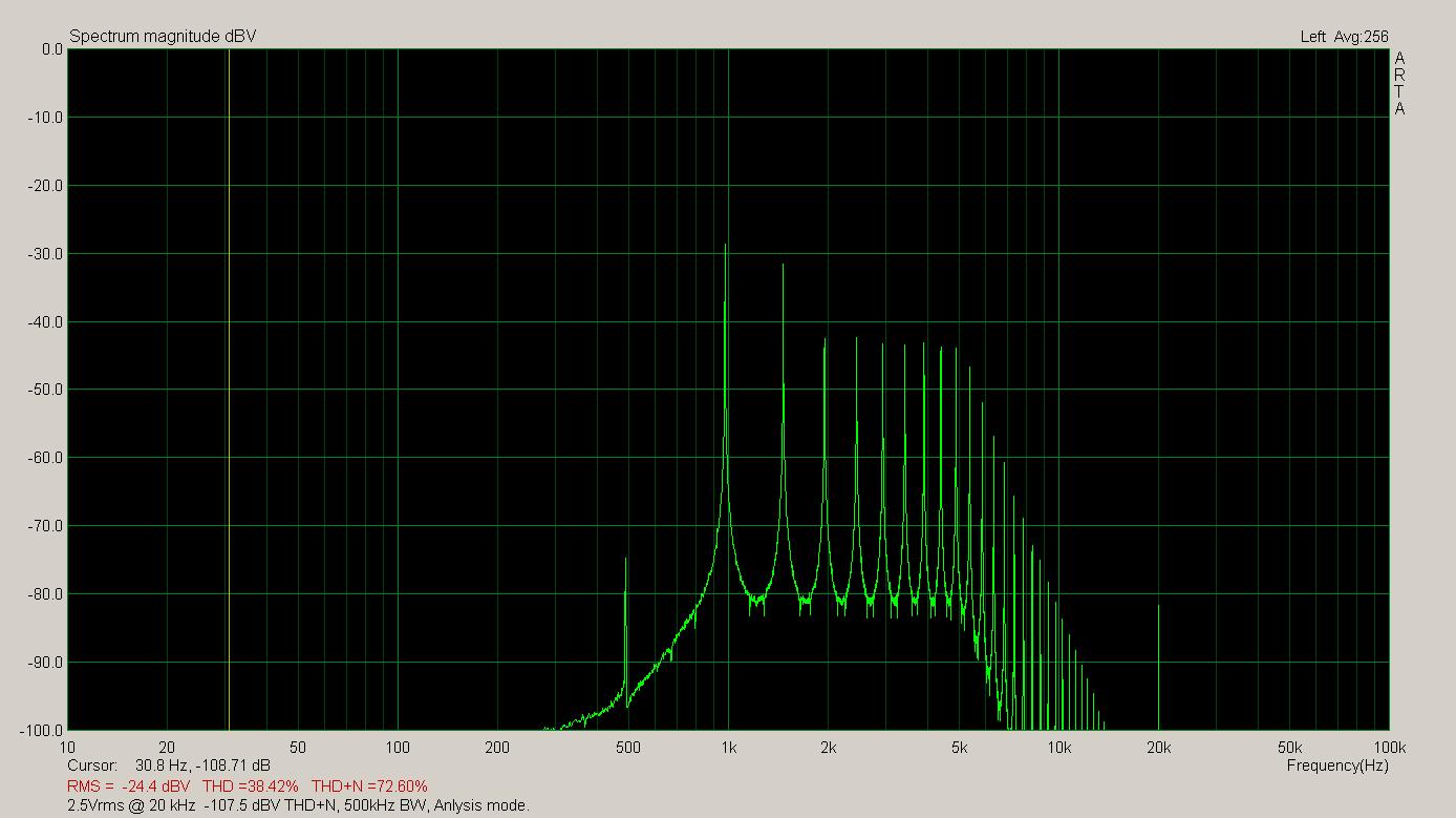

For example in PI[C]2 [lack of wee], the first plot has a lot of
versicle lines in it. Thinking these might be distortion harmonics.
Trying to figure out what the fundimental is and at what level,
and how to adjust what I see with what David wrote.
Here is the link to it so it won't be on another page:
So this is at 20kHz and is at -107 dBV THD+N, but what I don't
understand are the products before it, such at -29dB & -32dB?
at 1kHz and after that?
Is that a sweep through those frequencies?

Bob you asked this question before in this thread and it's never been properly answered.
Here are measurement with a Shibasoku AD725D and my oscillator dlbSVO. The dlb are my initials and State Variable Oscillator.
During these measurement I will be switching between the Normal monitor port and the analysis monitor port depending on the measurement taken. To keep things simple the range is fixed at 0.001% (-100dBV). I have an EMU0204 connected to the monitor output.
This and ARTA are calibrated for 1Vrms (0dBV) FS. Therefore FS on ARTA correspond to -100dBV. ARTA is to be read directly - 100dBV.
The measurement are as follows:
Shibasoku AD725D & dlbSVO
2.5Vrms @ 20Hz BW = 30.0 kHz -134.2 dBV THD-10, -120.9 dBV THD+N
2.5Vrms @ 1kHz BW = 29.6 kHz -138.4 dBV THD-10, -118.8 dBV THD+N
2.5Vrms @ 2kHz BW = 29.6 kHz -138.4 dBV THD-10, -117.7 dBV THD+N
2.5Vrms @ 10kHz BW = 99.6 kHz -127.0 dBV THD-10, -113.2 dBV THD+N
2.5Vrms @ 16kHz BW = 99.6 kHz -125.2 dBV THD-10, -109.9 dBV THD+N
2.5Vrms @ 20kHz BW = 500.0 kHz -123.1 dBV THD-10, -107.5 dBV THD+N
2.5Vrms @ 89kHz BW = 500.0 kHz - 99.0 dBV THD-10, - 97.6 dBV THD+N

Sync any sampled data can be reconstructed at a different frequency from the frequency it was originally sampled with. This hold true for fixed rate sampling as well as synchronous sampling. if you took audio samples and and played them back at half the recorded sample rate the pitch of the music would be half and the song would play for twice as long.
It's just like running an audio recording on tape at half the speed.
In communications, Am radio for example, it is desirable to to convert, replace all incoming carriers by filtering them off and replacing them with a local oscillator fixed to one frequency called IF. This simplifies the demodulation filters. One set for all frequencies.
So what Shibasoku did here was not a new concept at the time.
The reconstruction sample rate is about 488Hz. What you see near 1kHz is the second H. On the left of that is the suppressed fundamental. On the right is the 3rd H and so forth upwards 4th H etc. it takes a bit of getting used to but all sampled frequencies are played back the same, at the same frequency. This is very useful for us because we can use a spectrum analyzer or FFT on the Analysis output port and never worry about having enough bandwidth in terms of maximum sample rate of our sound card. Everything is well within the audio bandwidth and at a level we don't need question the accuracy.

With the Twin T in the 725D removed which breaks the signal chain there is quite a bit of noise. It drives the meter to 11% of the 0.001% range. With the A4, BEF 2 & 3, board removed the noise drops to 1% on the meter.
The noise is the difference between THD+N and THD. I think this is the 725D residual but some of might be from the oscillator.
