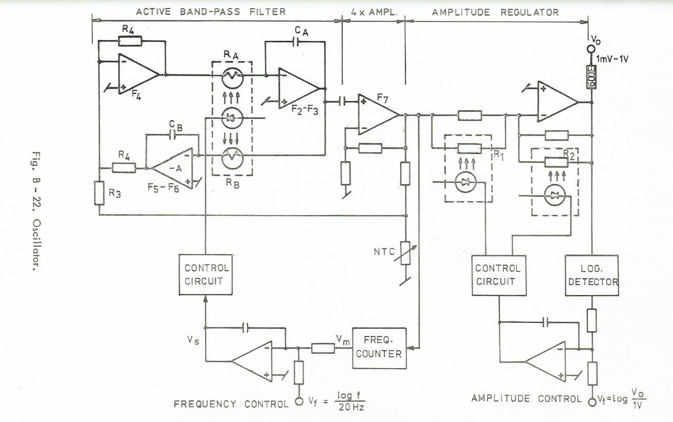

This venerable instrument had a voltage tunable state variable oscillator that went from 20 Hz to 20 KHz in a single sweep. It was around .005% THD.
I have the full service manual. This was the only page I was up for scanning tonight. If there is interest I'll try to scan the actual circuits in the next few days. The instrument is a real monument to skilled analog design with both the oscillator and the analyzer fully analog, including log displays on the nice large analog meters and the analyzer auto-tunes across the whole range. The target was tape recorder testing so they had to operate independently. I had one that needed some attention but lost track of it.
That unit showed in my eBay notifications this week as well. I expect a full report once you receive it. Beyond the settling time, did you see in the instructions where you should not have anything connected to the output connectors when turning on or off? Report back...I do like the fact it is already in an enclosure.
... time 1-6 MINUTES??!!
