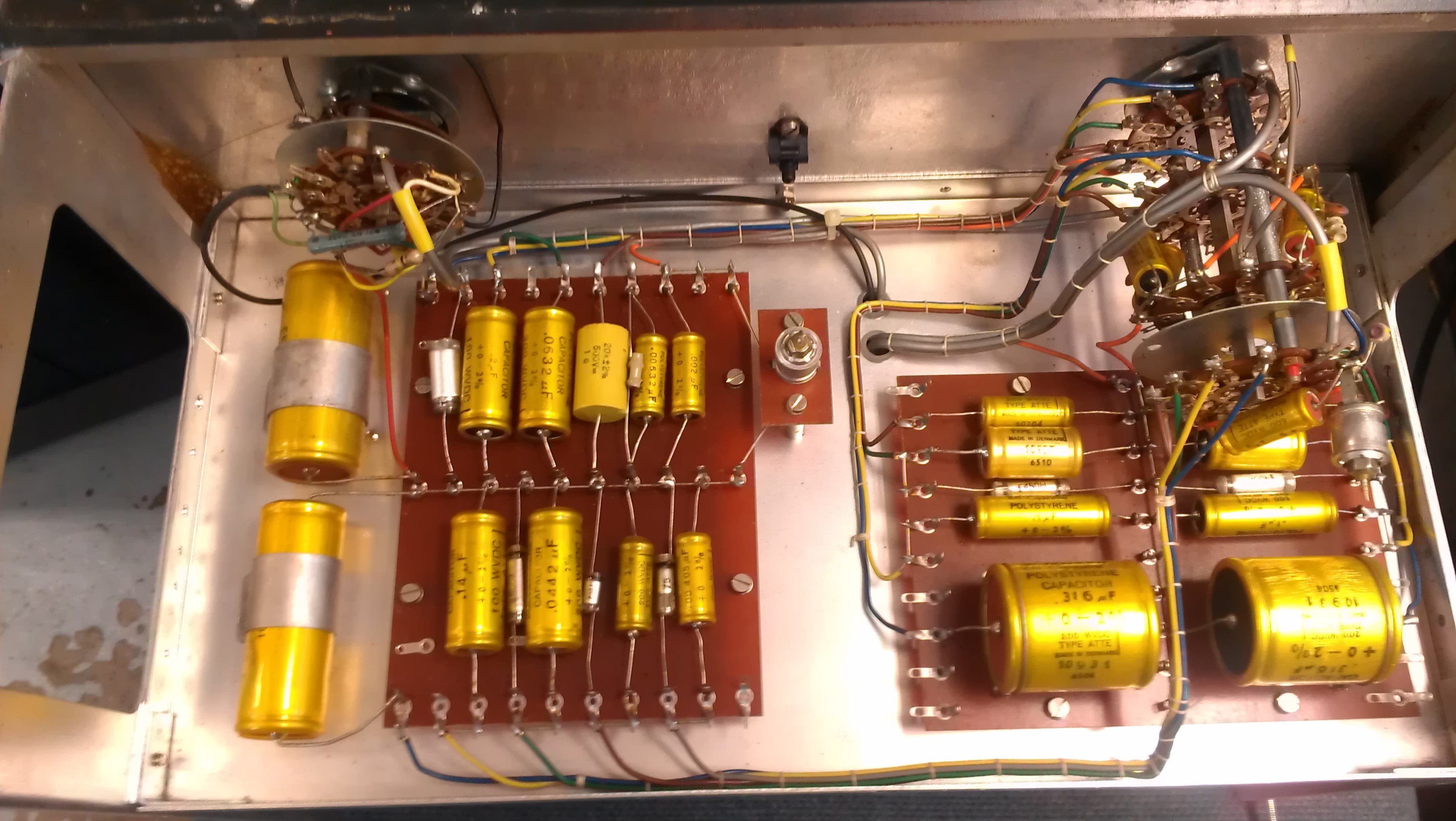

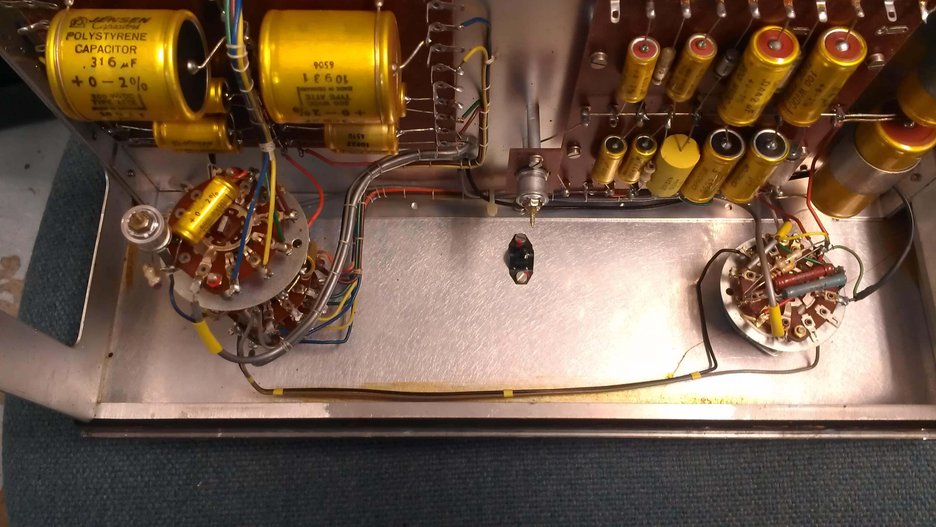

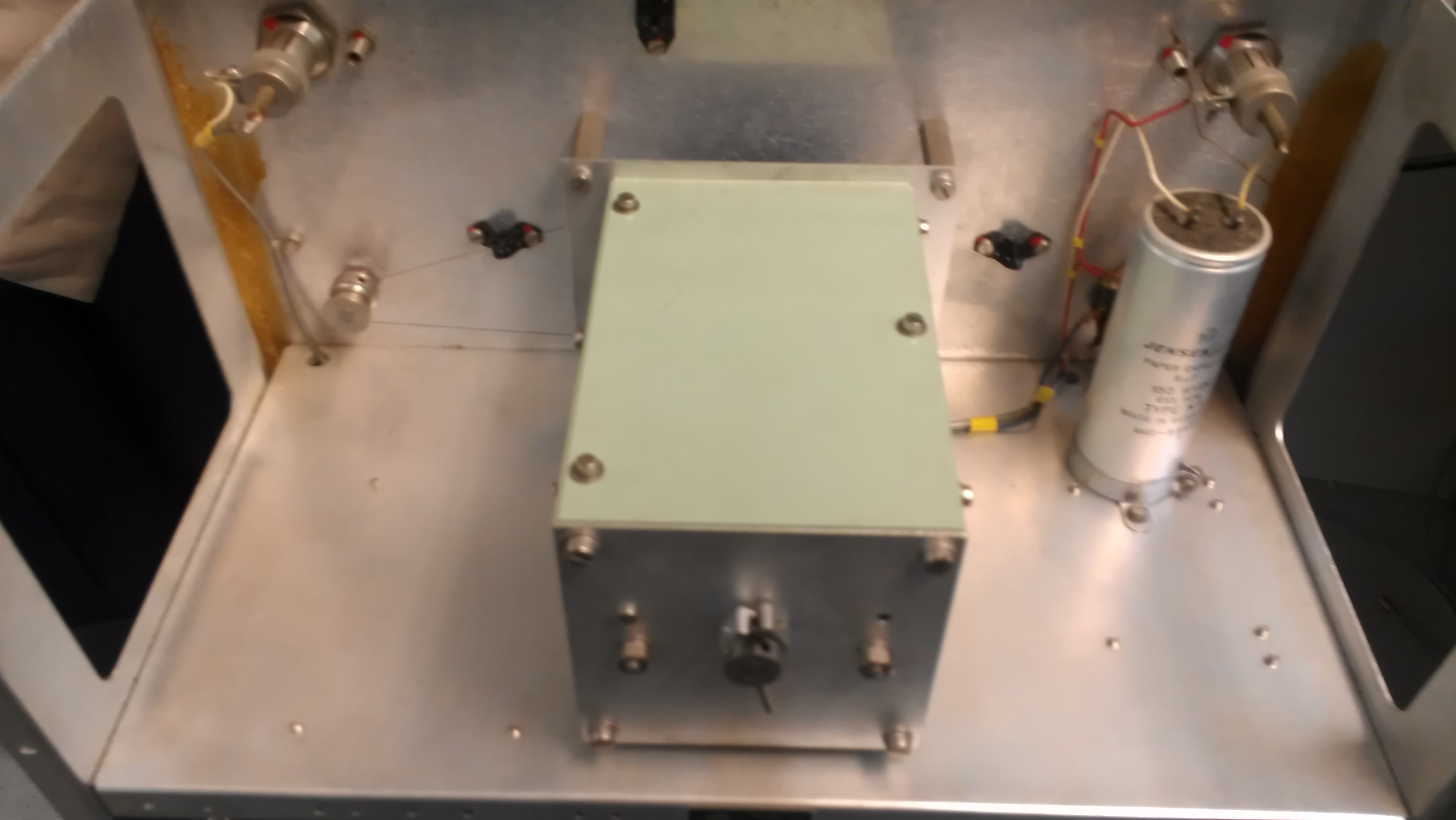

B&K 1607 Internal view
Here are some pictures of what is inside the B&K. Tracing this won't be so easy especially with the really high grade construction.
The box is the housing for the tuning pot. The panels are plastic, probably to minimize external capacitance. All of the tuning caps are polystyrene, the input cap is paper (8 uF).
I'll do a little probing to see if I can figure out the harmonic compensation trick.
