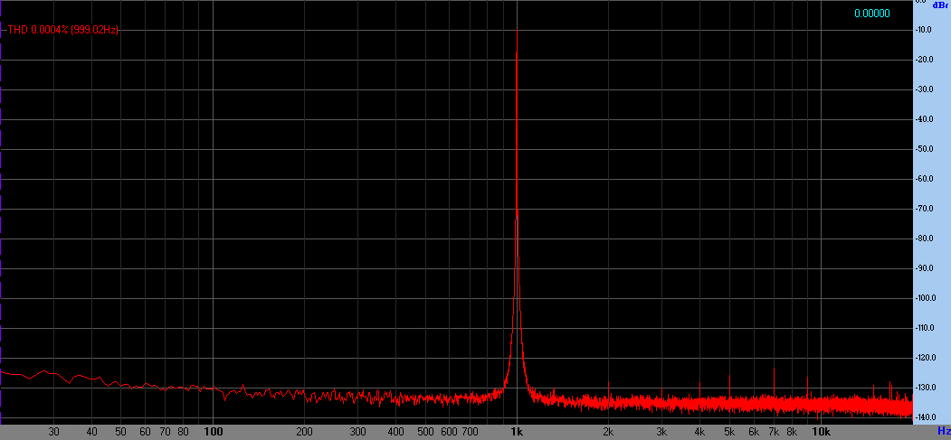

Victors's 1KHz board spectrum.
Battery powered (4*9V), shield only small aluminum enclosure (cost ten bucks, installation about 3/4 hour handwork :) ), M-audio Transit USB ADC, Visual analyser run on laptop.

Definitely limited by your sound card at this point, but the response looks impressive (the card, not the oscillator) in comparison to my M-Audio ProFire 610.
The only way to really see what Victor's oscillator can do is to notch it.
