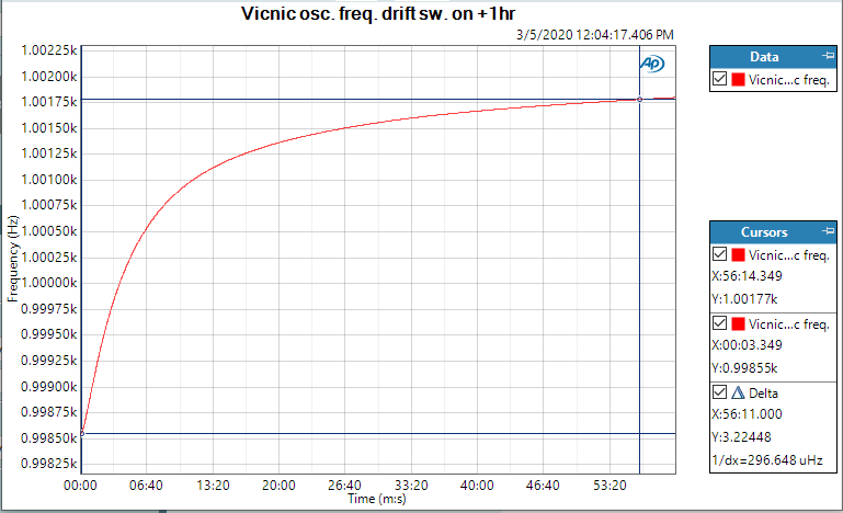

A 1M FFT at 48kHz takes 20 secs to gather 1M samples, while having bin of 0.048Hz. Does a freewheeling analog oscillator stay stable within 0.048Hz for 20s, or is the incoming signal split into short chunks and the resampling ratio changes/gets updated very often, many times within single FFT run?
Thanks for explaining.

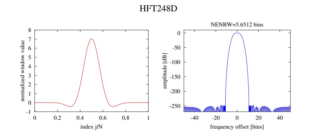

In my Linear Audio article I referenced a paper with some new flat top windows with extremely low spectral leakage. In the end it's the spectral leakage that defeats the ability to average out the noise, if you think about it the spectral leakage is energy from the measured frequency not the noise, flat top windows sacrifice frequency resolution for lower sidebands.
Here's an example. You don't care about the exact frequency but are only interested in averaging out random noise. This window has -248dB leakage and the input oscillator only needs to be +- 0.5 bin over the measurement period so averaging of a series of time records should achieve the desired effect. I'm a little strapped for time but I could run a simulation of this.
This is trivial to put into Matlab or any other similar program.
That is very useful, but will an analog oscillator stay within +/-0.5 bin for longer FFT time (hence smaller bin)?
The point is you don't need absolute frequency resolution to measure the THD. There is a tradeoff between longer FFT's and more short FFT's averaged. There is no free lunch, flat top windows have a wider equivalent noise BW i.e. more averages.
