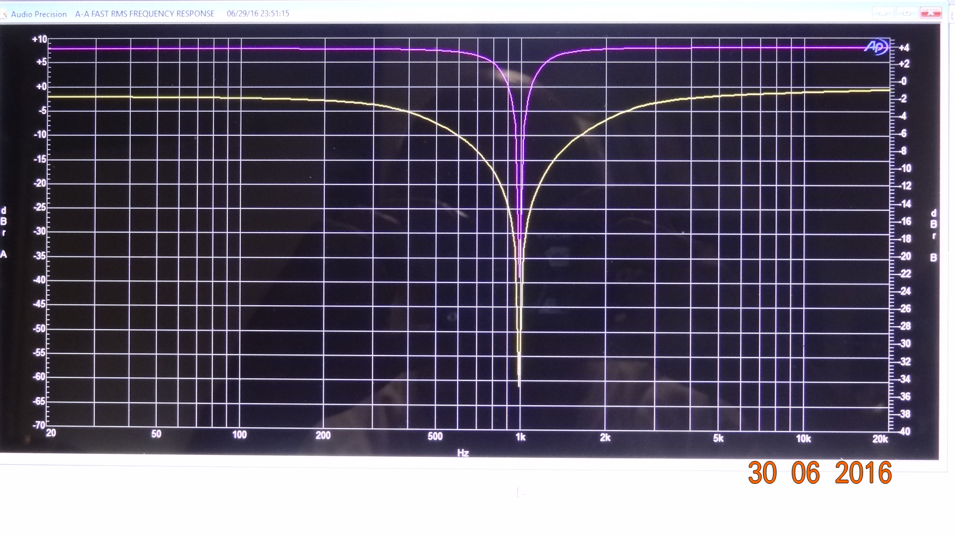

Passive vs active notch (I made it 4 years ago). offset for clarity.
Does 2 or 3 notch filters at or near same freq, sharpen up the slopes/Q?

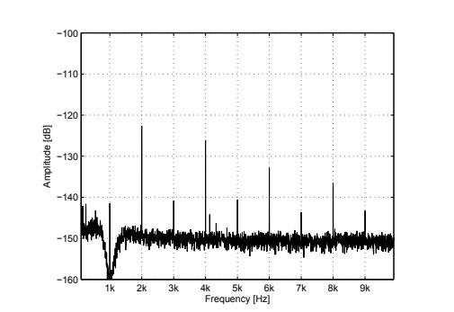

An example. There is a very slight rise in noise at low freq but that is just the DUT (it could also be close in sidebands on the fundamental). Nothing but an active notch or software correction can do this.
EDIT - I might be wrong, i wish he was still posting here.
Disabled Account
Joined 2012
Thats looks just like a ShibaSoku 725 distortion analyzer. same as I have.
i know it from the timing leakage spikes at 140-145
There is a long unshielded pcb trace to the monitor output and it picks up those spikes (freq).
Also the -160dbv notch is same. Yes, it is from an active triple notch system.

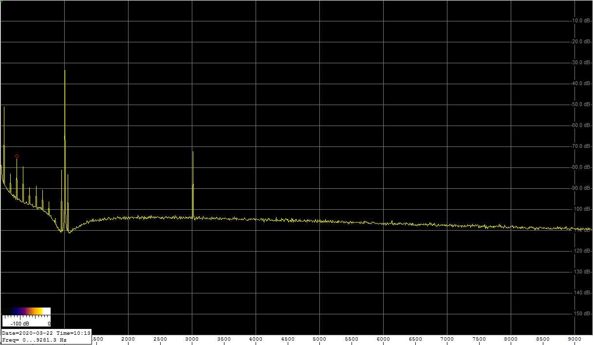

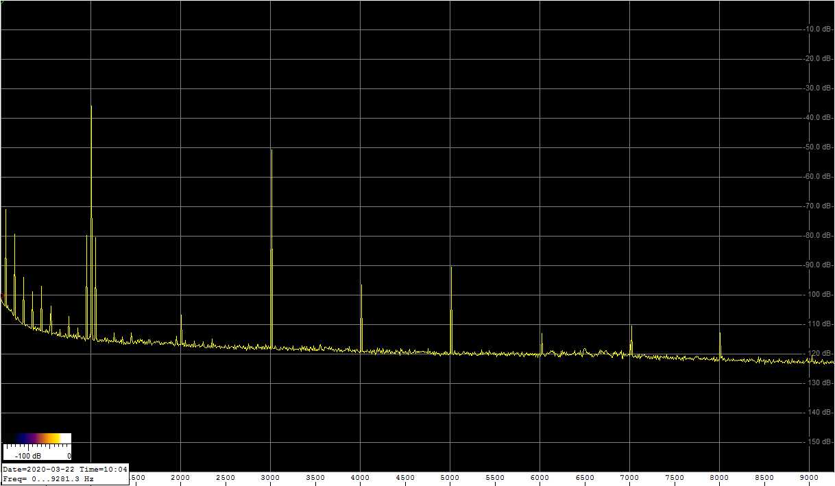

I remeasured now the 1kHz LP filter at the output of a cheap oscillator from ebay:
Low-distortion Audio-range Oscillator
using passive notch filter and an LNA.
I couldn't obtain the performance of this oscillator as it was then - I haven't touched it for more than three years, and I forgot the tweaks I made then. However, this is not very important now because the question was whether an active filter with an extremely linear op-amp can attenuate oscillator's higher harmonics without introducing additional distortion.
The spectrum shown on the first graph was obtained with an adjustable, Hall-topology passive notch filter (PCB by S. Groner), and an LNA by S. Wurcer (gain 60dB). The fundamental was at -6dBFS, so accounting for the notch filter gain at 3kHz (-6dB) and the LNA gain, the 3rd is at -98dBc.
The second attachment shows the spectrum with the LP filter inserted between the oscillator output and the notch filter input. The 2nd harmonic is not visible, and the 3rd is attenuated by 22dB, as the theory predicts for the filter realization used.
The rest of the spectrum is clean, but the filter added about 10dB to the noise floor.
I tried also AD797 in the filter, but it seems to be oscillating at about 40MHz, so I must first take care of that.
So to the extent of my measurement setup, an LP filter at the oscillator output seems to attenuate higher harmonics without creating extra distortion, provided that the op-amp used has extremely low distortion.

The Hall notch is only about -60 depth. Also with a buffer (X1) on the output, you have the distortion of the opamp as a follower. Low but could be better with a different topology.
The output is minus the fundamental so the buffer op-amp distortion does not matter. The Hall notch has similar skirts since all these R/C notch filters rely on vectorial subtraction not resonance.
But Scott, I thought Braca inserted the opamp/LPF at the oscillator output, so would see the full output. No?
Jan
Correct, Jan.
The chain was oscillator => active LP filter => notch filter => LNA => sound card.
The filter topology I used has not been explicitly analyzed by Bonello, I merely followed the recommendation of Groner & Polak to use the inverting input of their composite op-amp, hence the Multiple Feedback Toplogy (MFB).
Can post the schematic if there is interest - no big deal, I used the old TI/BB filter design tool to match the resistor values to the capacitors I have in stock.
