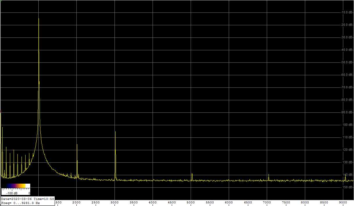

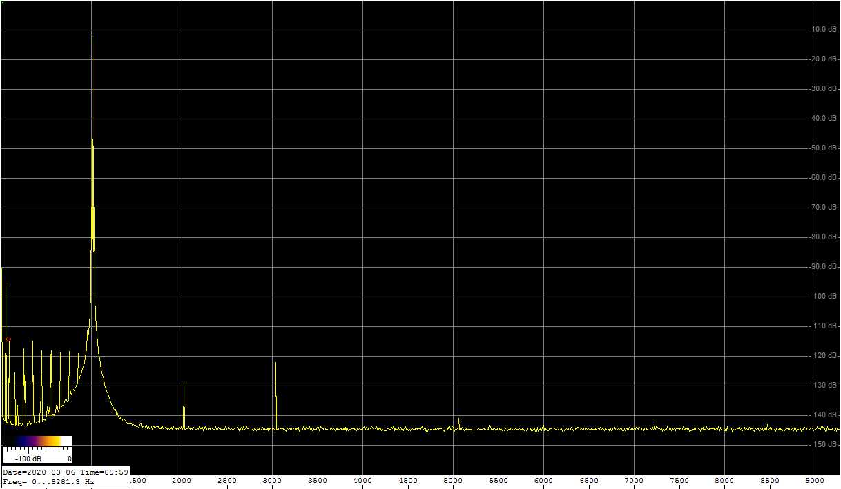

As a proof of concept, I made a test with a single-stage LP filter at the output of a simple, lamp-stabilized Wien bridge oscillator.
Since the passband ripple is of no consequence, one can trade the ripple for the filter steepness, so I used the Chebyshev topology with a passband ripple of 3dB. The simulation gives me an attenuation of approx. 14dB at the 2nd, and 21db at the 3rd harmonic.
The filter was realized in the MFB topology, with polystyrene capacitors and normal quality resistors.
I did this in another forum, and I'm repeating the results here for convenience.
The first spectrum shows the oscillator harmonics in the as-is version, and on the second one (LP filter in) the 2nd is lower by 14dB, and the 3rd by 17dB. Although it seems that the filter potential of 21db attenuation at the 3rd has not been fully realized, it is also the level where the THD of my audio interface comes into play.
Note that the right part of the fundamental freq. skirt in the spectrum is less wide with filter.
The op-amp used for the measurements shown was OPA627. However, I also used the Groner/Polak composite op-amp in the filter (thanks for the adapter PCB, Jan
), but the results did not change.
Braca

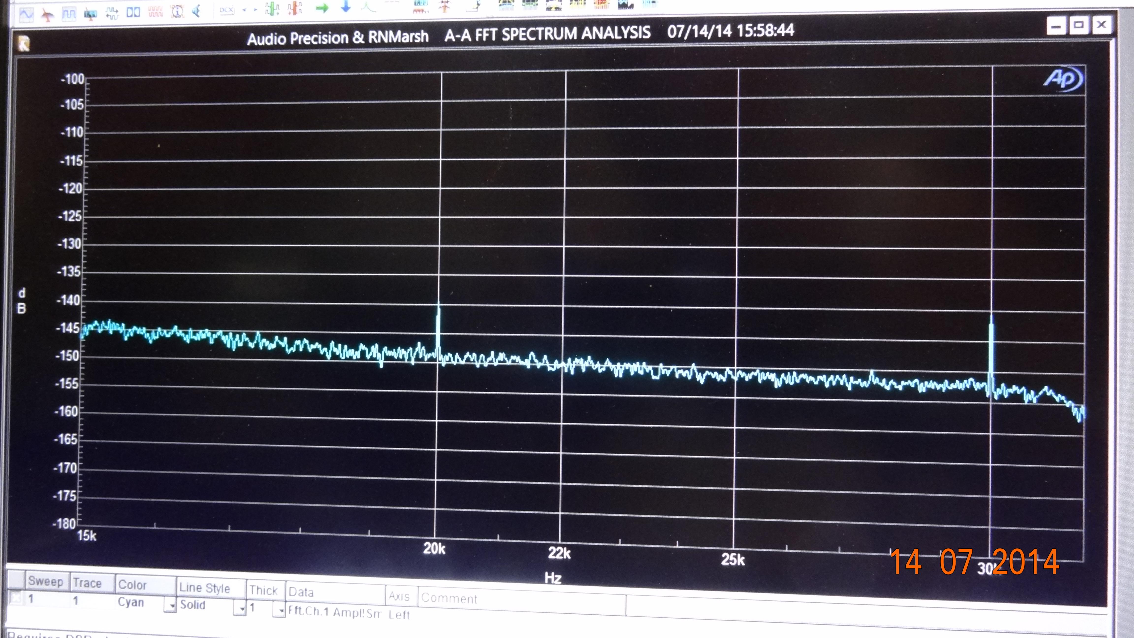

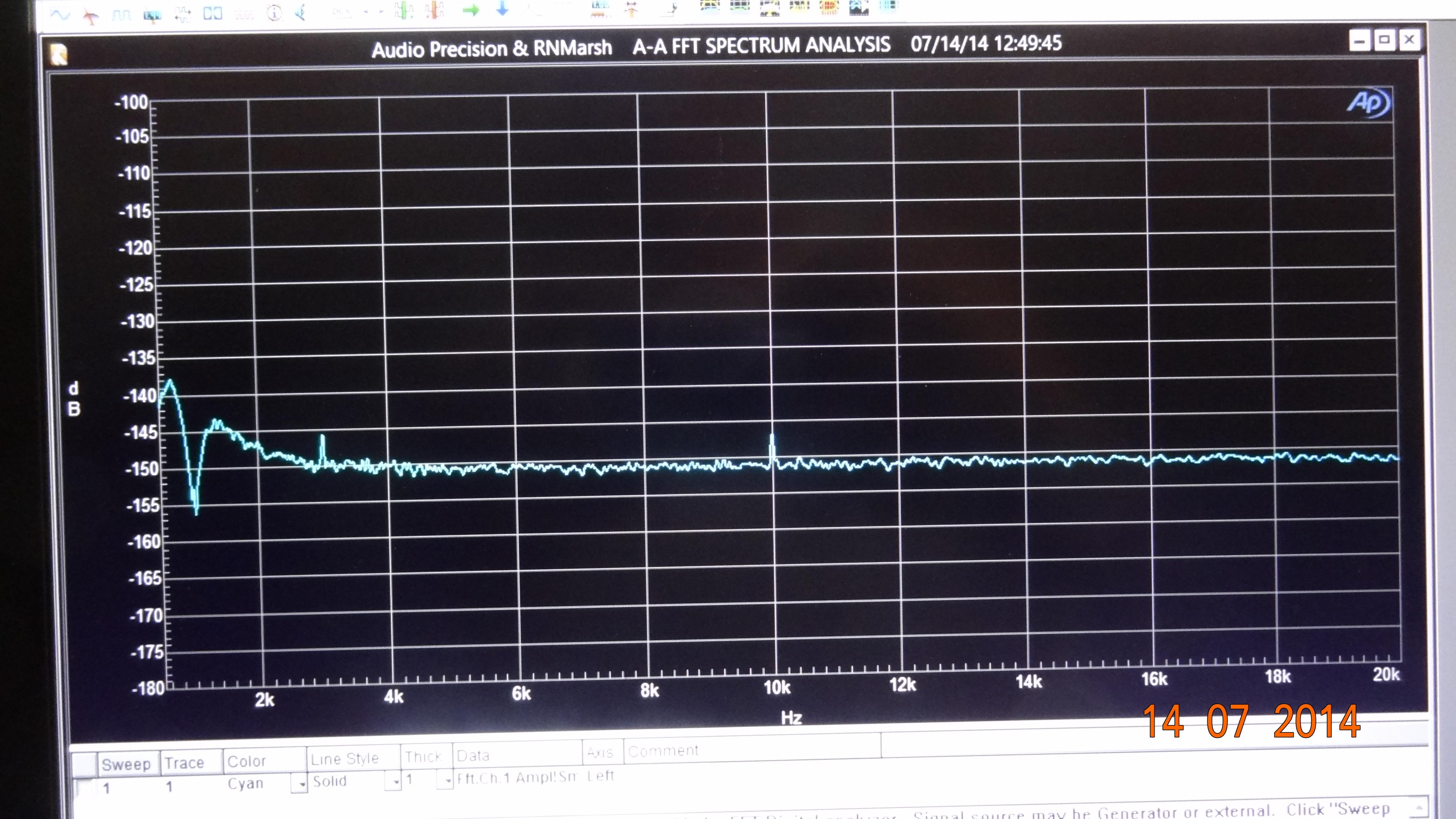

Here is David's osc at 10KHz .. 1.5KHz is better
THx-RNMarsh
View attachment dlbSVO V5 SCH Sheet 1.pdf
View attachment dlbSVO V5 SCH Sheet 2.pdf
View attachment dlbSVO V5 SCH Sheet 3.pdf
View attachment dlbSVO V5 SCH Sheet 4.pdf
![David-10KHz.jpg David-10KHz.jpg](https://www.diyaudio.com/community/data/attachments/755/755575-6cbe7557fc0348e28bc2f960285cd72f.jpg)
![David osc - 1KHz.jpg David osc - 1KHz.jpg](https://www.diyaudio.com/community/data/attachments/755/755602-8a312b536877e5c08cdd4ae7b9d90eb7.jpg)
THx-RNMarsh
