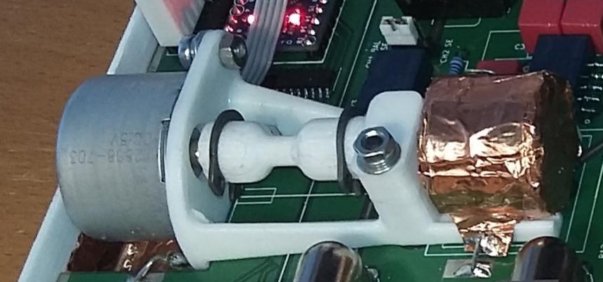

Yes, most likely nothing complicated. A $2 10-turn 5K pot attenuator adjusts to +/- 0.002dB level with a $2 geared stepper, resolution limited by number of wire wounds per revolution inside the pot. Several concurrently running steppers easily controlled by $2 arduino. Works very good, would work good in this device too.

I have been through that too. Practical manual control requires coarse and fine elements, because manual adjustment with a single high-resolution control is tedious and boring. But having 2400 steps per revolution controlled automatically may create a different situation.
Should anyone go for it, I offer STLs for the stepper-pot assembly including the axes coupler. Snap rings are 30pcs per dollar in local hardware store.

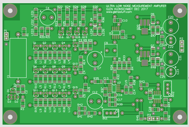

The complete schematics of Glen's analyzer can be found here:
An Audio T.H.D. Analyser
There are also links to the Gerber files, but they are dysfunctional.
I hope not to have broken any law by posting the above link.
Braca
Glen is a seriously capable designer - pity he left. I’ve hunted around on the web but can find no trace of him. Thanks for digging this up BTW. I’ve book marked it - there’s a lot to learn reading through it.

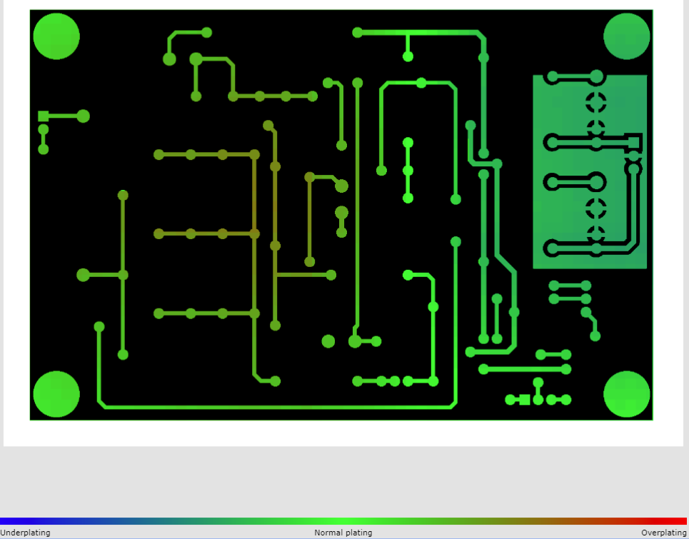

The PCB Gerber set throws an error. Apparently Glen designed it for his outline milling machine. There seem to be non-standard Gerber files. I'll see if I can rescue it.
Edit: you need to turn off 'controlled impedance' in your CAD as that was set to ON but is not available on 2-layer boards. After that, no errors. Is manufacturable, with some possible overplating on the bottom side due to the large difference in copper cover between the top and bottom layers..
