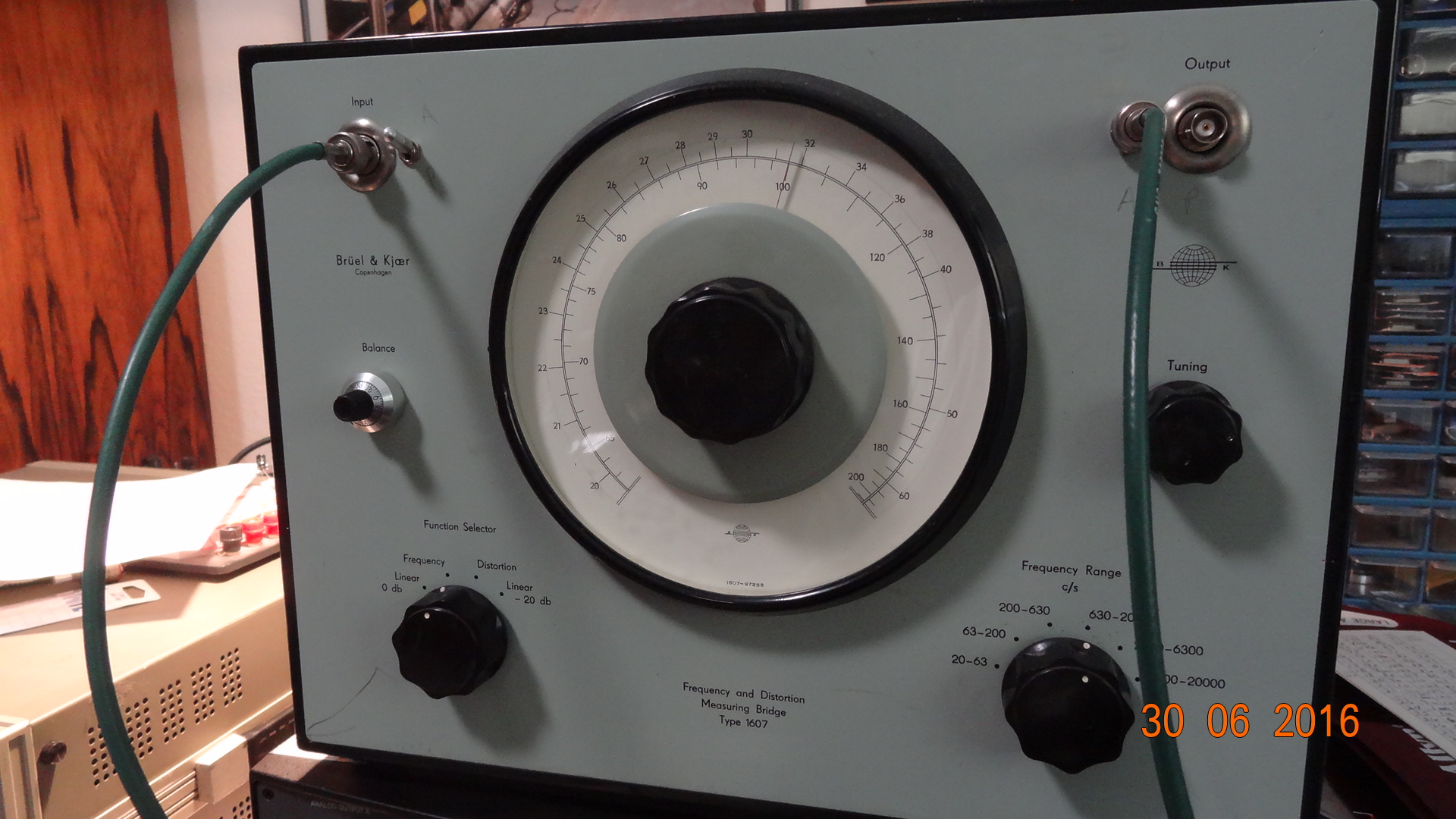

----- ultra low distortion sources.... LPF and Notch filters?
To get lower distortion sources..... one way I suggested 4-5 years ago was a LPF and also a notch filter to eliminate the 2H and/or 3H. I have tried both ways. IMO-- That requires an auto-tune notch IMO. Ditto, for the Cordell Distortion magnifier for measuring.
If you followed the 339 mods, you saw me use a passive variable freq notch filter, modified with active Q enhancement for that purpose. but it was manually tuned also.
Remember this? In my mind, its all related... notch filters. manual vs auto-tune.... whether to improve measurements or to improve the source'
