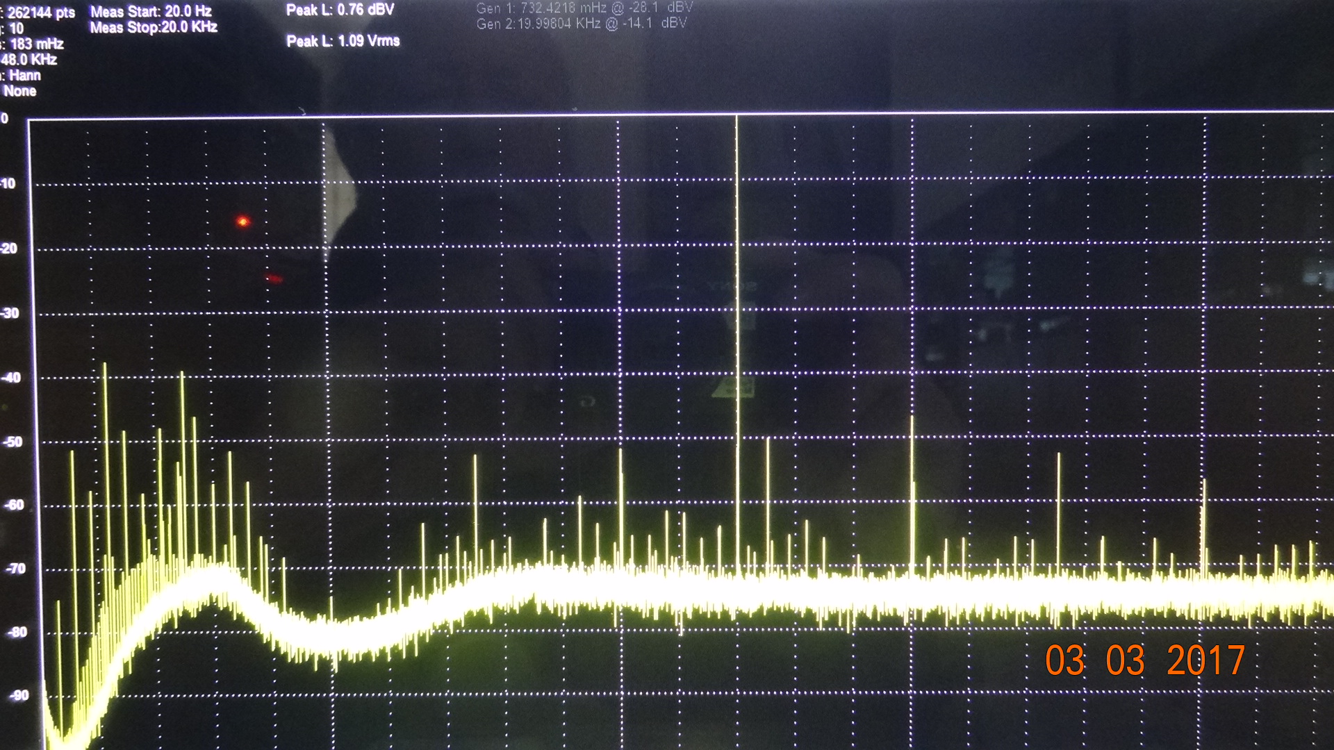

As I said before, I supported his work in spirit, direction and financially. Though I had Victors gen.... I didnt want to buy several of them and asked david if he would like to work on one that I could choose any freq I wanted via software interface (USB).
So, I have one completed unit. Here is David's harmonics..... a bit noisy environment but it is very low level ....
However, this also shows a low level calibration tone added at exactly -100dbv of higher freq to the gen signal. The analyzer locks onto the higher level fundamental tone, only. So, zero on the screen is -100. I have fiddled with internal control/trim pots and get typically -145 for harmonics.
With David's suggestion it could be lower. -160 could be possible.
GUI Software control is done also.
THx-RNMarsh
![-100 CAL signal.jpg -100 CAL signal.jpg](https://www.diyaudio.com/community/data/attachments/756/756484-df378d408022a2b19826f7603df252fa.jpg)
THx-RNMarsh
