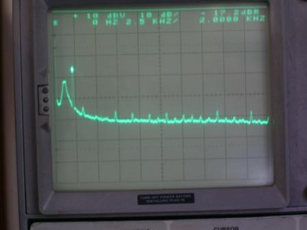

I am attaching the distortion residuals from both the internal oscillator in the Boonton and the KH4400. These are FFT's of the output of the Boonton analyzer
Boonton:
I have never been able to get any of my Boontons below .0007%. I believe its a noise limit more than anything else. I have also noticed that its possible for the measurement routine to "lockup" and require a restart (press the local button to reset the system)
Boonton:

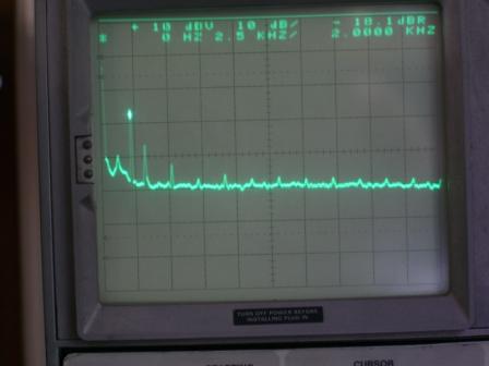

Here is the KH4400 (I haven't figured out how to attach two images to one post yet.)
Both read .0008% THD w/ 30 KHz low pass filtering, using inverting input and all of the other tricks I have figured out for lowest readings.
The display is 0-25KHz and the marker is at 2 KHz.
Krohn Hite:
Krohn Hite:
