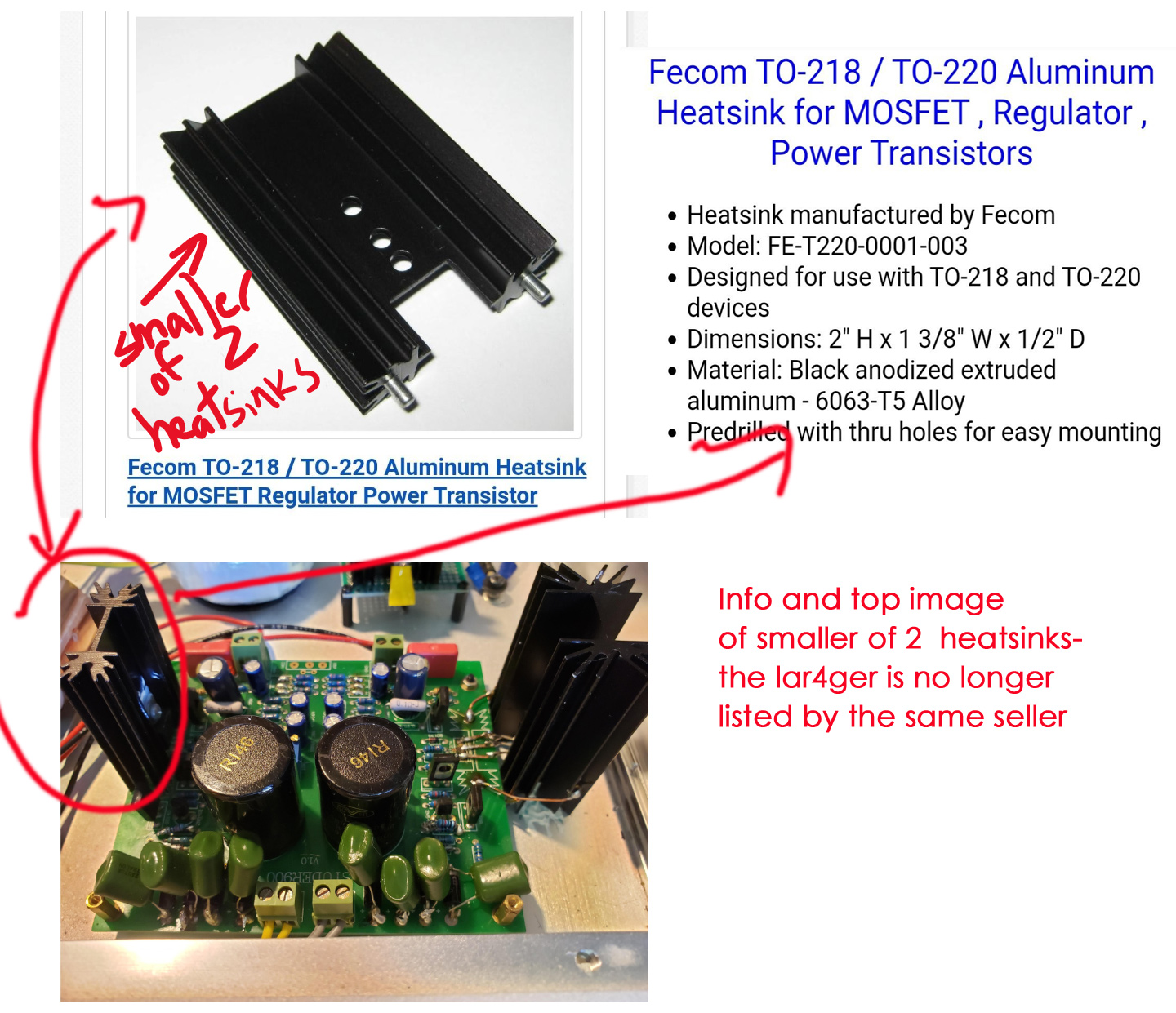

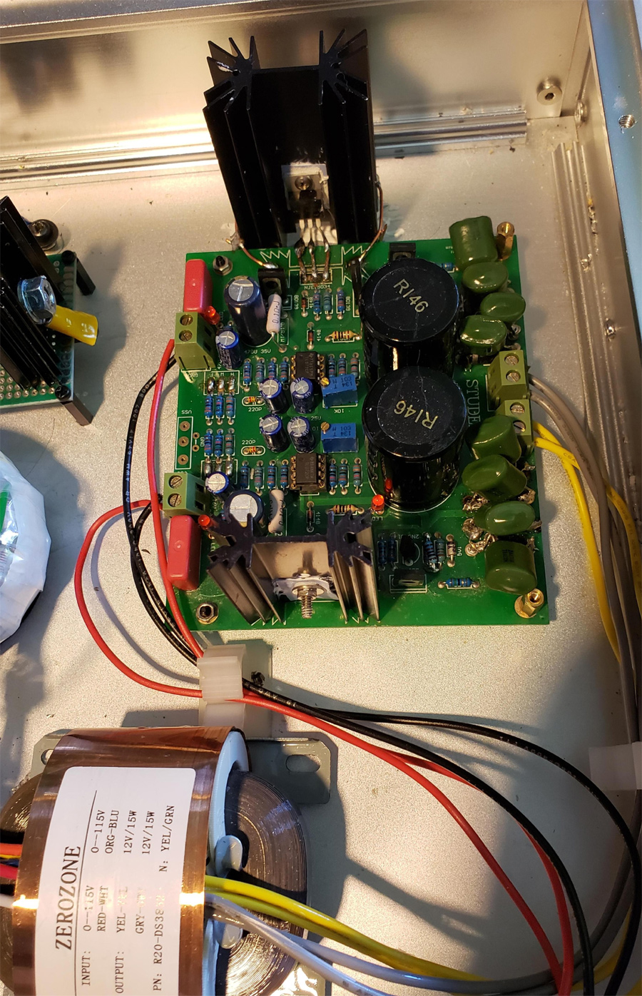

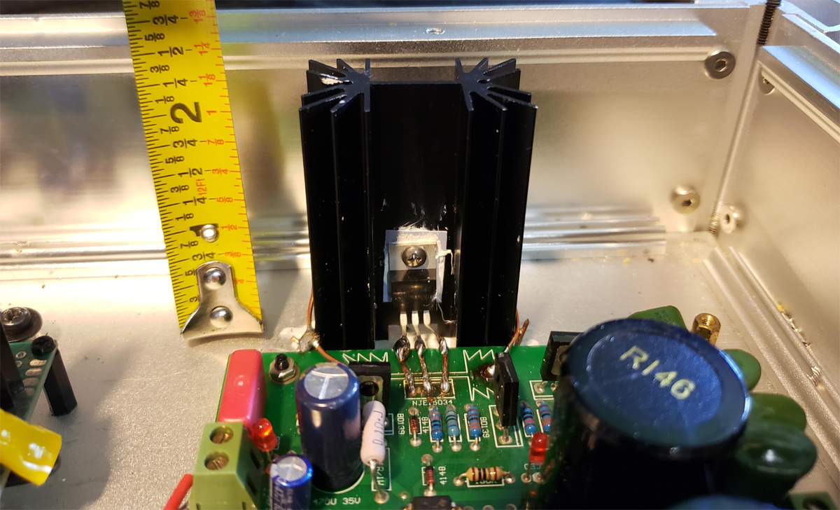

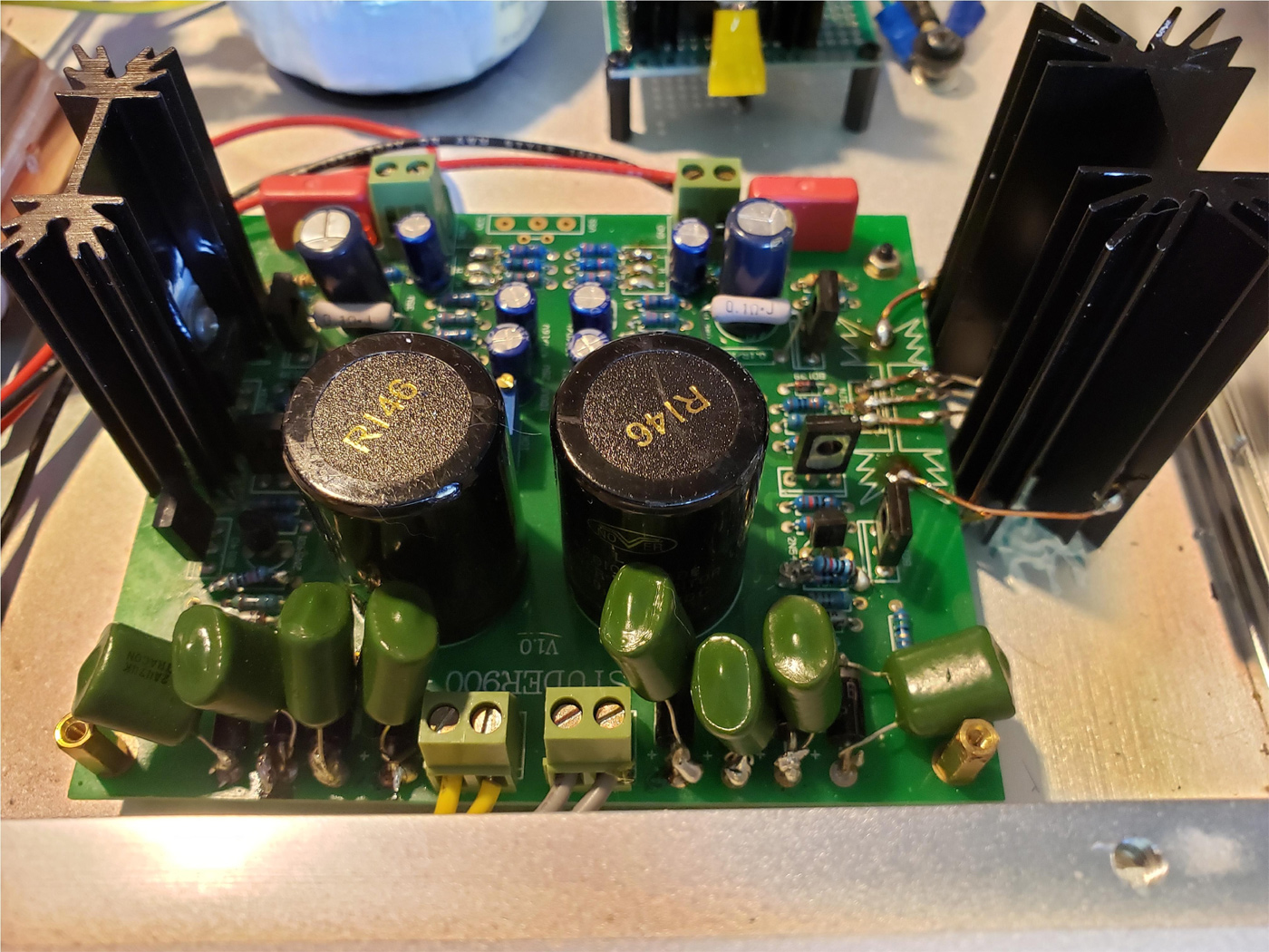

Successful (so far) Raspberry Pi 4 power via modified "Studer 900" kit
I am powering a Raspberry Pi 4 running Volumio with the Studer 900 kit successfully... so far.
I post this not as a recommendation but simply sharing what is working for me. Don't try this at home. If anyone with more expertise wants to chime in with a critique or enhancement, please do so.
If you are considering trying this, I suggest getting validation from an expert or 2 first if you are not one yourself.
1. The limiting resistor value is .1 ohm, which is how the kit was supplied.
2. I modified it otherwise as per the very helpful suggestions by bbucher in this thread. ... with the exception of eliminating the diodes. which I left in place as plenty of current is available without that mod.
3. The R-Core Transformer with 2x12v secondaries is a ZeroZone purchased on eBay.
4. The 2.5" tall much larger heatsink is the perfect height to create a tight seal with the aluminum enclosure from eBay.... both of those items are no longer available from the links I purchased from but I assume you could find them with the images I attached as a reference.
5. I replaced both heatsinks...
5a. one with a 2" high heatsink that was still 30% larger than the original. This is on the side that powers a MiniSharc at 5v successfully... it barely gets warm in use.
5b. the side that powers the Raspberry Pi 4 uses a heatsink that is too large to fit on the board, so I extended the transistor legs by soldering to 18g solid copper wire. I also used copper wire to mechanically attach it to the board.
5c. With the heatsink just off the side of the board hanging on like a capsized drunk sailor to a raft, it is the perfect height to make a firm connection to the aluminum enclosure top and bottom. I drilled 2 holes in the enclosure below for its legs and "soldered" it in. When the top is screwed down, the torque required implies a pretty good seal.
5d. The original heatsinks were "hot" with voltage as the kit was supplied. So, for both, I used an insulator kit and confirmed electrical isolation with a multimeter. I used thermal compound where the transistor connects to the heat sink (via the insulator gasket) and on the bottom where it contacts the enclosure. I doubt the thermal conductivity between surfaces is ideal, but it does the job.
Used as such, the heatsink gets warm but not hot. I can keep my finger on it indefinitely.

Hope to see your heatsink temp monitoring system result soon. For the mean time, can you take a reading of the heatsink/case top contact point temperature with an IR thermometer?
Have you consider bolting the MJE15034 to the aluminum case bottom directly to get better heatsink effect? You seem to have enough space for that in your picture.
I considered it and would possibly have done so as the next step had what I did not worked so well.
I’ll loop back with the heat sink monitoring feedback via the chip+ Arduino ASAP - thanks for the encouragement. I don’t have an IR thermometer currently, though.
That larger heat sink was barely warm to the touch powering the Pi 4, so that subjective feedback gave me enough confidence to press on. That was NOT the case using the other side of the board, with its smaller (But larger than original) heat sink, to power the Pi 4. It got too hot to touch within a minute, at which point I shut things down. That size heat sink works fine powering the lower-current-needs MiniSharc, though.
Chris
Heat sink clamped to enclosure
....I also want to emphasize that I suspect it’s largely due to the fact that the larger heat sink is the perfect size to get firmly clamped between the top and bottom of the enclosure .... and thus pass along some heat to the aluminum enclosure .... that is making it seemingly so effective at shedding heat.
As I mentioned earlier, I helped that a bit with thermal compound between the heat sink and the bottom of the enclosure. Given how often I take off the lid currently, I did not add between the hs and the top...and it doesn’t seem I need to.
Another point is that I made sure the heat sink was electrically isolated properly as well to reduce shock risks.

Yes, you have done the right thing. Aluminum is a very good conductor. The large heatsink passes the heat to the box effectively, then to outside air. The large heatsink by itself will not be effective at all due to the very low natural convection film coefficient from the heatsink to air inside the box which will make the heatsink to get very hot quickly.....I also want to emphasize that I suspect it’s largely due to the fact that the larger heat sink is the perfect size to get firmly clamped between the top and bottom of the enclosure .... and thus pass along some heat to the aluminum enclosure .... that is making it seemingly so effective at shedding heat.

Making sure the heat sink to be electrically isolated properly is very important too. Congratulation to your success.
