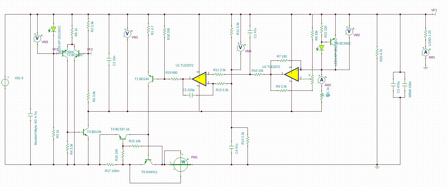

Hello All,
I am playing with this Regulator for my NanoPi M4 Music Server that require 5V4A power source (with storage module), base on the detail explain by bButcher, I can have the expected result in simulation with some tweaks, But I do not have electronic background therefore I would be nice if someone help me to validate some of my thoughts as:
1. I use TLE2072 as replacement for TL072, It should be better as TLE2072 is Direct Upgrades to TL072 as in datasheet statement? This is high speed opamp, I wonder if I need some special layout with capacitor between supply rails or just 100uF capacitor as the chinese kit is enough?
2. I use the GLED431 for voltage reference, As I understand the GLED431 using LED + Vbe for 2.5V voltage reference and Moreover, GLED431 established the CCS for LED so that It is much better than simple LED as voltage reference?
3. For the op-amp supply power, I re-config by using the LTP for better noise filter, Is It worth in this PSU?
4. For the 5V4A requirements, It seem that I need a transformer 6.3VAC@5A that is 9VDC and then for 5V4A, the power dissipation will be 16W ( or 14.4W as in simulation), It mean that I need heat sink with capability at least 1K/W for 14.4°C above the environment temperature ?
I attached my TINA-TI simulation file and screenshot of the results!
Thank in advance!

I re-post the pictures:

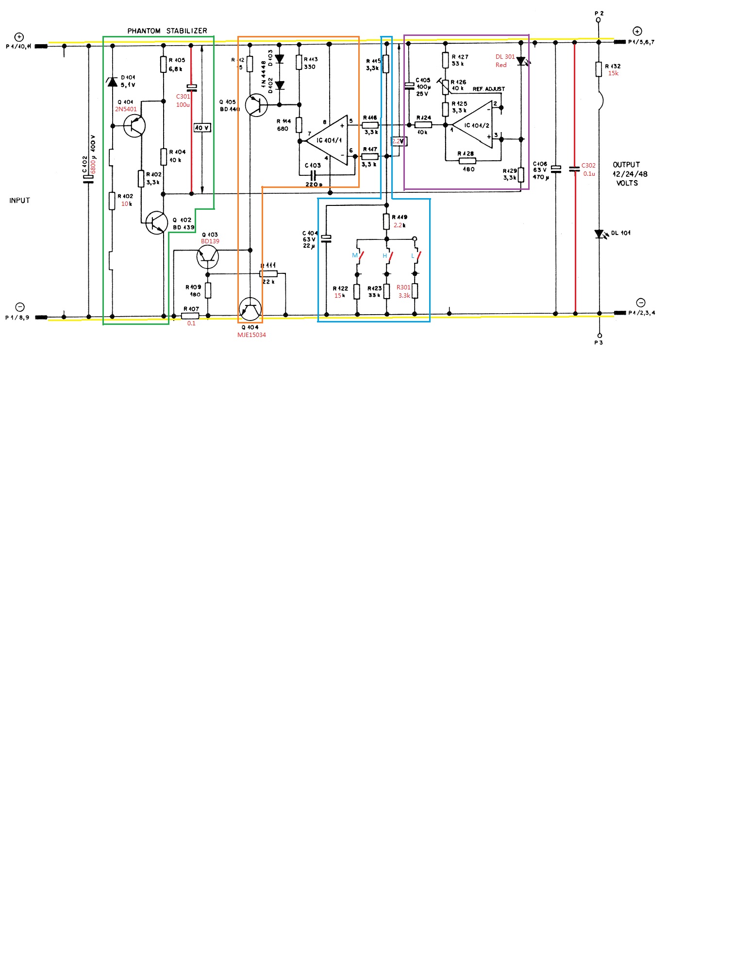

hi, I'm happy to see your schematics and tweaks,..but on my studer900 board some pins of bc140 are mixed up,....pins 1 and 2 (emitter/collector) are mixed up!!!,
on the Chinese board those pins are not consistent with your schematics!,...can you have a look at your board and confirm the mistake?
thank you.
best.

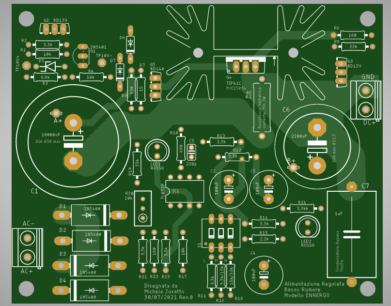

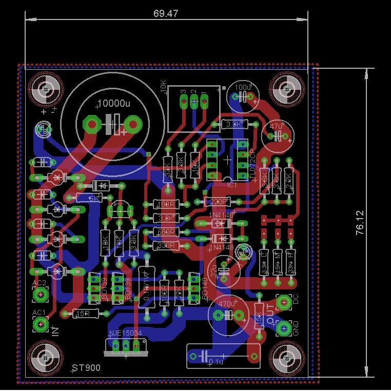

Hello I have used this PCB for my Replica Borbely MC Pre Phono.
I have tweaked it with some good components and put wire for the High current line.
It is very silent.
Since it works good I have redesigned the board keeping in mind, place for bigger Eletrolytics and bigger traces.
Next time I will try Some modification you suggested.

Good on you, and done on the same board size! Did you get better results in modelling and better results when you built it?
I notice some of the high current traces in the lower layer don't seem to have much clearance from traces next to them.
It is almost the same board size. I have not yet bulit it, because I am on holiday.
It should work fine , because one big problem were the thin copper lines and I had always to put wire point to point.
I cannot measure anything about noise. When I will try I will post something. Clearance is 12 mil.

Max current
I have tried today to verfy the maximum current this circuit can deliver.
So I have set up the output voltage to 18 VDC.
POwer transformer is a 100VA dual 15AC with max 3.33 A for both secodary pair.
I have removed R111 to not limit Vce of the power bjt Q104 ( in my case TIP31C Ic max 3 A).
Then I have shorted R109 .
The BD140 (Q105) which control the base of Q104 has two diodes with limit its Vbe. I have removed one of them.
Well with 50W Load resistor 8.2 Ohm and 18VDC I expected 2.19A...but the regulator could rech just ca 15V...and the BD140 was getting very hot. I have turned of the circuit otherwise it would have been burnt.
This BJT schould pump current in the base of the power BJT.... but it can´t and it becomes very hot...
I do not understand what is happening. can someone help?
The limit resistor is 0.22 Ohm
I would reach 4 A of course with a D44H11... but there is this limitation which I do not understand. Thanks

Your scheme looks different from the design posted before. Any reason why?

You need t remove teh 1N4148 diode otherwise is the base current of BD140 limited and it cannot open the MJE15034 any more.
At the same time you had to remove the block on the Vce of the MJE15034:
short R109 and open R111.
You will reach 2 A without any difficulties.
