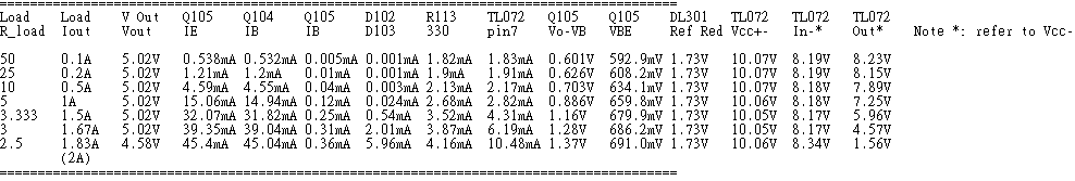

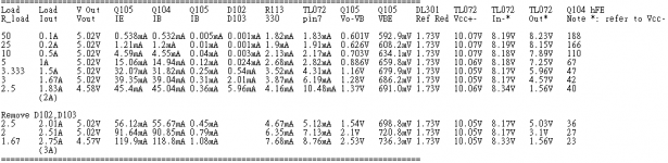

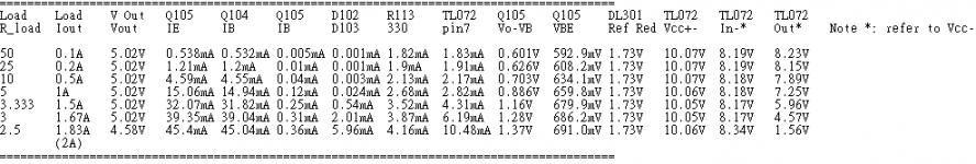

(4) About the maximal current it can supply, with some simulation (thanks to fabio1068 for the tina model)
From the simulation, the circuit start to fail between 1.67A to 1.83A. I'll suggest use it to drive at most 1.5A "peak" load.

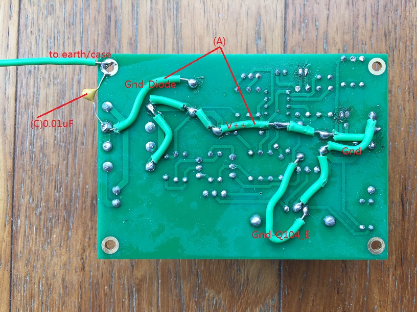

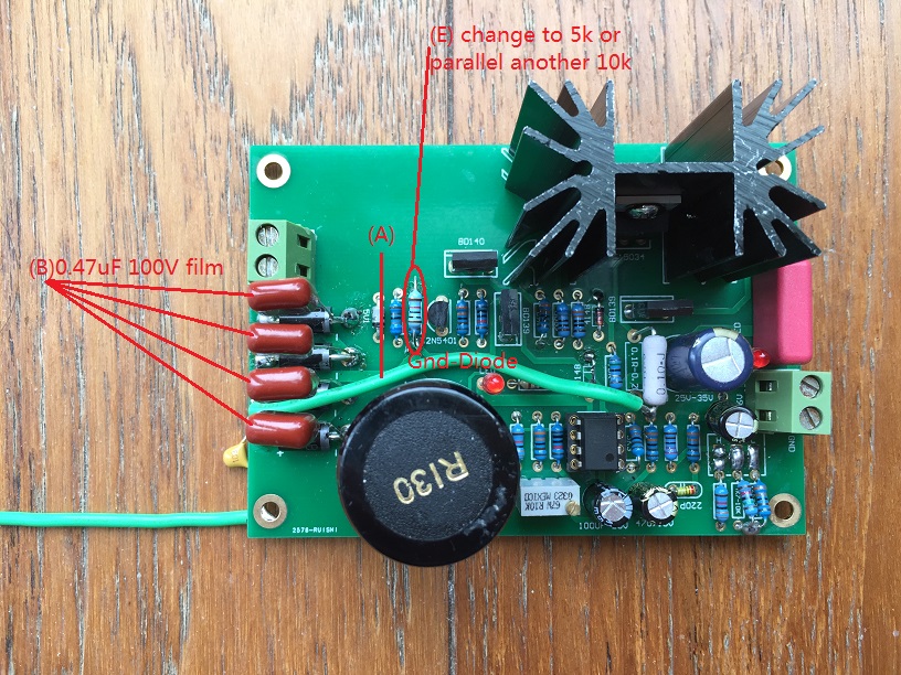

(6) The modifications I made on the board:
(A) The layout of the board is pretty bad, the measured resistance between input (right after rectifier diode) and output terminal (Vout) is around 14 mOhm, so I strengthen both power lines (yellow marked lines in the circuit diagram) with solid wires.
(B) Add 0.47u caps across the 4 input rectifier diodes.
(C) Earth the input ground (p1/8,9 in the circuit diagram) with a 0.01u cap.
(D) Use a line filter before the transformer.
(E) Change R102 from 10k to 5k. This is not about reducing noise, more about put 5.1V zener at proper operating point (~1.5mA), especially when drive the board with 9V AC.
The above is what I have done so far, hope my experience can help others.

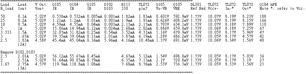

Regarding to 1.5A limitation, with further investigation one can see it is because D102, D103 serve as limiter, so the circuit is designed to maximally provide 1.5A output current.
With D102 & D103 removed and continue the simulation, now the circuit can provide up to 2.5A and fail again before 3A.

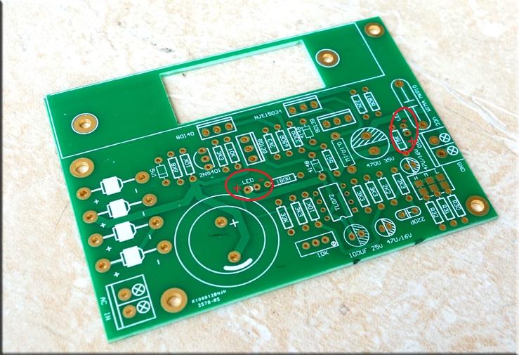

bButcher can post picture of your board top and bottom? (I'm not electronic engineer) and have some difficulties with reading and understanding electronical schematics.
I'm preparing to soldiering now and it would be very helpful to apply your upgrades on board I wil soldier.

Thx for pictures bButcher it will help me a lot
Can you clarify to me how to soldier led I don't understand marking on PCB (probably that's why my first one it's broken).
@ kotlarix
Can't open your picture. But usually the led pin out is like this: Electronics 2000 | Pin-outs | LEDs, the longer pin is +. Even you install it the wrong way, it should not burn the whole module, just remove it and correct it.
