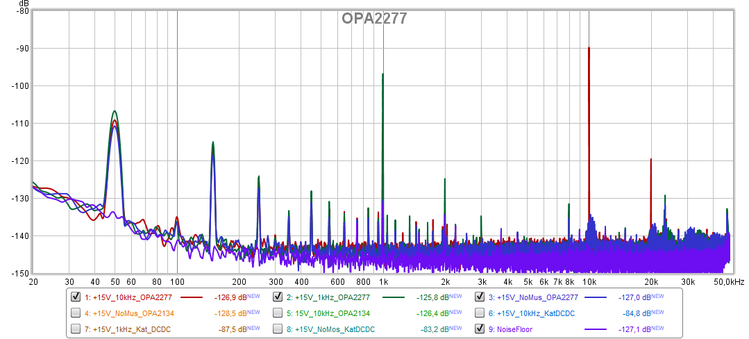

Hello,

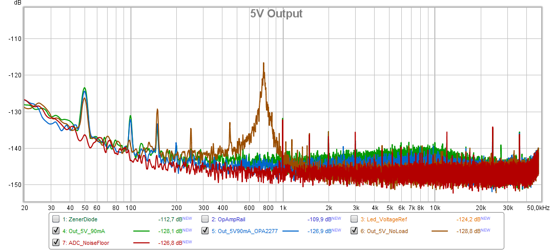

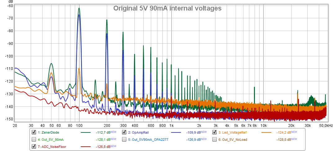

I did some measure of the ripple/noise of this regulator @5V output.
I do not have a professional measurement equipment, so I used my usb soundcard.
It is a Creative X-fi HD, modified as suggested here: Improving A/D perfromance of Sound Balster X-fi Music (SB1240) - and a Puzzle!!! - diyAudio
And I changed the coupling capacitor voltage to 35V.
I measured the voltage at different points of the circuit with 55ohm load at 5V (so 90mA) and at the output with no load, 90mA load, and 90mA load changing the opamp with a OPA2277. I also tried a OPA2134, but it did not behaved well, I think because the input is too close to the positive rail (only 1.9V, the voltage reference led).
In attachment you find the REW file and some screenshots.
The images are the spectrum @96kHz sampling, FFT length=65536, average of 16 measures.
The 0dB of the ADC is 0.74Vrms, so they are dBu, more or less.
but the unit of the spectrum is not exactly dBu/sqrt(Hz).
Here after the RMS values in dBC:
(I write the dBC because the ADC has some high noise below 20Hz, so I think it is more meaningful than dBFS)
ADC noise floor -112.4 dBC
ZenerDiode -61.7
OPampRail -67.4
Led_Reference_Voltage -103
Output_5V_NoLoad -106.4
Output_5V_90mA -108.7
Output_5V_90mA_OPA2277 -110.3
So, if we consider the best measure at the output (-110.3 dBC) as dBu, it means more or less 2.4uV.
What do you think about the peak at 750Hz in the spectrum of the output with no load? It looks like, when the load is applied, it goes down and moves to higher frequencies, but it does not disappear completely

OPA2277 may have lower noise than TL072, but it is a little bit too slow to track fast change output load, (0.8V/uS slew rate, 1MHz GBW, compared to 13V/uS, 3MHz of TL072) so if you apply to real load I will expect TL072 will perform better than OPA2277 overall.
Noise wise, it is very impressive. Don't know how its output impedance measured?
I did some simulation before, it didn't quite match your measured data. The feedback loop of error op did generate noise chart similar to your graph, but the peak value & frequency is very different. and it do move around with load.What do you think about the peak at 750Hz in the spectrum of the output with no load? It looks like, when the load is applied, it goes down and moves to higher frequencies, but it does not disappear completely

It dose not appear at no load though, and if change 220p compensation cap to 9n.
load........peak.freq...peak
10mA.........750........180nV
100mA......1.43k......3300nV
1A.............1.08k.......190nV

Regarding the OPA2134, I tried it on a modified regulator board with 2 diodes in series as reference voltage, and it works fine. I think that 2.5V between input and rails is the minimum recommended on the specs.
About the OPA2277, I noticed that the slew rate and the bandwidth was a little low, but I am not an electronic expert, so I do not know how important are those two parameter on a linear supply regulator. I thought that on a linear supply there is not much noise in the high kHz - low MHz range. I just chose it to try a BJT opamp that has not too much current noise, since the resistor on the input path are quite high. Maybe the OPA2134 is better.

About the output impedance of the regulator, I would not know how to measure it. Do you have a method to do it?
I was thinking to measure the ACvoltage spectrum when it is powering my katana DAC playing music, so I can see if I get the "music" in the spectrum of the power supply.

You can use Katana to generate the signal, it is rated 110dB if I remember it right.

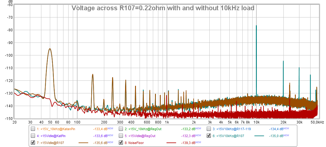

+- 2.5V is specified @Vs=+-15V, would be lower @Vs=+-5V, even lower @Vs=+-2.5V.
There is very little high freq noise generated by the circuit itself. But when its load current changes, it will reflect on its output voltage through its equiv internal impedance Zout. This can easily be seen when driving a high freq uC load like RBP, the noise can jump to couple hundred uV from my testing.
The easiest way to estimate Zout is testing load transient response, using two parallel resistor loads, one controlled by a switch.
Please do test the real load, I'm very interested in the result.

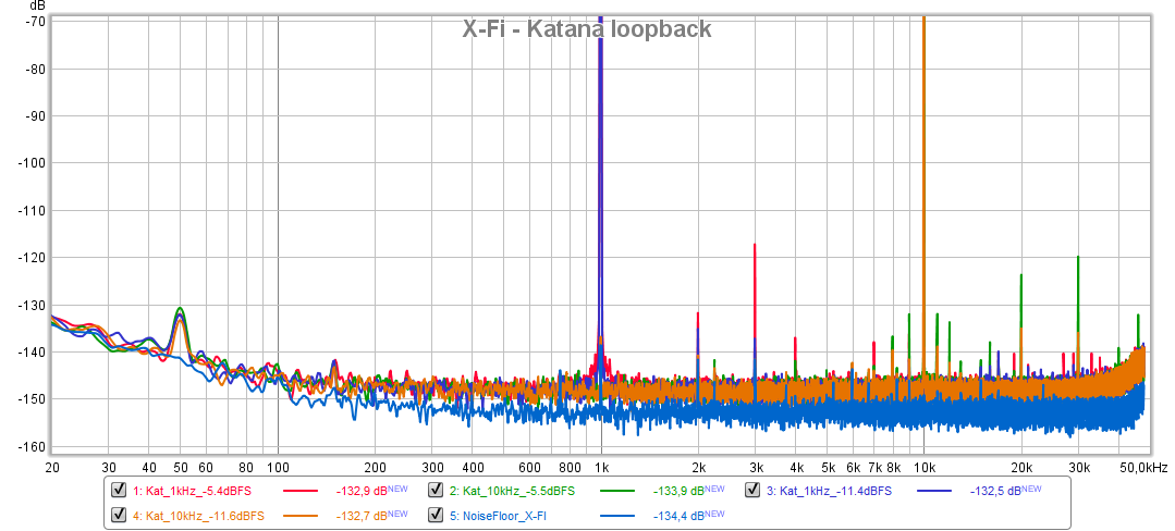

Hello @bButcher,
I measured the distortion of the modified Creative X-Fi using the katana as source. Here the results:
1kHz@-5.4dBFS THD(!without noise!) = 0.00027% = -111dB
1kHz@-11.4dBFS THD = 0.000097% = -120dB
10kHz@-5.5dBFS THD = 0.00023% = -112dB
10kHz@-11.6dBFS THD = 0.000099% = -120dB
When you get close to the FullScale of the ADC, the distortion rise quite sharply, so better to stay below -6dB which means the noise becomes dominant in the THD+N.
Here a screenshot and the REW file for more details

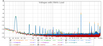

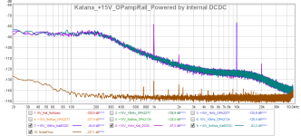

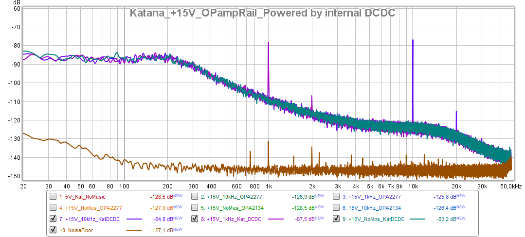

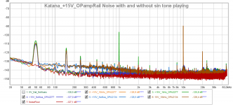

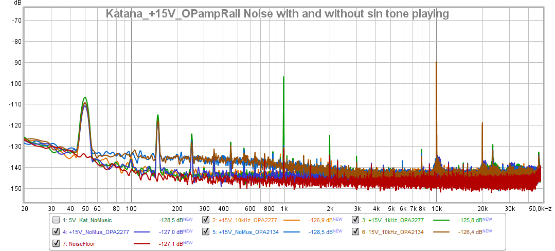

I measured the output voltage of a modified "Studer" regulator using a dynamic load, in order to get an overview of the output impedance.
I used the regulator to power the +-15V Opamp board of the Katana DAC.
Then I measured the voltage when no music was playing, and with a pure sinusoidal tone -12dB amplitude at 1kHz and 10kHz.
In the image in attachment, we can clearly see the correlation of the output voltage with the tone played by the dac.
For comparison, I also attach the same measurement of the Katana power rail power by the internal DCDC converter+internal regulator.
The "Studer" regulator is better than the katana internal regulator but it is certainly not low enough to make it negligible.
I do not know how many mOhm the output impedance could be. I do not know if it is the regulator that limits the output impedance, or the cables and contact resistances.

Hello
Here measurement of OPA2277 and OPA2134 split in two screenshot. I added the REW file also, to see more in detail. The voltage was measured at the katana pin. The average current should be 70mA.
I made new measurements at R115-117-119 and across R107 as you suggested. The measure across R107 allowed me to calculate the output impedance (I think. Let me know if I am wrong). Here the results and screenshot and REW file in attachment:
R107=0.22 mOhm
R107_Idle DC = 15.6mV --> I=V/R=70mA (as from Katana spec)
Vac@R107_10kHzLoad
Voltage of 10kHz peak = -76.5dBu = 115.9uV --> 526uA
Vac@KatanaPin_10kHzLoad
Voltage of 10kHz peak = -88.7dBu = 28.45uV --> R=V/I = 54mOhm
Vac@Regulator screw Terminal_10kHzLoad
Voltage of 10kHz peak = -92.3dBu = 18.8uV --> R=V/I = 35.7mOhm
Vac@R115-117-119_10kHzLoad
Voltage of 10kHz peak = -94.2dBu = 15.1uV --> R=V/I = 28.7mOhm
R107=0.22 mOhm
Vac@R107_10kHzLoad
Not much of listening comparison yet. The OPA2277 reduces the noise compared to TL072, but I do not know if it is actually audible.
