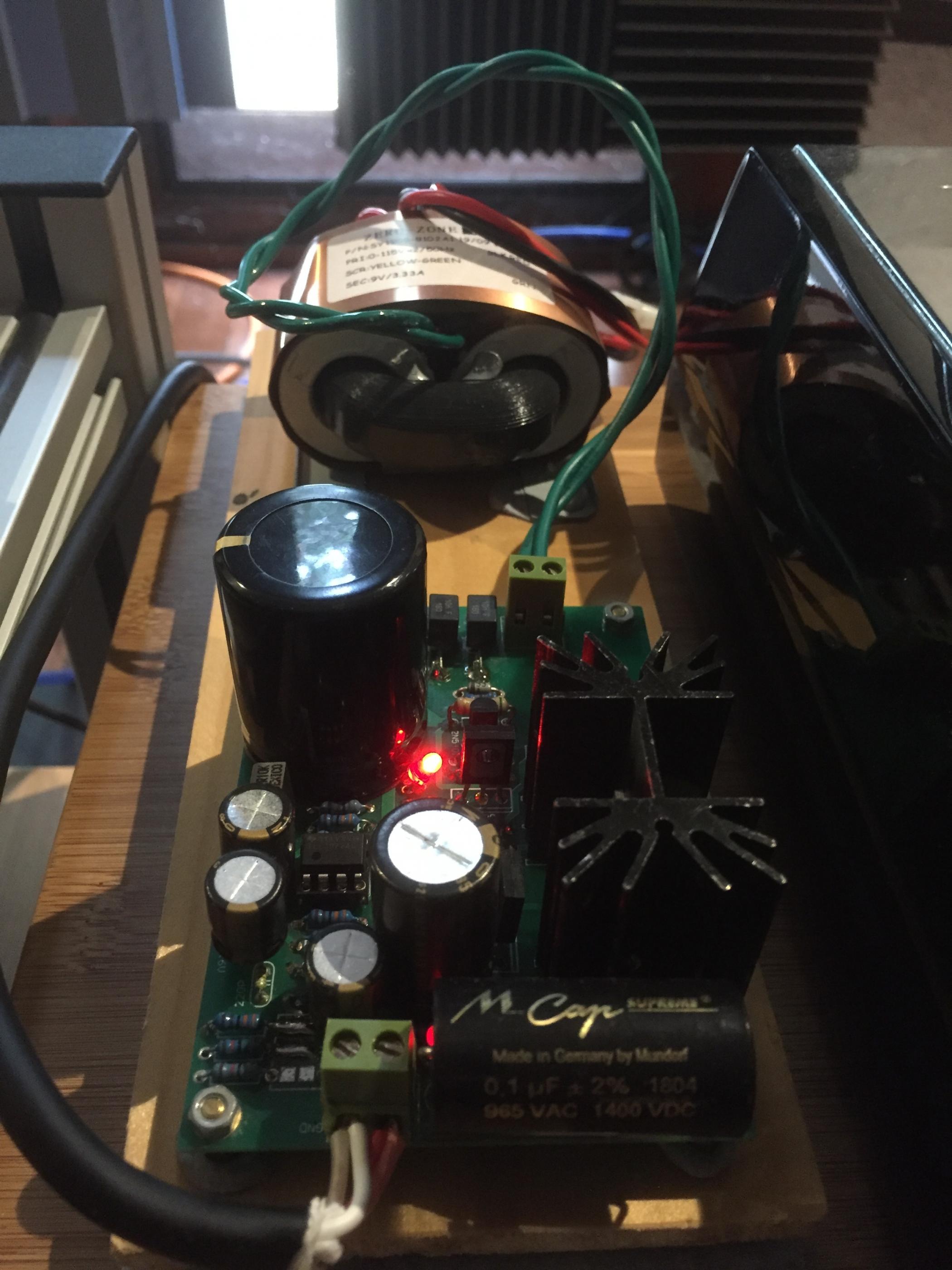

I'm using this at 5v to drive my DAC, with a few capacitor changes. The detail is good with a good soundstage, but but noticed that the high notes (piano, cymbals, etc.) are a touch dull.Their tone is dull, lacking the musical sparkle of my other power supplies. @200+ hours. Any thoughts on what I might consider swapping out?
Substitutions @buildup
  • Smoothing cap: Panasonic FR 2 x 5600uF. Also tried a Kemet ALS30 6800uF, which had slightly better bass but slightly worse HF detail.
  • Wima Poly cap for Mundorf Supreme EVO.
  • Striped 221 220pF for Kemet 221 220pF MLCC

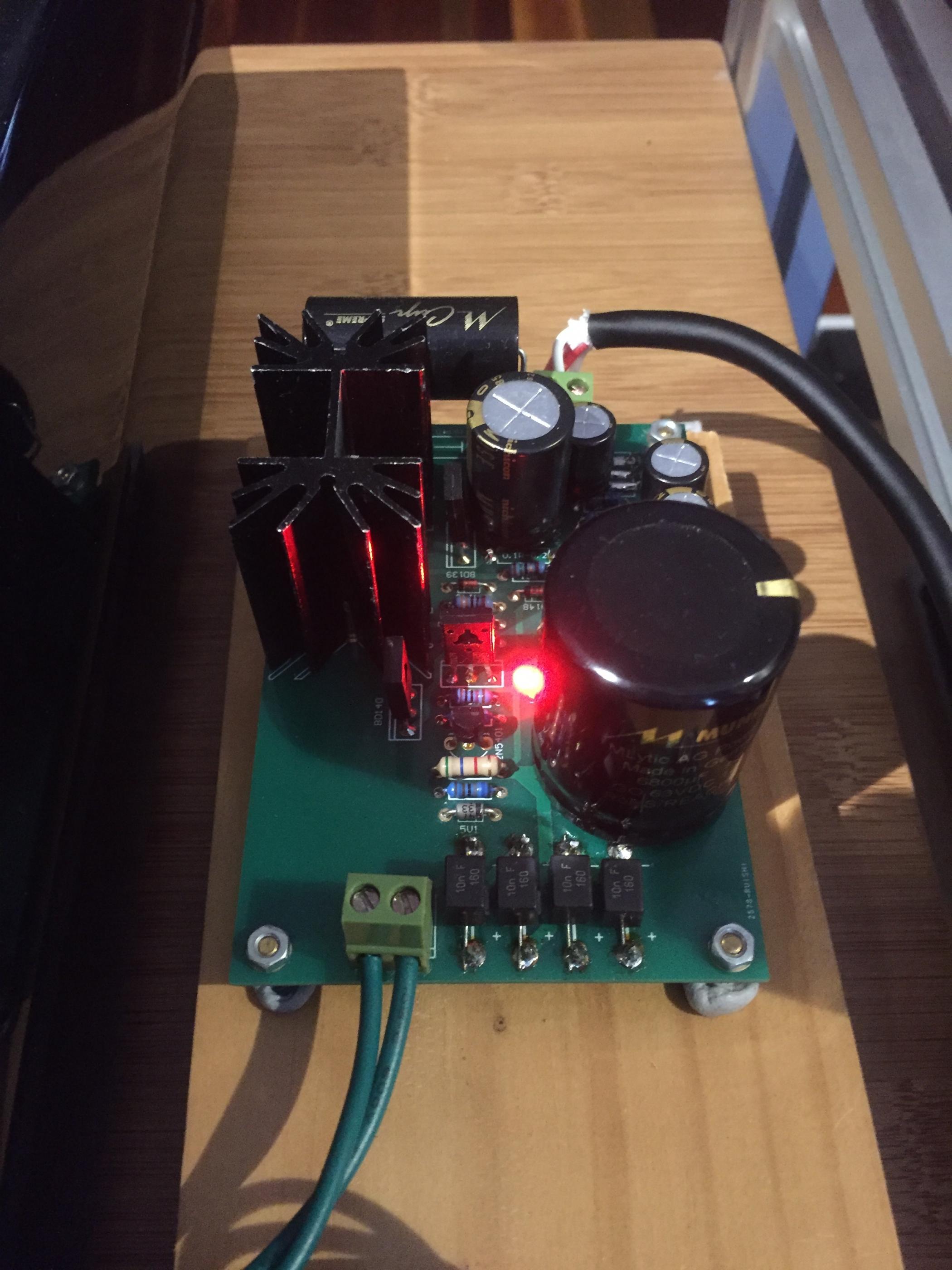

I've pimped mine with Mundorf & Nichicon caps and it sounds great. As a final touch I added vishay (0.01uF) bypass caps to the rectifier diodes and that is a nice improvement as well.
It looks like you didn't have room for the wirewound resistor. Is that mounted to the bottom?

Yes, the wirewound resistor is mounted on the bottom due to the size of the Nichicon caps. Likewise the rectifier diodes are mounted on the bottom to make room for the Mundorf cap to seat properly on the board giving a neater result in the end.

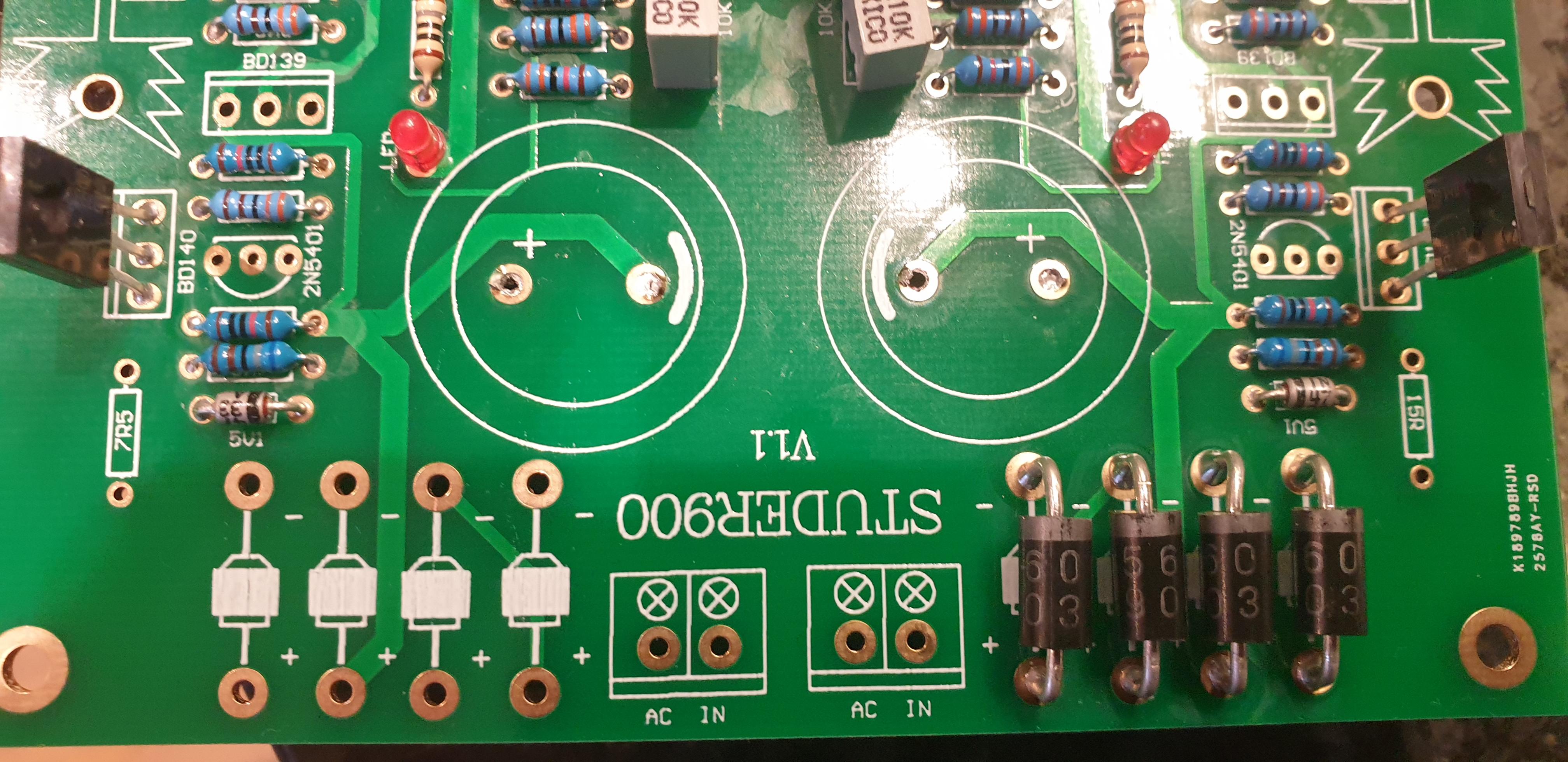

Whilst we are here....my dual board I am populating ....the 2 Rs at the end nearest the input. They are next to the 5V1 zener.? My board has 15R on the right hand silkscreem and 7.5 printed on the other rail.
My package contained no R15...only 15k. So I assume thos is a mistake. I do have the R7.5 but the fact it is different on the other rail confuses me.
My package contained no R15...I do have the R7.5 but the fact it is different on the other rail confuses me.
The 7.5R handles more current. 15R is only up to 1A and the 7.5R is meant to be up to 1.5A or so, per the seller.
