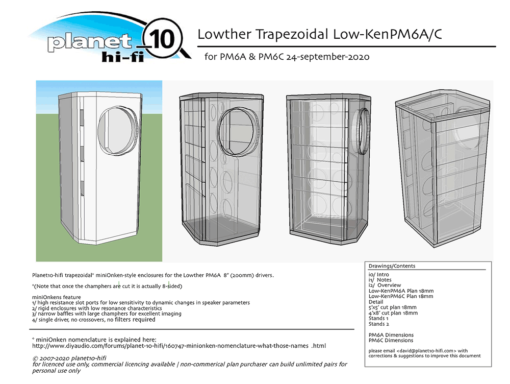

I would be remiss if I did not mention that Dave has designed a miniOnken for the 8 ohm PM6A. It's a complex build and so, for the moment, remains on my "To Do" list, but it is available for anyone else interested, I believe.

...8 ohm PM6A.
and the 16Ω copper & 16Ω silver VC PM6.
Currently going thru a revision. Bob Berner is building a pair and is finding a few glitches.
