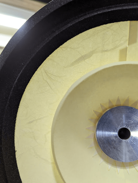

One more thing. A fellow Lowther owner suggested cutting the edge of the whizzer on my DX4 drivers to unfurl the reverse roll (to make the whizzer straight), based on his claims that the high frequencies sound better. After some careful consideration, I did so and I also thought that the high frequencies improved. When I ordered the DX65 drives I ordered them without the reverse roll.
I have non folder whizzer cone but that was used in my own fullrange design, I don't find that much difference once the paper weight is 110gsm or below for the whizzer cone.
My personal design is much different from Lowther, with the voice coil slightly smaller and taller former.
All made with Japanese washi hemp/kozo paper. It has a very good dynamic responses compare to Lowther.

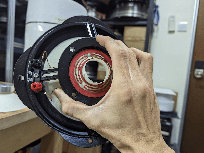

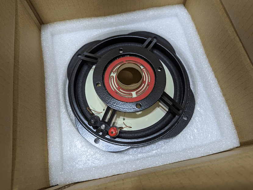

Repairing a coil on an existing Lowther cone without damaging the former is probably near-impossible, Have you contacted Lowther to find out how much it costs for a new cone? Since the new cone would likely look different than the old one, it would probably makes sense to purchase two new cones. The cones come mounted on the baskets, and you just need to attach your existing magnets.
If you do get new cones, they require extensive break-in.

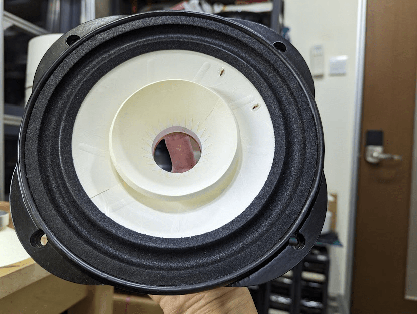

Not a simple work and takes lots of patience and time
Wow... So happy to have found this post @ghemml. I have been climbing up this ladder for a while without any idea what I am doing.
I have a pair of Tannoy speakers I am very fond of and took up the challenge to repair them after I stupidly blew them by accident.
In the process I had to work out a way of replacing the spiders too as they got damaged in the deconstruction process. I 3D printed mine which I'm happy to say are a little like the ones you have made. I will post pictures in due course.

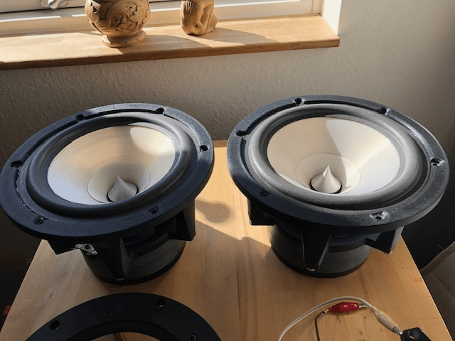

Amazing restoration work!One more thing to try is applying different coatings, and particularly the enABLe treatment developed by Bud Purvine. If you look around the web, you will see some forum posts about that.
Retsel
I have experimented with EnABL treatments on factory DX3 and DX4 cones - reported on the EnABL thread. The best solution to the whizzer shout (without cutting) was to use several layers of latex treatment on the back (or inside) of the outer whizzer roll. I have also experimented with different phase plug shapes using different 3D printed variations and also found that best results came with the pointed shape shown in the photos in post #22 above. Mine were slightly more elliptical... I have also used adhesive wool felt on the back-side reflective metal surfaces (particularly the magnet) and noticed slightly better clarity.

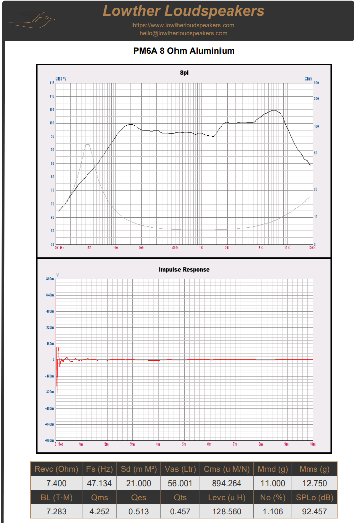

I found that the 16 ohm variety of DX4 did not have the 2000 hz peak (shout), although that does not mean that the frequency response is completely flat. When I accidently destroyed the former on one of my DX4 cones, I opted for the 16 ohm DX65 cones since I am using the Lowthers in front waveguides which does not need the larger cone size (I am only reproducing above 500 hz). According to Jon ver Halen (see quote below), Lowther applies a coating of shellac and the most recent owner applies more of it which likely improves the sound overall. Based on my findings, the straight edge whizzer (at least in waveguides) has a better sounding treble, so when I ordered the DX65 cones, I had Lowther make the whizzer straight edge.
