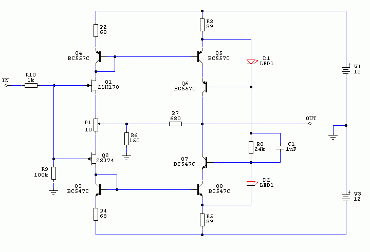

I did in fact add more feedback...520R/150R was as close as I could get to what you suggested. The sound is a little bit more lively now. Seems like a little less gain too? Not sure which I prefer, the original has a smoothness and silkiness I like. But I will have to listen for a while and see.
Also, while the circuit seems DC stable in a temp controlled situation it does fluctuate a bit (20mv or so) with temp changes. It probably doesn't help that my phono amp with shut regs is on top of it. I will leave the cps for now.
Still impressed. Thanks Juma.
Juma,
After playing with the feedback values I think I like 680/150R, your original values, the best. It has a smooth, airy sound I like and the widest soundstage.
I'd like to try a buffer on output. Why? Might get some more low-end dynamics and keep the airy highs without changing the feedback values. Also, might be awesome for headphones.
Do you have any recommendations?

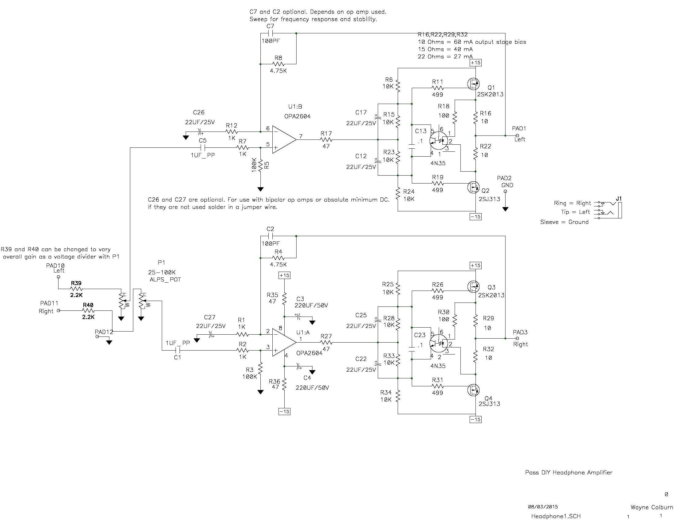

Currently I am thinking about using the output stage from Wayne's Pass DIY headphone amp (attached) since the bias mechanism is convenient.

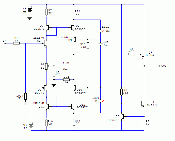

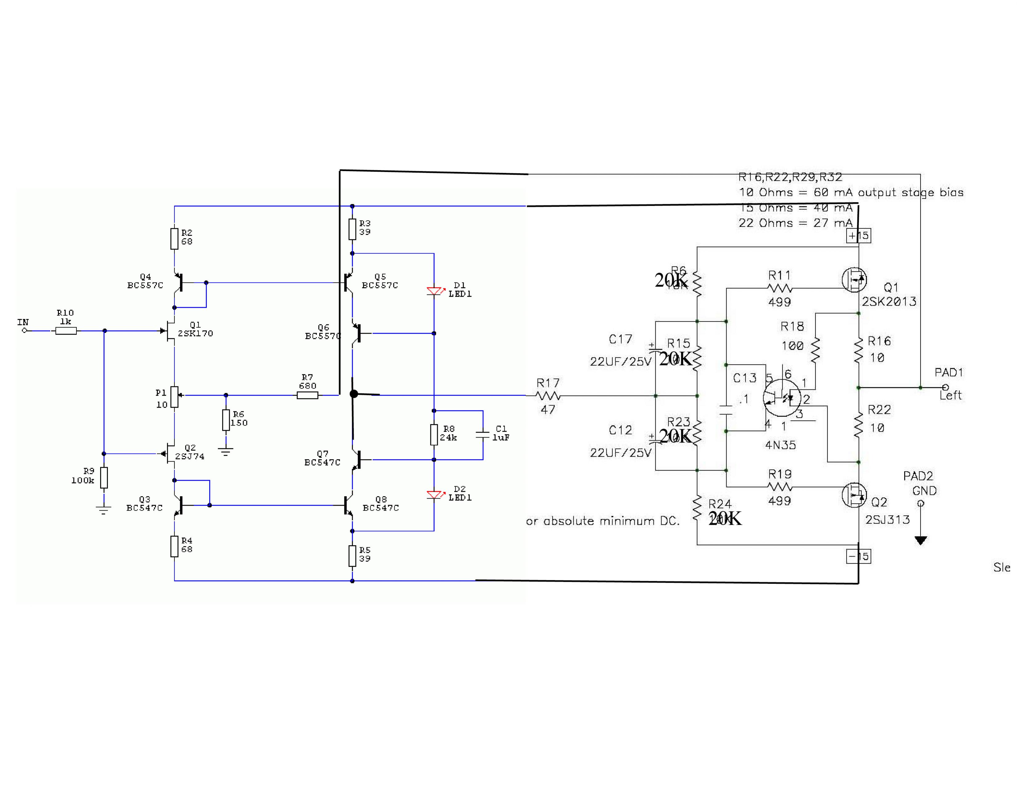

So, I started to put together Juma's LSK/CM front end (very nice) + the pass optocoupler output stage. Why? I want to drive headphones AND power amps at home and Juma's front end has the sound I am looking for, spatially.
I am wondering about the feedback values. 680/150R sounds right to me...Best mix of dynamics and soundstage.
Wayne's follower uses 4.75K/1K for feedback. About the same ratio and gain. But the ground resistor loads the BJT's in Juma's stage and 1K might wrong.
Should I stick with 680/150R? Feedback will be as attached, all the way to the output of the follower stage. I am planning on mounting Juma's front end above the mosfet followers like UGS to potentially experiment with other follwers and front ends later. Fun stuff.

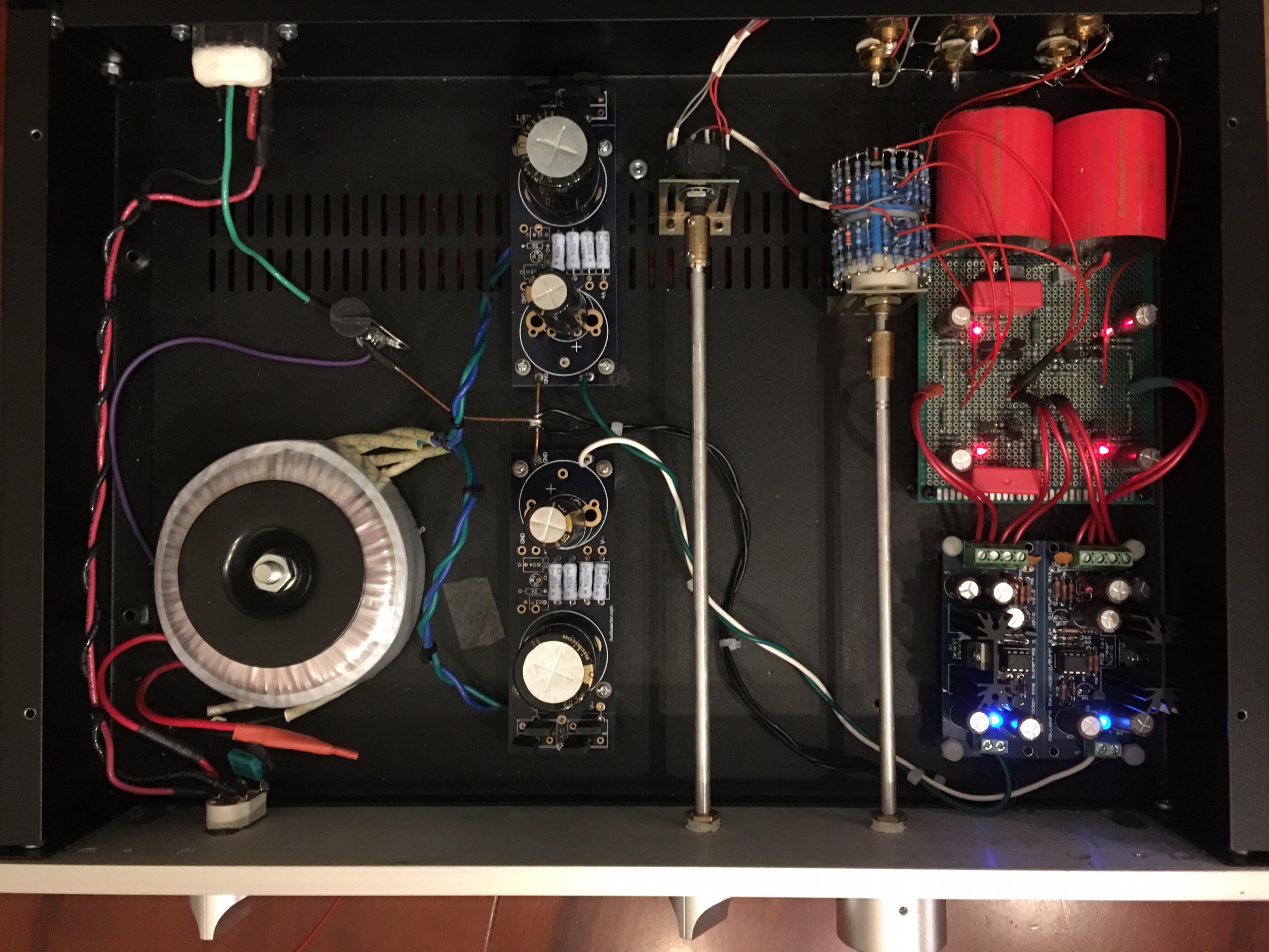

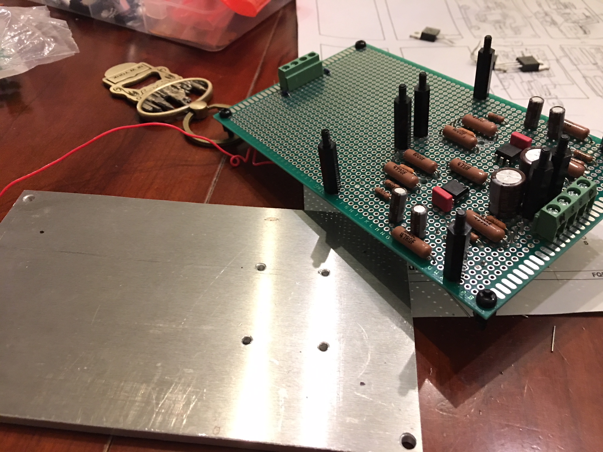

Here’s some progress.
It works. Cap coupled for now although offset seems very stable. But Iam being cautious. Boards do not bolted down until I figure out if I need the caps.
Iam going to listen for a while and see what I think.
THANK YOU JUMA!
