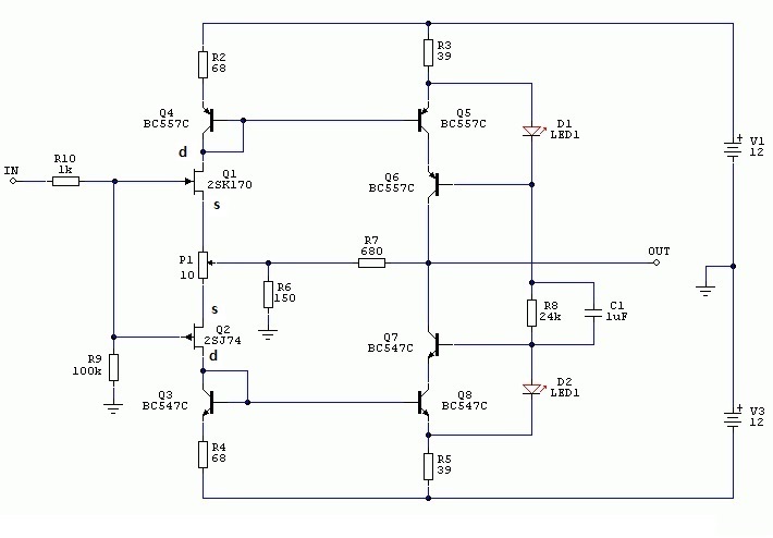

I also have built most of the pre's Hikari mentions and like him prefer the LSK one for one with gain. But I do use and like my B1 version2 as well. I also have built a number of tube pre's along with the Korg but they are just not my taste. Too much 2nd harmonic. All this is subjective depending on your taste, equipment used and environment. I have built 2 or more of the BA-3 pre's. Excellent with the BA-1 and BA-2 amplifiers, I have both, but not my taste as a stand alone pre. I ordered 8 of the LSK170 and LSJ74 C grade ones and matched them as close to IDSS 15 as I could. Not exact but with some pots instead of just resistors on the last stage and using the Arta software I adjusted the 2nd harmonic to my taste. Juma's mirror one sounds excellent as well but more trouble to build on a proto board. Boards were once available for his build but I doubt any are available now.

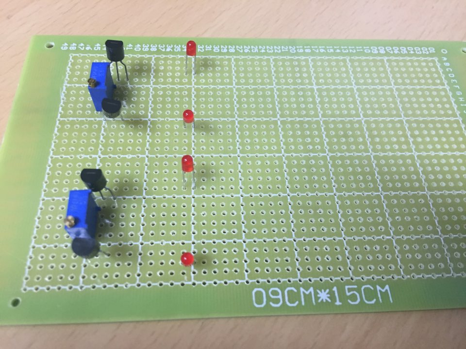

Following Hikari1's comment, I began anyway. I am waiting for BC547 557 and resistors.![]()

I believe Hikari and I are talking about the Nelson Pass LSK pre presented at the BAF. If you are using BC547 and 557 you are building Juma's pre which is harder to build on a proto board. Not that hard, I built mine on a proto board, but more involved than the simple NP LSK linestage. It will sound excellent with very little difference in sound compared to the NP LSK linestage. When finished do show pictures and give a review. The previous poster has a left over Juma board already stuffed. If not you someone should consider buying those boards if they want a great linestage to drive their Firstwatt clone.
I am planning to do this circuit of Juma, which I understand is simple with 220-ohm output impedance without the buffer.
That offer of the stuffed board is tempting but with two higher supply voltages (bipolar 33V and 45V?).
I thought this attached one is easier for me.
But it seems that this circuit and the GB circuit are quite different in performance?
I tried to figure out reading the posts here. There are many circuits along with Juma's experiments.
Well, Juma seems to think his current mirror version sounds better. I have not heard or built the other version. I do know that bc550/560 is far easier and cheaper to get than the lsk. Also, it looks easier to build to me. But I am mostly working with perfboard and not pcb.
