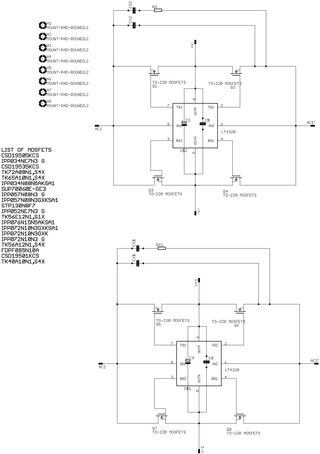

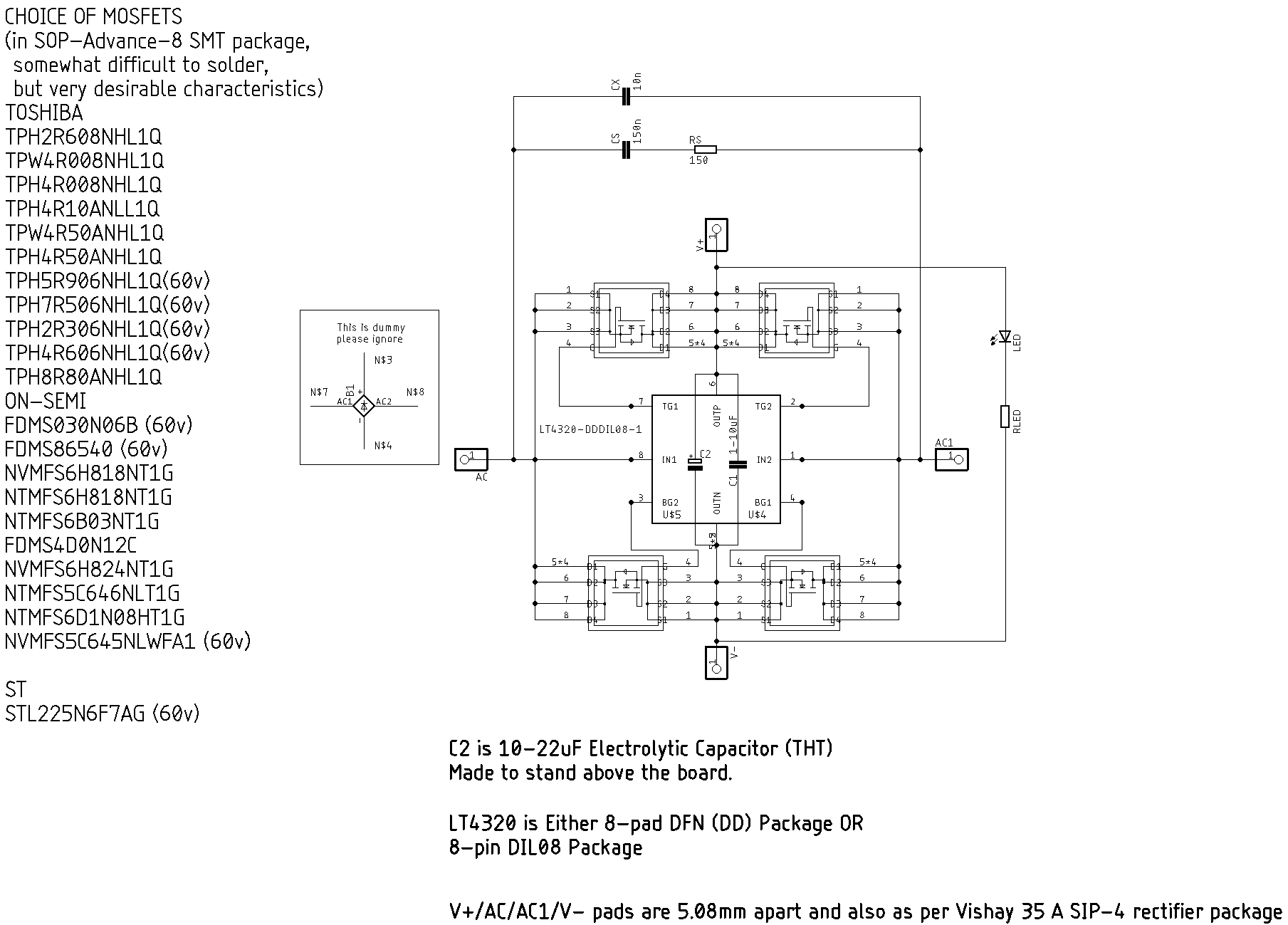

Dear all,
Here is the schematics THT and SMD boards.
I have given a rough indication of type of MOSFETS suitable for the application.
While this isnt a strict requirement use particular mosfet, do follow the guidelines given in the below post by me .
LT4320 based active rectifier
and very comprehensively by Tibi
I still would like to retain the optional pads for electro cap just in case of someone's implementation makes it far away from main filter caps.
Also, retained is the optional led indicator for smd, but I would recommend LED+ resistor only for low-medium voltage application (12-35V) where dissipation through resistor can be controlled well within the rated power. https://www.mouser.in/datasheet/2/392/n_catalog_partition24_en-948804.pdf
As informed by Tibi, there no absolute need for either electro cap or LED indicator.
Regards
Prasi
