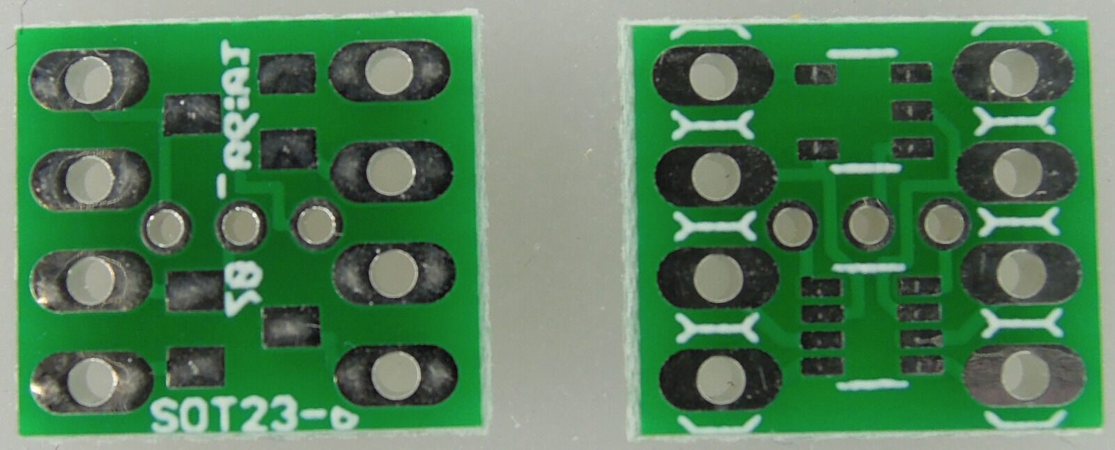

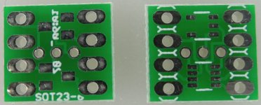

you need SOT-232 matching fixture/socket
easiest to get them from E-Bay - few sellers, just take care choosing one without neg. ticks
15$ and upwards
rest is easy - when you obtain one, buzz and I'll post small sketch what's needed (7809 reg, switch, small relay, few 2mm sockets for DMM probes)
15$ and upwards
see, example - DIP SOT23-6L SOT23 To Chip IC Programmer Adapter Test Converter Sockets | eBay
trusted seller - at least I got one from him
