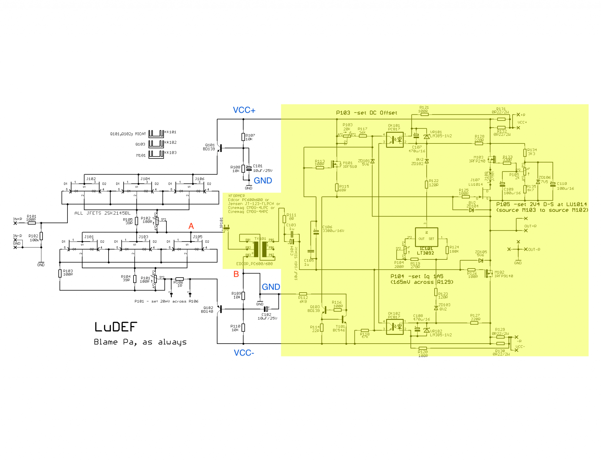

I am going to make LuDEF on the PCB of my own layout. And, of course, I was not smart enough to follow ZM schematics to the very detail - and I did not place a jumper in JP101 (before the pin 2 of autoformer). Now, I read somewhere in this thread that you are supposed to disconnect the jumper before your first set-up when you set 20mV across R106, and put it back after that's done.
Is this essential? Could the 20mV setup process harm the autoformer if it is connected during the process?
In that case, should I (could I) leave the autoformer totaly out of the PCB before I set 20mV across R106?
Just to be clear for the greenhorn (boldish-grey-horn, actually):
ZM, what exactly do you mean by "just missing output parts"? Do you mean jus the output transistors (M101, M103 and J107(LU)), or the entire circuitry as marked in the attached schematics? Would it be ok, if I do not install anything in the yellow zone and apply VCC+ and VCC- on the marked points from the standard +-24V supply? Then set 20mV across R106 and there should be 0V DC between points A and B?
Or, if I put everything on the PCB except just the Edcor. Should I put PCB on the heatsinks while setting DC offset of the buffer, as the output transistors would get hot anyway, even when the xformer is out?

IMO, using only 22.000 uF capacitors for single supply to both channels is going to ruin benefits of potted top quality toroid. You’ll have no or minimal induced 50 Hz EMI at the amplifier output, but there will be enough 100 Hz ripple coming from PS. At 3 A load, first capacitor will have about 1.3 Vpp ripple. Simple RC with 0.1 Ω and 22 mF will reduce ripple by 12 dB or 4 times. That results with 115 mV RMS output ripple. Now, OS has some PSRR and will reduce that but I didn’t measure LuDEF PSRR because there isn’t anything to measure in my version, so I can’t say how much will remain.
It could be a problem with very efficient loudspeakers.
There are very good CDE 47 mF/35 V capacitors available and I would go with that.
As for the fuse, I use 1.6 A fast blowing.

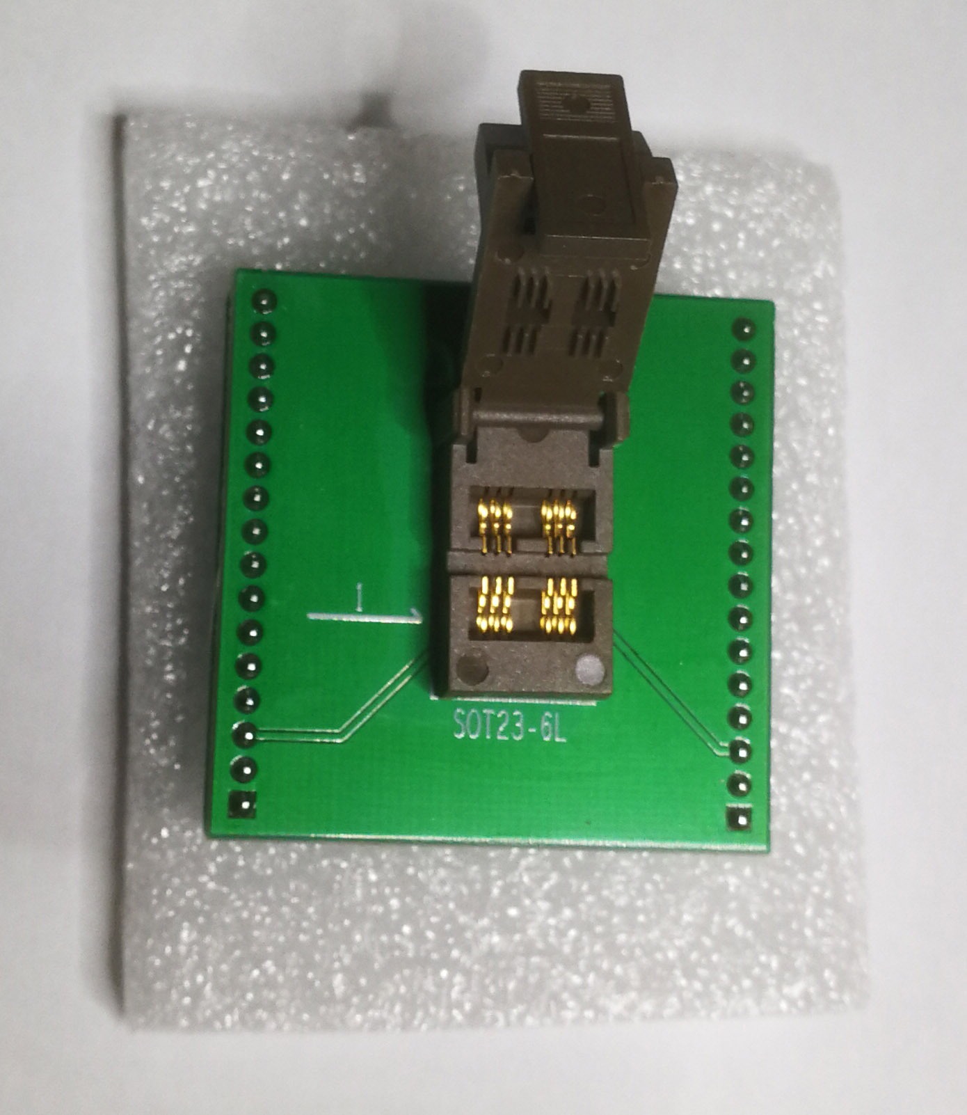

hai bisogno di un dispositivo/presa corrispondente SOT-232
più facile ottenerli da E-Bay - pochi venditori, basta aver cura di sceglierne uno senza neg. zecche
15$ e oltre
il resto è facile: quando ne ottieni uno, ronza e posterò un piccolo schizzo di ciò che è necessario (reg. 7809, interruttore, relè piccolo, alcune prese da 2 mm per sonde DMM)
ZEN Mod e ora cosa ne faccio?! :incerto:😱ps:
