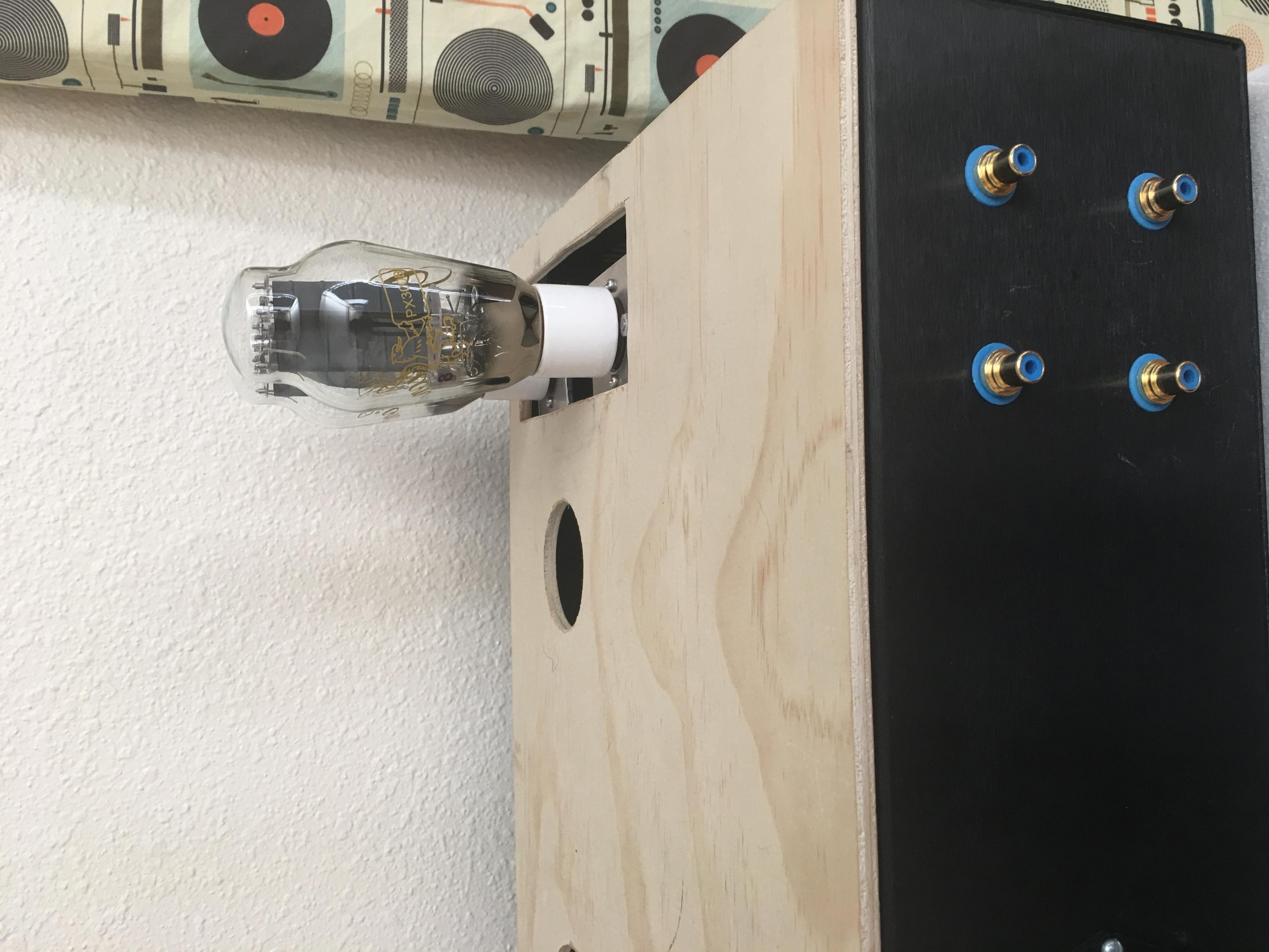

Oh, you meant tubes. Yes, for sure. Lots of triodes there. Here’s one, though it is pretty obscure :D
