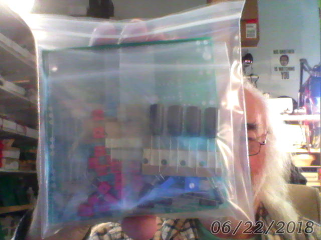

Wow-- this is what had me on the edge for actually doing the lxmini's..
Thanks, and can't wait to see them on the storefront.
