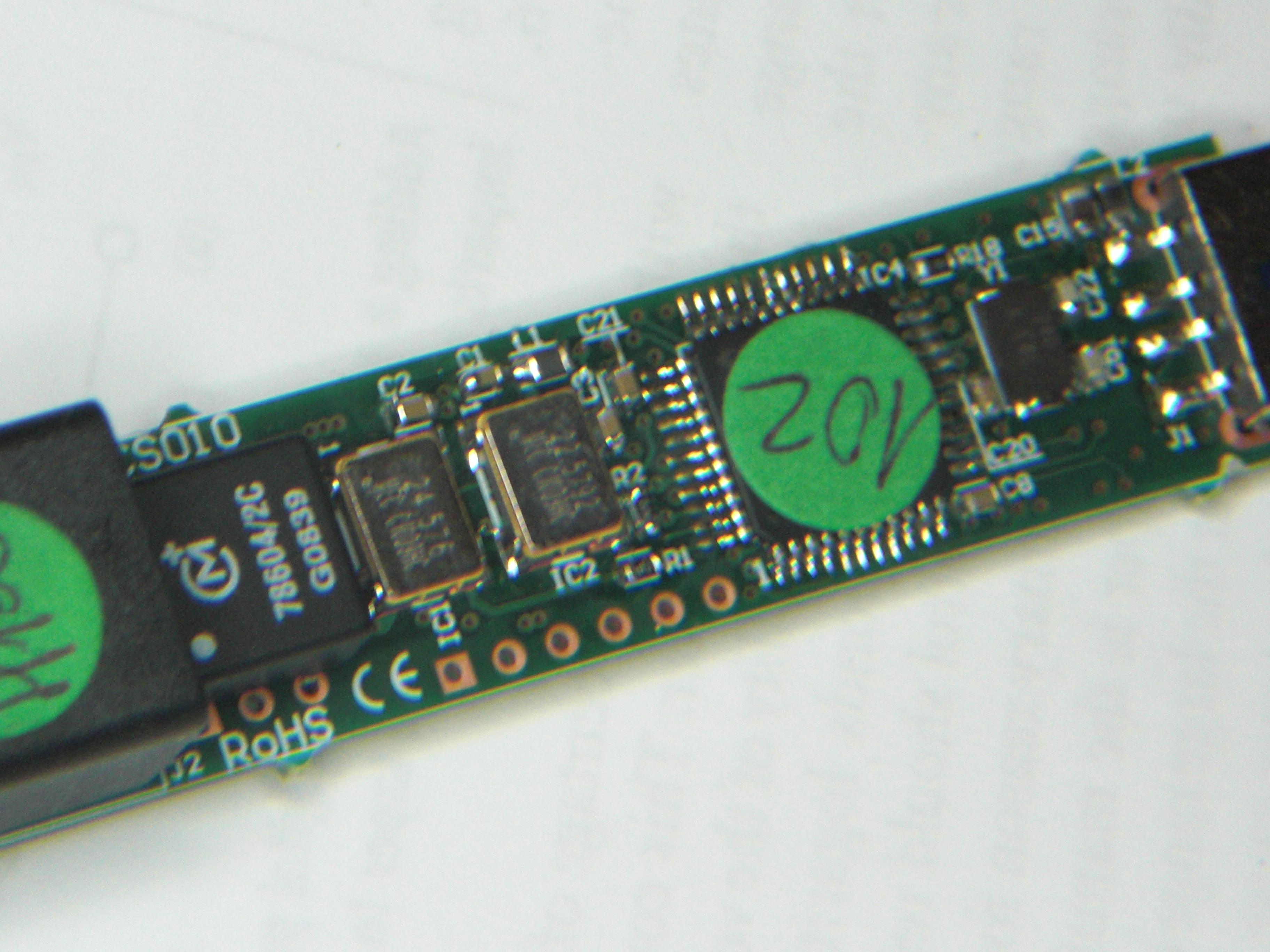

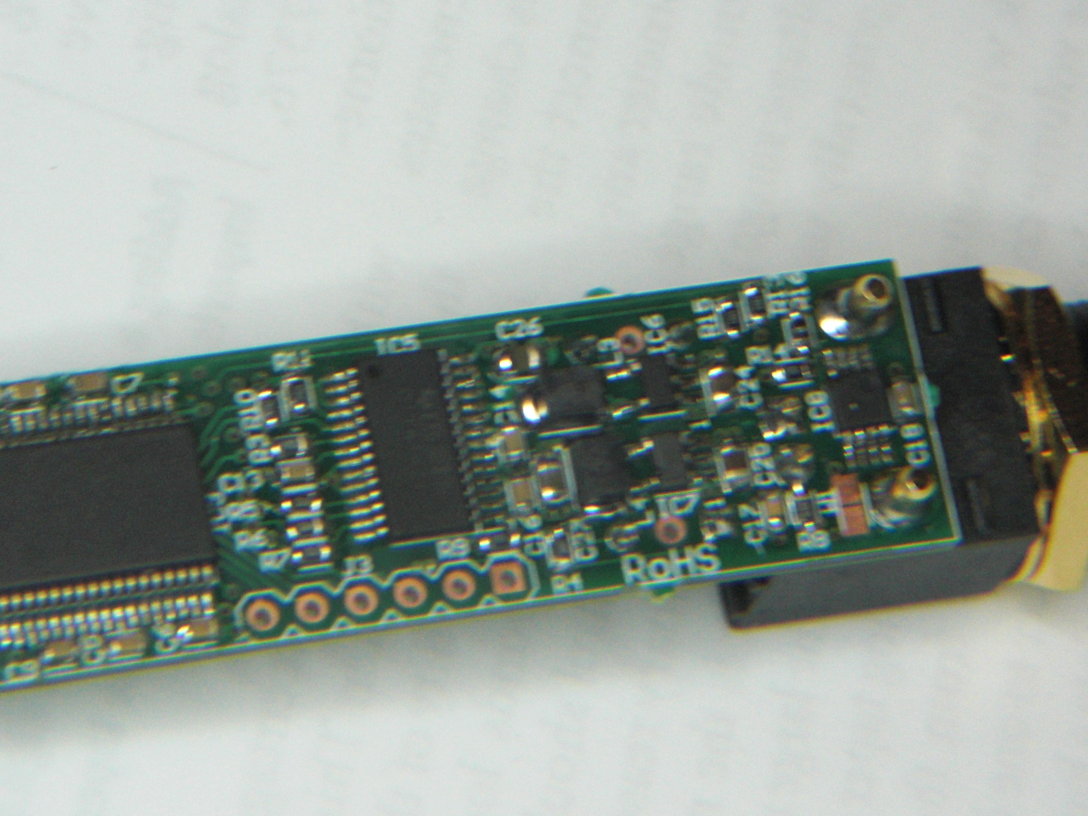

A couple of internal photos of this very small device:

I don't like SPDIF either, I'll try tapping I2S very soon and I'll post results.

Not an easy task: the resistors are so small that the simple "attaching" of a wire can damage them (imagine why I know it!
However, with some skills of microsurgery
Anyway, DON'T TRY THIS AT HOME!!!!!
In the next days I'll be able to post some results.
Ciao
Guido
