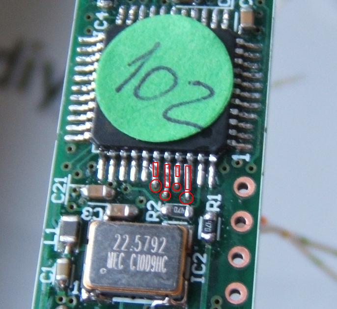

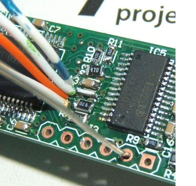

Back to technical topics (even if I'm all but a technician), it's quite difficult (but not impossible) stealing I2s from the HiFace, and the result is remarkably good, no clik or hiss, and a sound quality miles above PCM2707-based USB receivers.
ASAP I'll post some pics

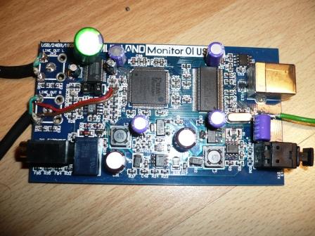

Here are some pics of my Musiland 01US (the one with on-board PCM1793 DAC)
First shot shows the full board which I've done the following to:
- replaced digital PS coupling caps with OSCONS
- analog PS decoupling to PCM DAC with Nichicon Muse

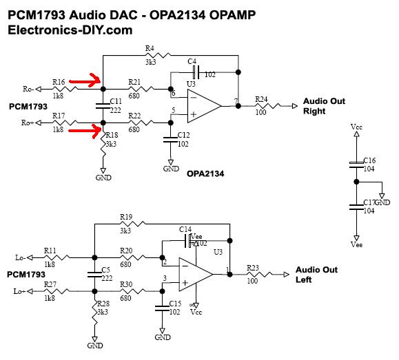

- the Brown & Red wires are from the differential Vout of the DAC to the twin co-ax that connects to a transformer - so this is the new output stage & sounds WAY better than the op-amp o/p stage. I needed to move the two 1K8 smd resistors from their pads (see attached schematic). This now disconnects the op-amp o/p stage but if I want to reconnect I just need to jumper from where the wires are connected to the moved smd Rs. Easily reversible mod. The other channel has thinner wires running under the board. These wires connect to isolated pads that were exposed when the RCA connectors were desoldered from the board.

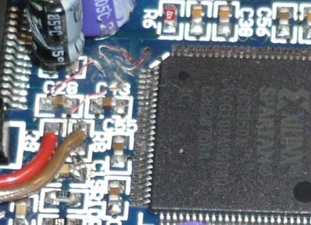

Last photo shows a close-up of the Xilinx chip where the I2S lines run to the DAC. I removed some of the overlying varnish on these tracks in a staggered manner, applied a touch of flux & solder & then soldered some fine wires onto these tracks (make sure you have tinned the wire & apply some flux to the wire - line it up on the exposed, soldered track & just a tip of a soldering iron will do the job - not difficult with a magnifier. I run the wires through vias, to the bottom of the board and connect to a molex push on connector

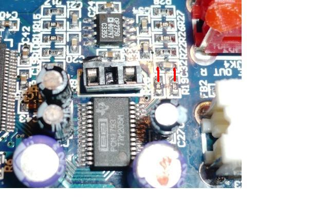

I also put a socket (seen in the pic) on the Vcom pin of the PCM1793 as I heard that this capacitor influenced the sound - I can't say I've noticed much of a noticeable change among caps - maybe a better HF response using film?
I've marked with two red lines, the two 1k8 Rs that are moved down to join with either side of the smd cap, exposing the pads that the two wires are soldered to for the transformer output
