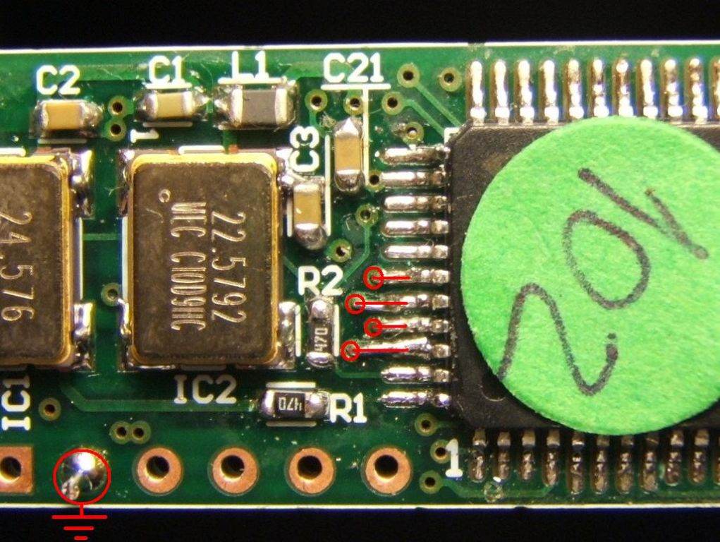

The board is very small, so only limited mods are possible.
Here the most important ones.
Taking out I2S: the points are on the following resistors:
MCLK -> R3
SCLK -> R5
LRCK -> R6
SDATA -> R7
In theory, it could be better to steal the signal upstream of the res, in case of long wires, downstream in case of short ones.
The "up" is the side near the DIT for R5 and R6, the opposite for R3 and R7.
In fact, due to the extremely small dimension of the 47R res (0603) is not advisable to attach wires directly on them, the risk of burning them (as I did 🙁) is very high. (you can see from the pics that I replaced the 0603 with 0805, but due to the limited space one has to be mounted on edge😱).
DO NOT REMOVE THOSE RESISTORS!!!!
My solution, after some disasters 🙁, has been oriented to the better "mechanical" solution, in order to avoid any stress to the very fragile pads. Following the tracks from the resistors, you can see four vias that are connected, the other side, to the Xilinx chip (the one with the big green dot).
I ran copper wires (0,35mm - AWG 27), duly bent and tinned, applied some flux, lined them up on the legs of the chip and just a tip of a soldering iron - a magnifier is a must. The attentive reader can note that the connexions are mixed - upstream and downstream: it works just the same.
You can steal the ground connection from the second uninsulated pad on the side of the board (near the square one).

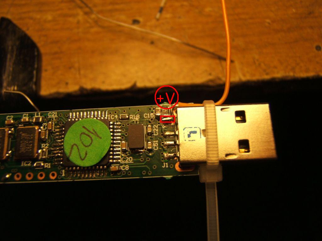

Replacing PS: the HiFace is fed by USB, so we can isolate the V input.
To make the change reversible, I disconnected the Vin pin by only lifting them, and connecting an insulated wire. The wire is fixed with a tie-wrap to improve the mech (and to avoid stress to the pads).
On the pics I have evidenced in red the vias and the contacts.
Enjoy (I did!!) 😀😀

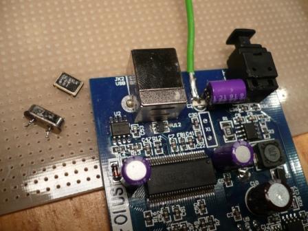

Ok, here's the start of the new clock install (micro-surgery is fun 🙂):
- First pic is crystal removed with the smd Crystek clock beside it

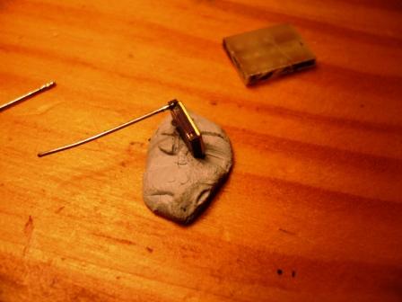

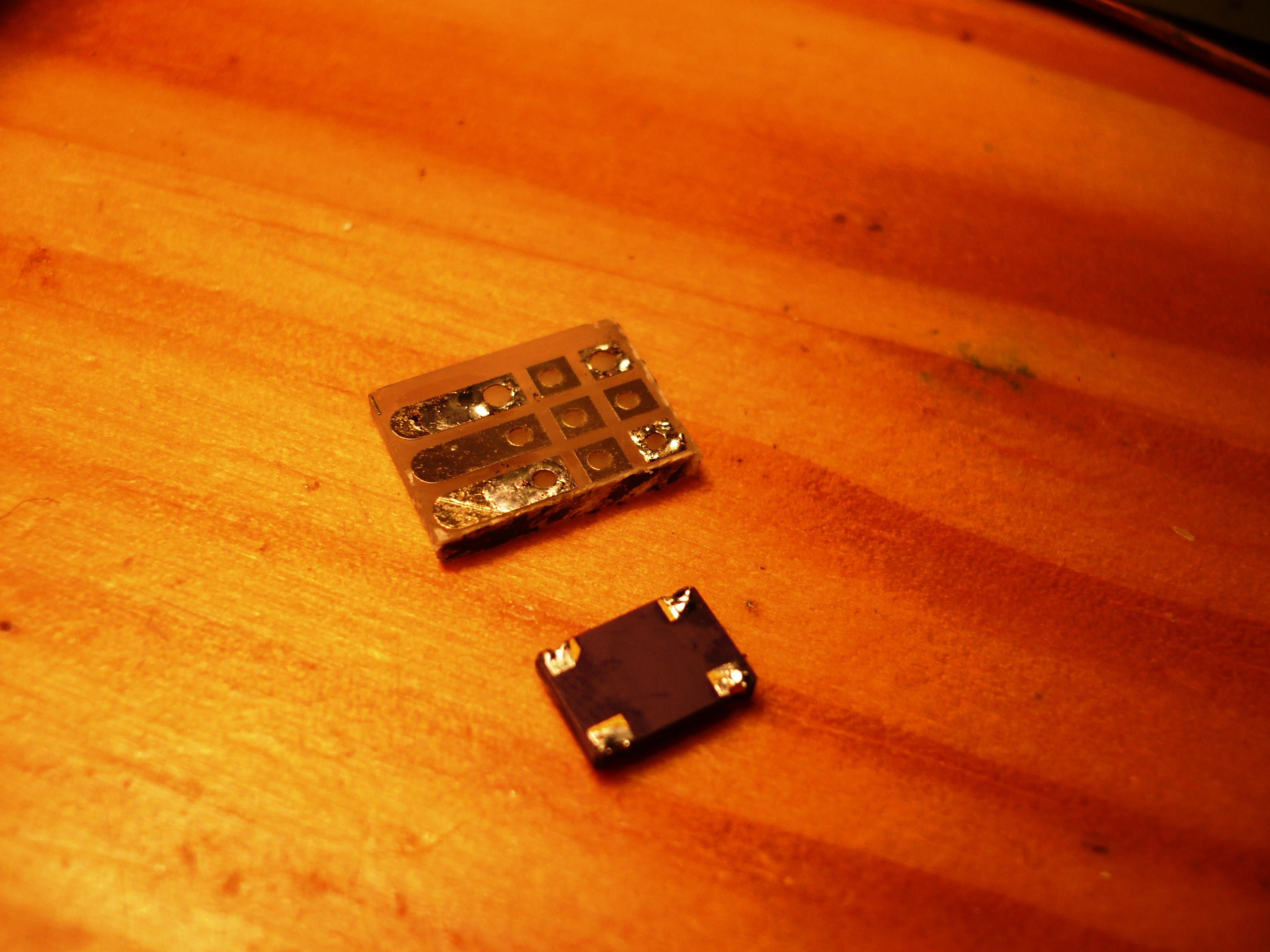

- Second pic is the back of the smd clock with a small board cut from a matrix board - I had put solder on the clock pads as I had intended to solder to the board but I didn't use this method - instead I did this:
- Third pic - there are little grooves from the pads that go up the sides of the smd clock - here is a component lead cut-off soldered in the groove.
- I did this with all 4 pins (although I don't need pin 1 connected) & put the pins through the board from the top so I could solder the pins underneath to the copper side of the matrix off-cut board.
- Pic 4 - This gives a very solid & small structure. I soldered the out pin to the Xtalin (pin 12) where the original crystal had been.

- Plugged in USB cable but unit is now not recognised by the laptop 🙁. Not surprising really as I haven't changed the load cap that was on the crystal (I told you this was quick & dirty to see if I could get it working straight off🙂). The other issue that may be causing it not to properly initialise is that there is a timing condition that an external clock has to meet for the Cypress to operate correctly. I will probably try to power the clock from a 3.3V battery as I originally intended & have this powered up before the Cypress chip.

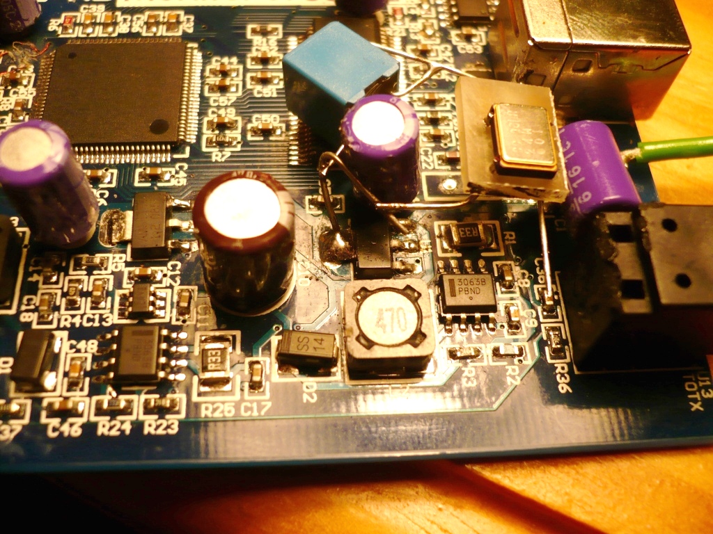

A better final picture - pin 1 (at bottom RH corner of pic) is not connected, it's just left floating in air.

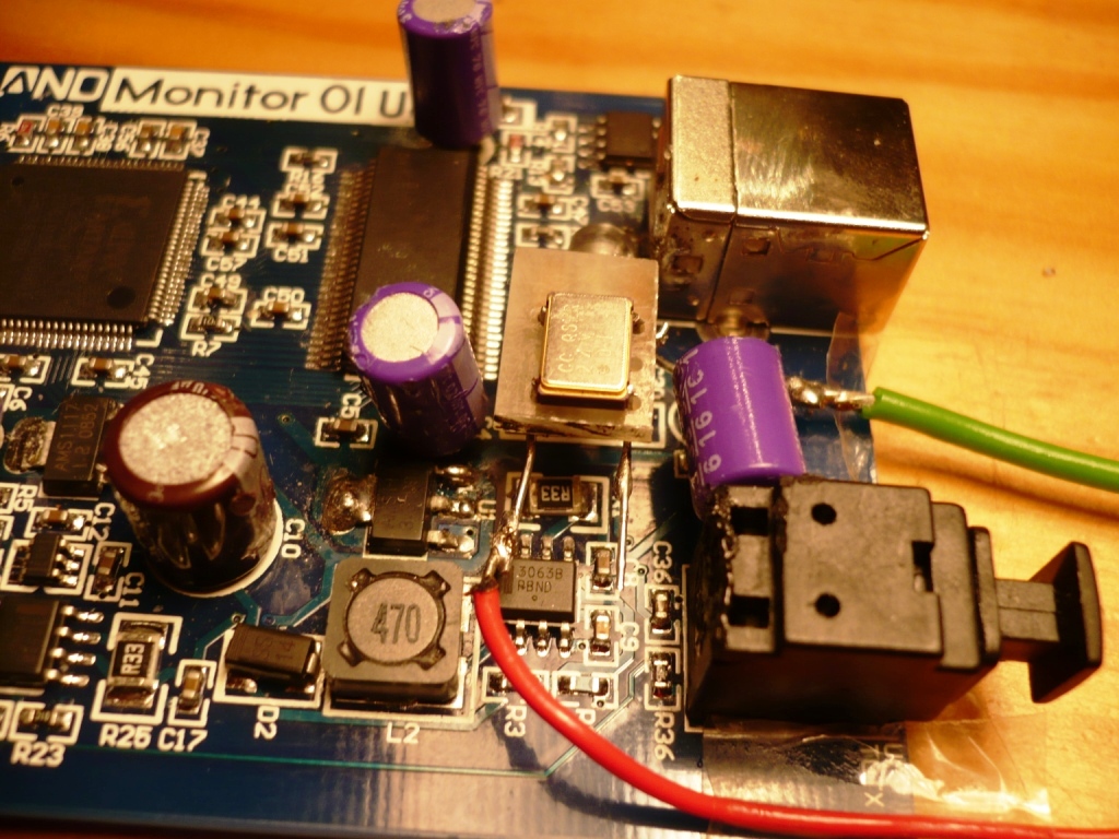

Success 😀
The clock needs 1-2mS to initialise so it needed to be powered up before the Cypress chip as I suspected. I re-did the clock - I'll post pics later.

It's stable as it's legs are component leads & so stiff - one of these is soldered into the XTALIN hole vacated by the crystal, the ground lead is soldered to another fixed spot, the ground connection on the board (you'll see it better in the pics). BUT this is not the optimal arrangement for the clock - I believe it could be made more stable & secure & closer to the Cypress chip - I might even put it on top of the Cypress with a short, fine wire to pin 12 (XTALIN) - this was all pretty much a proof of concept thing.

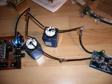

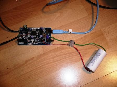

1. Pic of full DAC, trafos & amp. the trafos are Sescom MI-97. The white top is an octal tube socket into which the Sescoms plug.
2. Battery powering the clock & USB cable powering the rest. Noticeable sound improvement - haven't had a chance to test with external power to the DAC, yet

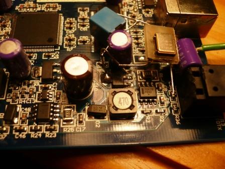

3. The clock is mounted on the board about 0.5" above the board- it's clock out wire lead soldered into hole vacated by crystal. Gnd lead connects to where the green wire is soldered to the board. I de-soldered the original cap that was on XTALIN board track from the crystal to ground. I put a 22pF styrene load cap across the clock out to gnd underneath the clock board - you can just see it sticking out of the far side of the board. I also soldered a 0.1uF cap under the clock board between VDD & gnd.

The clock is a Crystek C33 24MHz - Mouser Part No 549-C3391-24.000
I'm just thinking, I will probably mount the clock on top of the Cypress chip if I can find a stable way of connecting it. A shorter lead from clock to chip is no bad thing but I don't expect to hear any improvement.
