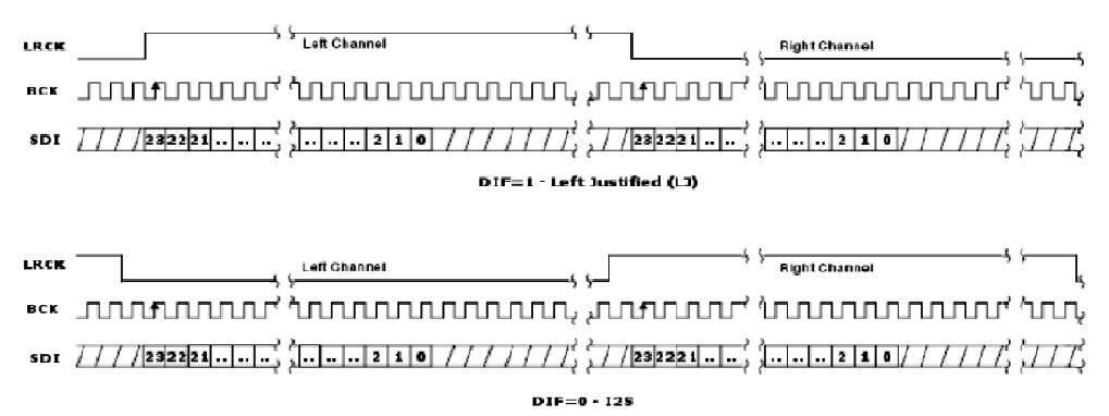

FYI, the I2S may cause you problems depending on which chip you intend to interface it to. It does not conform to the usual I2S spec, in particular the timing of the L/RCLK. Marco is aware and working on fixing this.
Can you tell me any more about the timing issue - I'll be interfacing it to a Sabre ES9022 DAC initially.
L/RCLK changes state 1/2 clock cycle late I believe. Use a multichannel scope to see this.
There's no way of knowing which DAC will work with out-of-spec I2S without trying it, I presume?
Isn't that the same Left justified/right justified mode? the LRCK is 1/2 cycle different from I2S. Most DAC would support that mode along with I2S. Unless the data is half a cycle late, but how can you tell?
You can tell if rising edge of SCLK happens at same time as L/RCLK changes state.
SDATA and L/RCLK should both change on the falling edge of SCLK for both I2S and right-justified. I2S has L/RCLK changing one clock cycle later than right-justified.
Since this works fine with CODEC on the HiFace module, it may not change. With the current HiFace, you may need to reclock the I2S to bring things into alignment.

Do you mean like this?

I emailed Marco & he replied that I2S is perfectly compliant to standard , as it's generated by the S/PDIF transmitter which operates as master with respect to the CPLD.
So I'm not sure what Steve is talking about?

Thanks for interesting info.
My hiface is connected to wm8742 by tapping i2s, no reclocking in place, it works any rate from 44.1Khz to 192Khz.
Guido tried also pcm1794 via i2s without any problem.

Hi John.
I emailed him, too
He confirmed that stock hiface is not having any issues related to i2s.
afaih Steven is using a different implementation not for end-users.

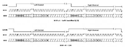

This is I2S timing.
