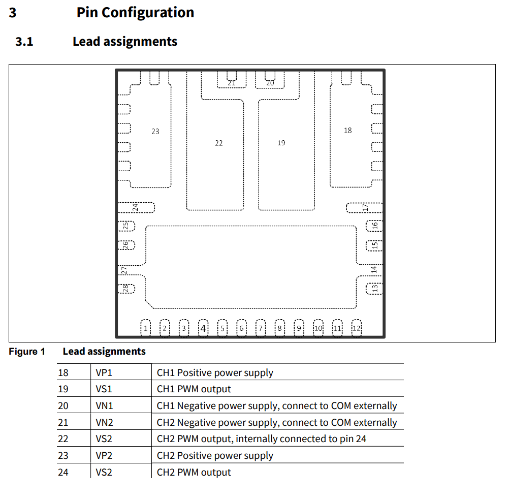

I like the package and the pinout.
Would be fun if this could work with for instance a 72v LIPO.

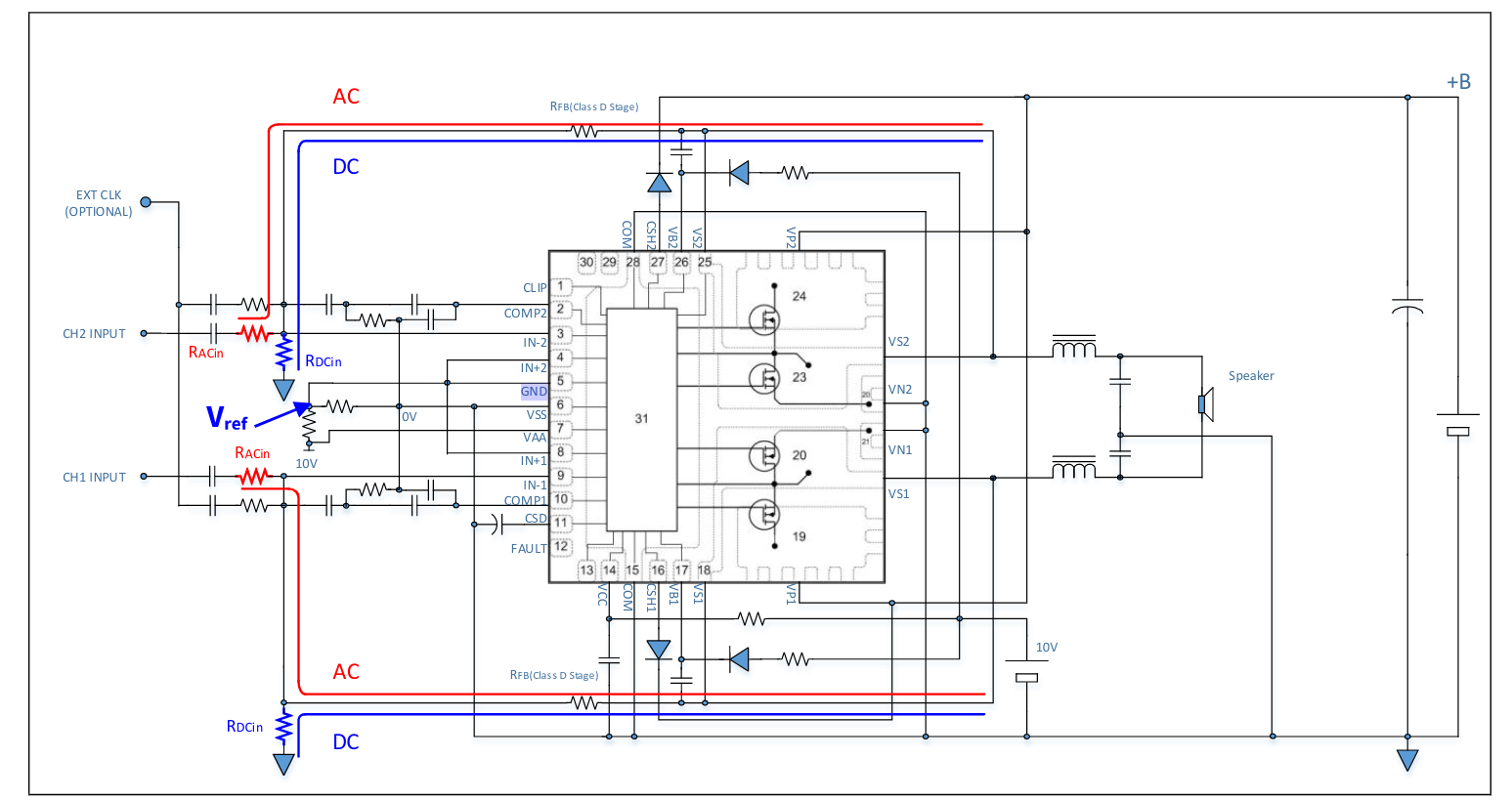

Joined 2007
Yes battery powered operation from single supply is my primary motivation as well. I have a prototype using IR4301 I have been working on but this will be considerably neater and lower cost. I need 8 amp channels to run my PA comfortably. My Battery is a 16S Lithium Ion so around 64V.
Looking at the REF_MA5332BTLSPS the method of setting the DC bias of the output to mid supply doesn't seem suitable for applications where the supply voltage varies. Instead of the attached design I would create a mid supply reference voltage and supply V+in with that and delete RDCIN. I guess the Reference board uses the attached arrangement to reduce component count.

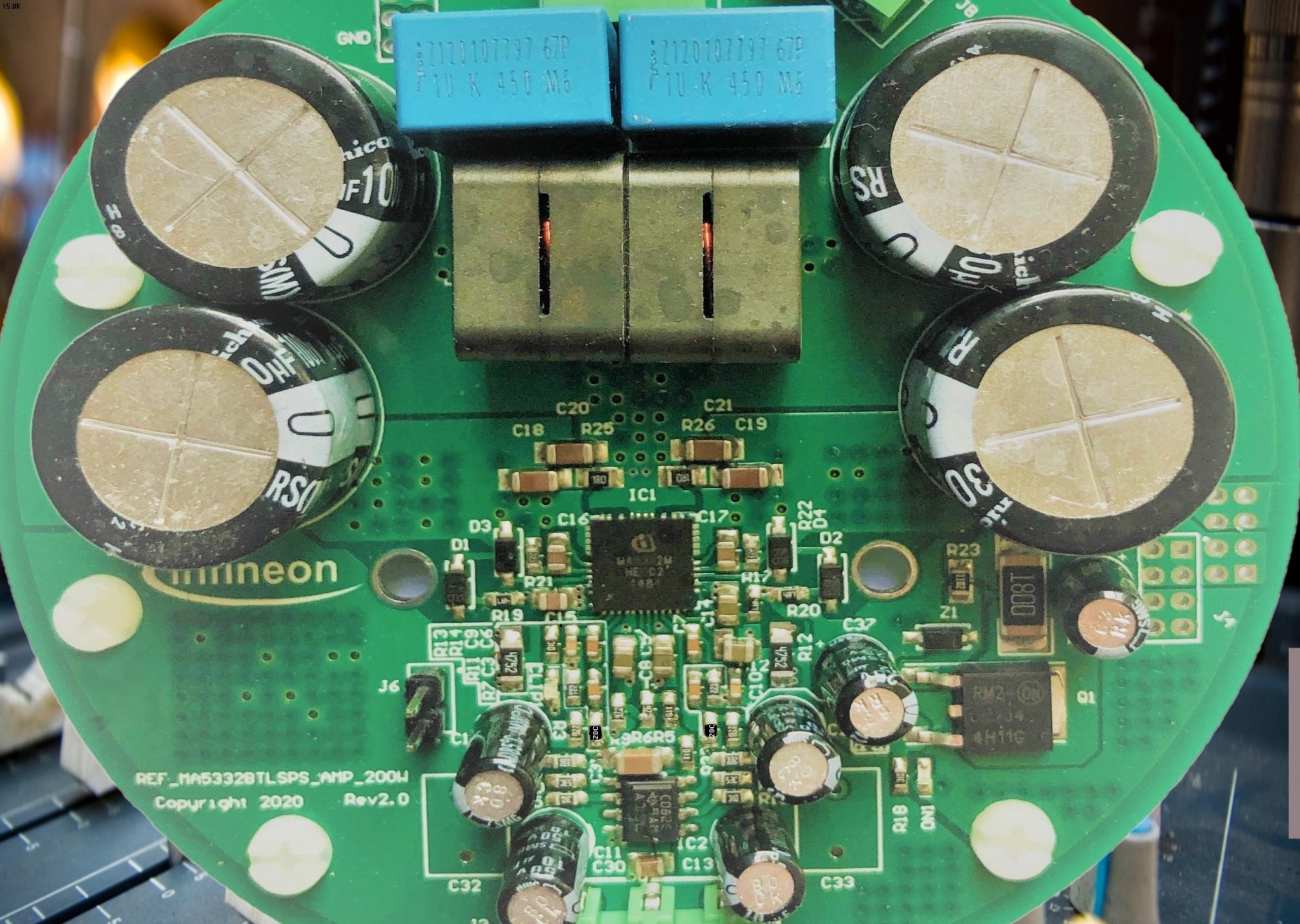

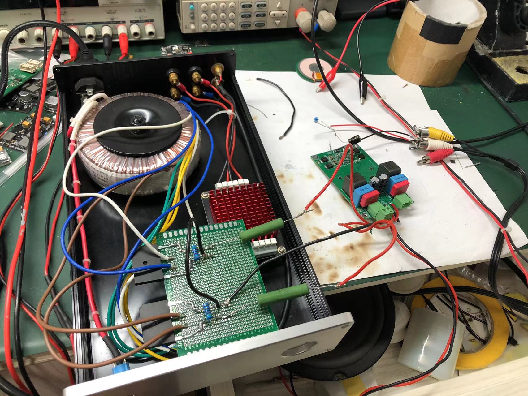

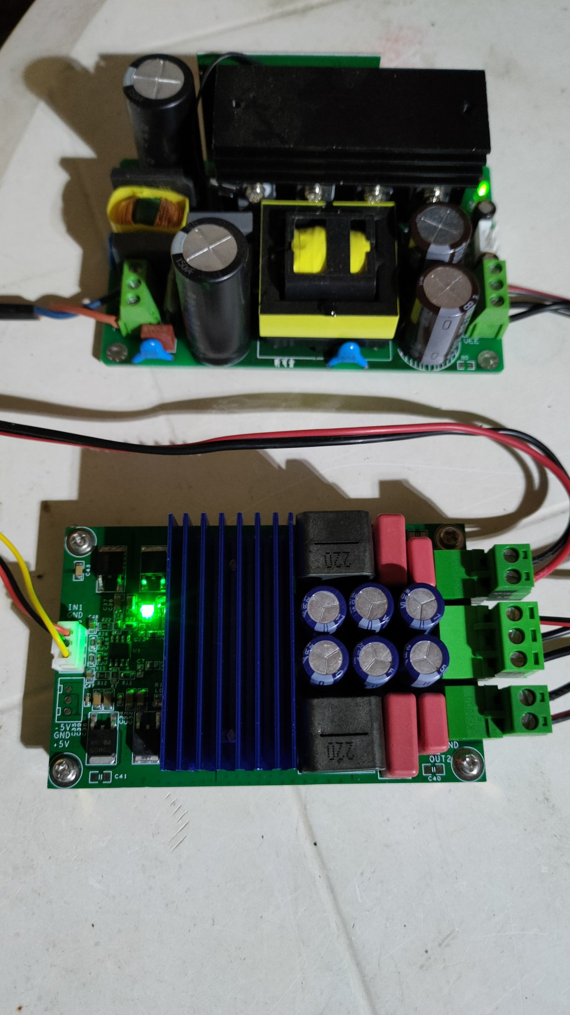

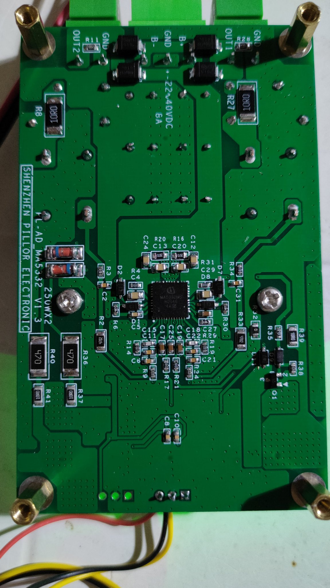

Card received today!
It seems really good quality.
Go hop, I connect it quickly...
Balanced 36v power supply, 8 ohm test speaker.
Well I'm very surprised by the power of this tiny chip...7 mm *7.
The quality of sound and power seems to be stunning!
The inductors are of good size, slightly warm.
The chip also, the radiator is at the same temperature, a sign of good heat transfer.
I admit, I had a doubt, the heat must cross the pcb...
Hate trying on my living room speakers.
Thanks Michael !
