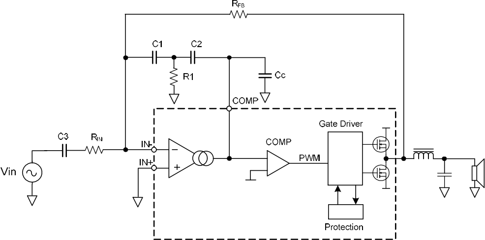

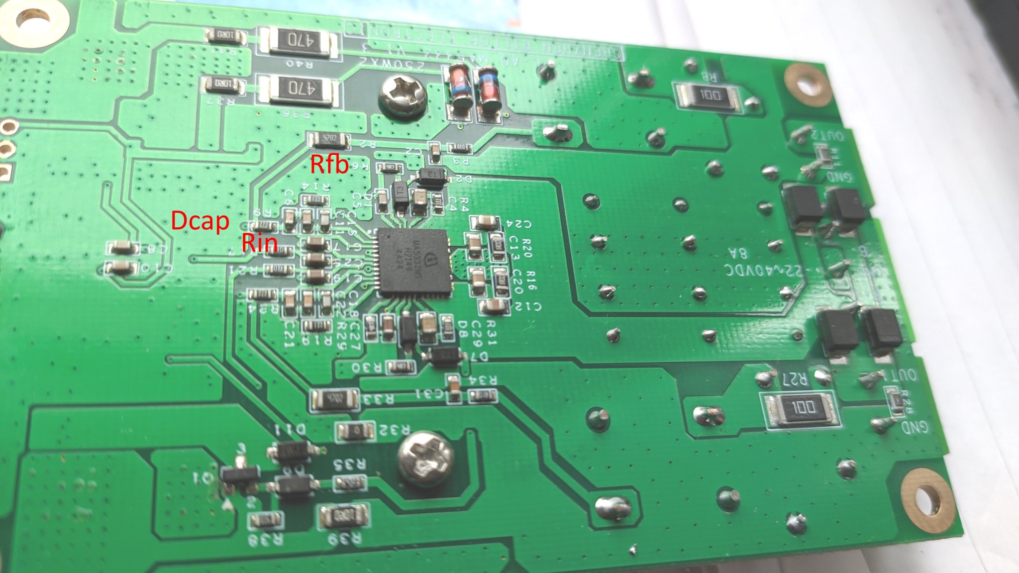

Took a look at the board of this MA5332MS implementation and compared it with the schematics in the Datasheet.
Noticed something strange at the feedback loop.
The Feedback resistor is not connected to the input of the MA5332 (as you would expect), but to the front of Rin, So between the Decoupling cap (other side) and Rin.
Double checked with the beeping multimeter.
Is this is a mistake? Do I oversee something?
No.There is probably an extra small value resistor in series with the - input?!

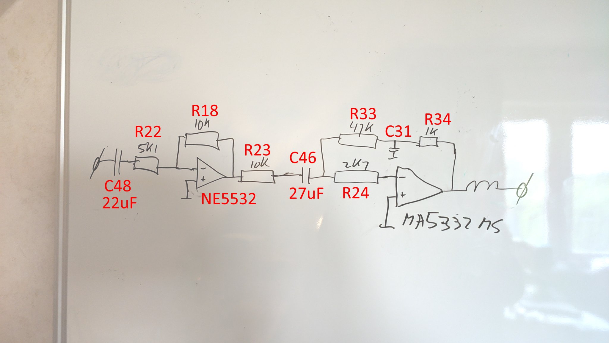

10k from the NE5532 output to the decoupling cap. Then the Rin 2K7 where also the RFb connects to. Other side of Rin goes directly to the inverting input of the amp, with a small cap of the RC network shown in the simplified diagram.
The feedback of the MA5332MS is split, in first 1 small 1k resistor, then small cap to ground then 47k (Rfb in picture). Is this to allow smaller cap value?
Datasheet mentions: Gain = Rfb / Rin.
Then Gain should be 17,8. But it is not connected this way. We now have a feedback loop consisting of 1k + 47k + 2K7, where the input signal is coming in between de 47k and 2K7.

If Rfb was connected to the inverting input of the MA5332MS, then it would be all just the implementation of the inverting amp from the datasheet.
Rfb also determines the switching frequency, so you should change Rin to set the Gain.

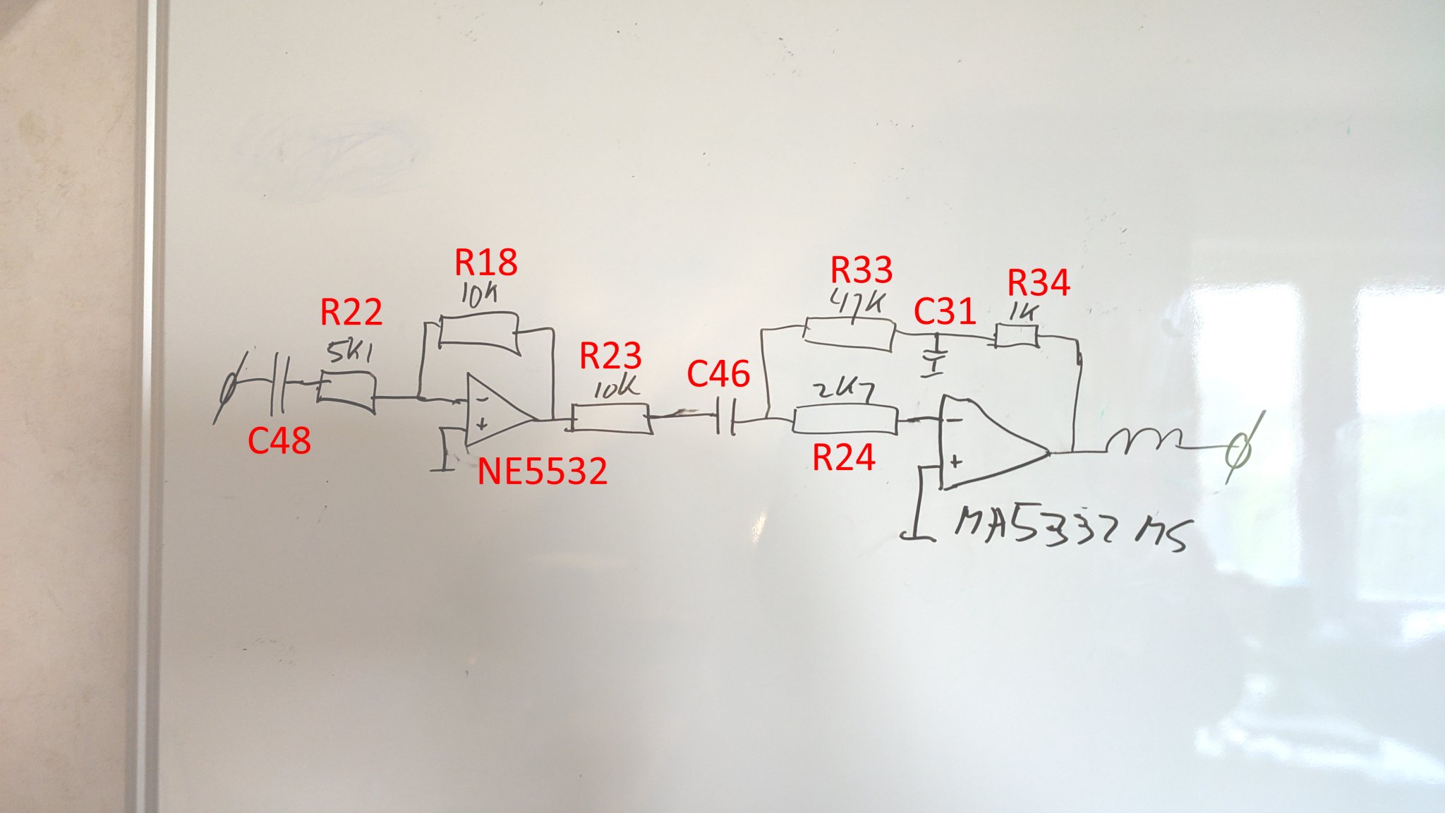

Made a drawing of the circuit on this PCB. As I want to understand what is going on first, before thinking about changing anything...
No COG, not even X7R with these values, I guess.

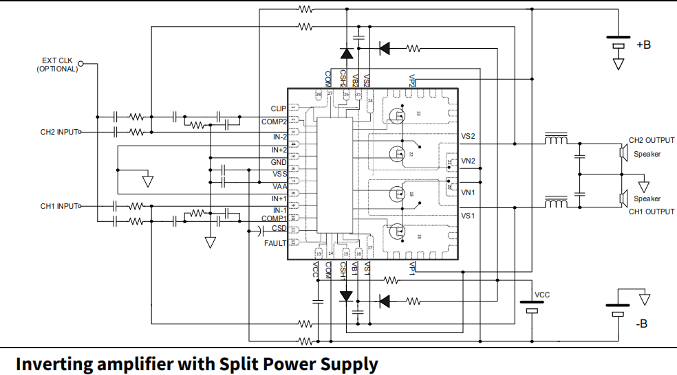

From the datasheet the inverting amp:
The cap in the feedback loop is connected to Vcc (trough the diode and resistor) rather than ground. This is also different on the PCB.

I have to correct myself. I should have looked one page further...The feedback loop is a copy of the evaluation board design of Infinion. Except that R55 is 0 Ohm here....
The implementation is an exact copy of the evaluation board. Except some values for the compensation.
If we have to see the 10k output at the opamp is also Rin, then the gain would be about 5 for the end stage. The pre stage having a Gain of 2, So together we have a Gain of about 10 for this Amp.

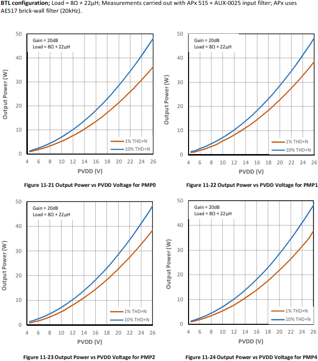

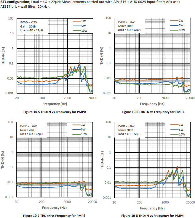

Noticed something when comparing datasheets.
On page 28 of the MA12070 datasheet, you can see that not all amps in the chip are equally good. PMP1 and PMP2 being much better in the higher frequencies.
Perhaps something to consider for the implementation?
Think of 30W absolute maximum at 8 Ohm, wind in the back and no rain.
Well... maybe 35W (1%). But indeed at 8 Ohm there is not that much of power.
How about dual mono? Like the Sabaj.
Using only PMP1 and PMP2.
