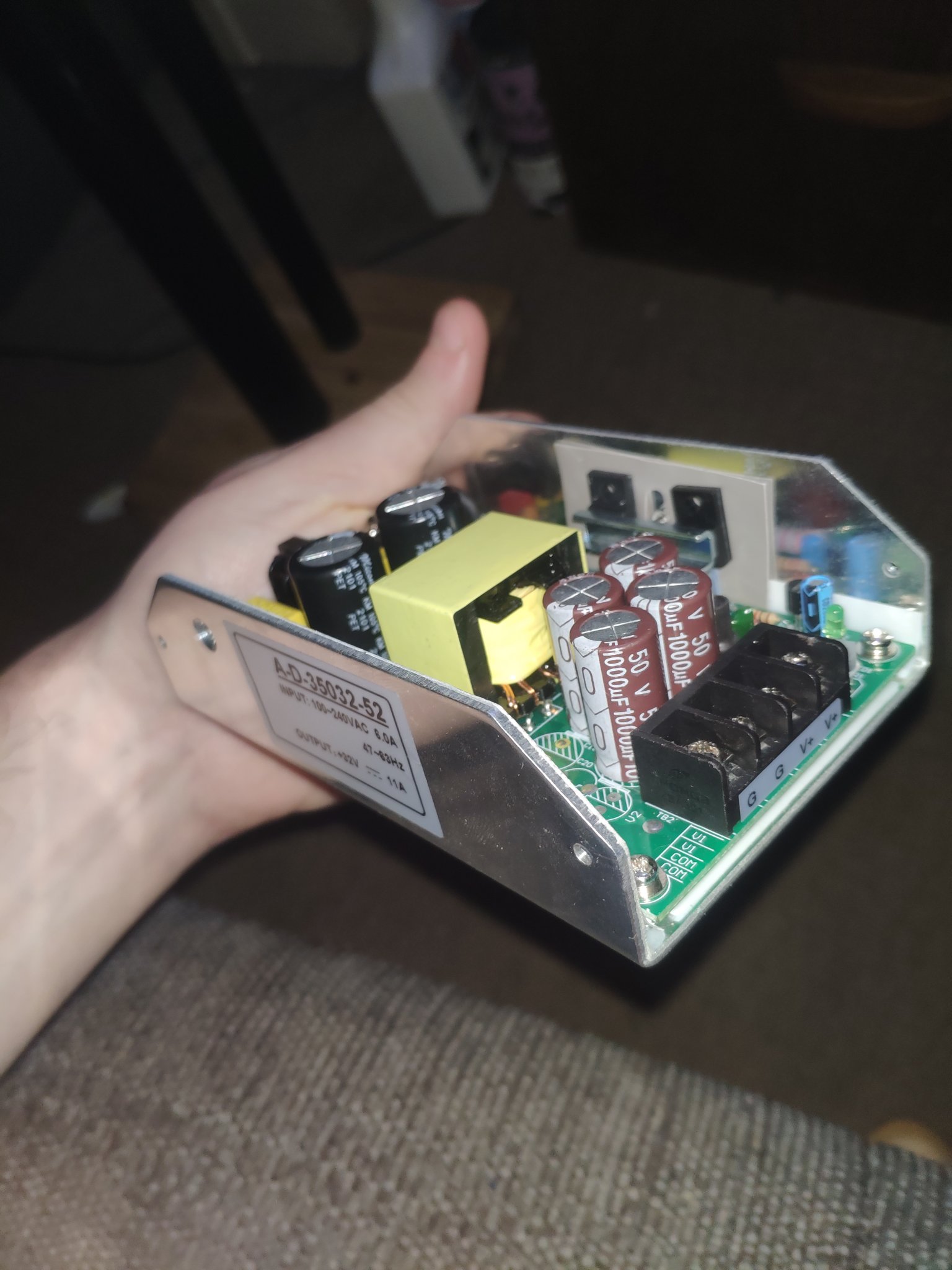

Perhaps this is my issue. Not sure what a symmetrical PSU is? I have tried with meanwell drp 240-24, meanwell lrs 100-24 as well as the below pictured supply.You have tried with a symmetrical switching power I presume?

Ok, it's a single rail power supply v+ and 0v, that can't be suitable.
The board may not be dead for all that...
If you have two power supplies like this, you can connect them in series by connecting the + of one to the - of the other, this will act as a 0V terminal.
The remaining + will be the + terminal, the - remaining the - terminal, the voltage will be 60 volts between the + of one power supply and the - of the other.
English is not my default language, sorry if it's not clear....
Or simpler...Find the right power supply!
