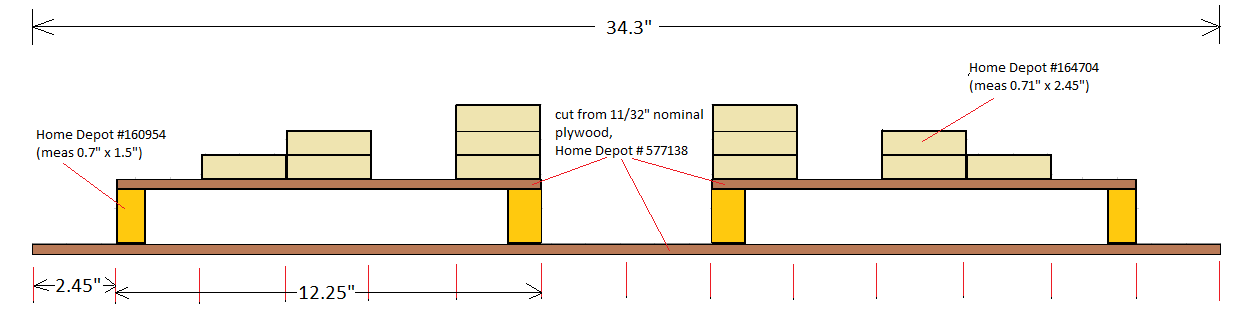

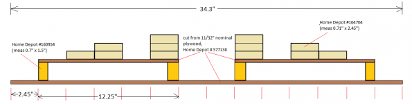

If you make the diffuser that is in the first post here, you don't need a bandsaw, hot wire cutter, or much of anything. Go to Home Depot or Lowes or Menards, buy the boards, already at the right dimensions (except for some simple plywood cuts they may be able to do for you), get a hammer, listen to it tonight!
I'm gonna eliminate the 34" back board, as mine will be "onwall". I will be sure to space correctly. If i use them as a free stand like you show, i can add plywood later, my location isnt really a super probematic area, just a little slap echo.
Plus, when they are painted, they will look pretty cool. I have a wonderful wife who indulges my obsession, and benefits from a kick*** HT, so WAF=0 , thanx gentleman for giving us on a platter this great design :0)

The flat surface i have to cover first is 54" wide, and 8' tall, they are parallel walls. Can i eliminate the back 34" wide board and use three 12" wide diffusers and mount it on the wall, provided the spacing is correct, 4.25" i believe, im not sure. I know two would be fine, but im not sure what adding a third one will do, Ty
Hi everyone, I finally got around to building a set of these diffusers.
Thanks Bill for the detailed information on how to build them. I only made one alteration. I built each diffuser in halves. This was so I could move them around without a crane. Even still each half of a baffle weighs about 80 pounds or so. I fastened them together with lengths of 1 X 4 lumber on the rear with screws and fastened them to the walls with long screws into wall studs. I used “dry wall” screws to assemble the diffusers.
One thing for sure the effect on sound is not subtle. It may be more or less pronounced depending on the type of speakers and your room layout. I use Martin Logan Electrostatics which rely on both direct and reflected sound. My room has always been problematic. With one diffuser on each side wall just behind the speakers many of the issues went away. The focus and centering is much better without losing separation. I have lost a bit of the “air” the system had before, but IMO this has been a good trade off. My non-professional thought is that the diffusers effectively made the room seem about 50% wider. This is a great, not difficult or very costly project that can have a dramatic effect on the sound of your system. Thanks again Bill for posting it.

Hi kg,
I don't know how well it would work without the back board. The design was optimized modeling it as on the backboard of that width, I don't know what the computer assumes is beyond the backboard. I suspect the final step off the back board also figures a lot into the performance. Removing the back board makes the diffusor narrower and not as effectively deep.
The design was done by empirical evolution-type optimization (rather than from mathematical formula like with a quadratic, prime number, QRD, or MLS type designs). A mathematical approach guarantees a mathematically analyzable working design, but not necessarily an optimum or most efficient one. The empirical approach (essentially, lots and lots of trial-and-error with computer siimulation analyzing the performance of each attempt) can have better performance than math derived ones and can be subjected to other constraints as well (see my post at http://www.diyaudio.com/forums/multi-way/267682-diy-sound-diffusers-2.html#post4180176 ). The constraints on my design was that they used only off-the-shelf dimensions of boards other than some backing plywood and go low enough in frequency without being more than about 5 inches deep, and the analyzed result looks particularly good.

The Diffuser Fabrication document stated that when repeating the pattern, the mounting depth needs to be varied to avoid "periodicity" (which I would assume to be similar to a comb filter effect). The center one could be slightly raised more than the flanking 2.
Diffuser-A1LF-Fab-Drawings-Arqen.pdf
To reduce the effects of periodicity in the array, mount modules with varying depths as follows:
[0 cm, 5 cm, 6 cm, 5 cm, 0 cm]
This one uses 5 and multiple depths.

They are exactly the multiples of the given wood dimensions. The model was optimized restricting to such dimensions. I think the AFMG screen of this one is the attached (not sure, but it's at least a close one)
It is not a mathematically derived type diffusor like an MLS or RPG type, it is an empirically optimized/analyzed type (which can be just as effective, by the way).
