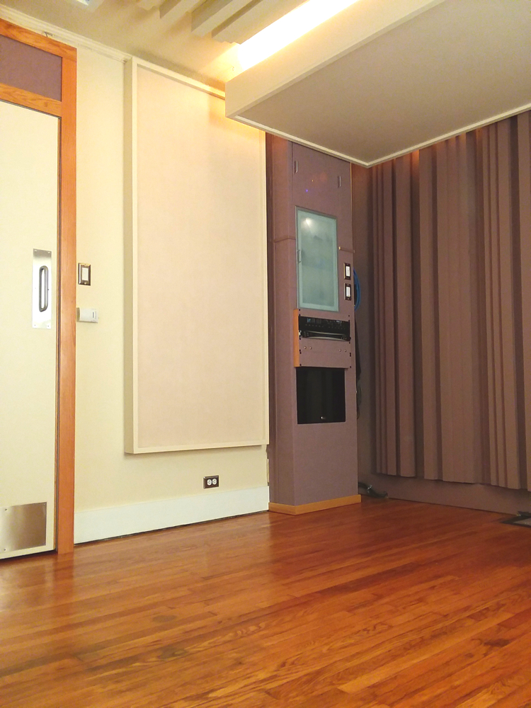

Here is a little bit of Mini-Me and Where's Waldo. See if you can find the Depot-Diffuser serving double duty.
Putting my room back together so things are in a bit of a disarray. Broadband traps are not hung yet and will be recovered. May make AbFusers out of the broadband traps.

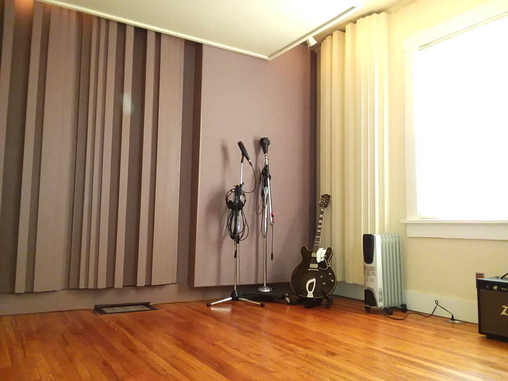

I came across this helpful "Depot" approach as I was designing a dining/tracking room. Having already ruined a perfectly good living room by turning it into a mixing room (thanks, Honey!) I was tasked with acoustic treatment that would still allow human dining, be "tight & bright" enough for a drum kit or guitar amps and be economically DIY. I've tested the room (11' W x 13.5' L x 9.2' H)with guitar amps moderate to screaming and the room is excellent. Full drum kit next week.

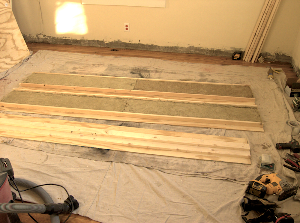

First, thanks to Bwaslo for designing these and sharing the construction technique. I am building four of these for my back wall. I have started to build them and then stopped my construction as I ponder an adjustment to their construction.
There is some empty space behind the outside plywood piece which supports the furring strips which form the diffuser steps. This empty space is created by the two 1 x 2 wooden pieces which supports either end of the outside plywood pieces. If one 1 x 2 piece is moved inward towards the center of that outside plywood piece, it would make a horizontal space which would add to the diffuser "depth." The potential downside to the horizontal space is that the absorption would be greater than the vertical wells. But it would be interesting to at least model the effect that a horizontal well could have on the diffuser performance. I hope to get the model working to see if I can model this change, and figure out how deep the horizontal wells should be for best performance.
Just one construction idea that I used. For half of the 1 x 3 pieces I used rough furring strips, but for the pieces facing the outside, I used finished pieces so that the outside face of the diffuser would have a nicer appearance. The downside of this approach is that the rough 1 x 3 pieces are a little wider than the finished ones. I started out sanding the wider pieces down, but this was going to take forever, so I ripped them using a table saw and that worked good, and then I touched them up with some finish sandpaper to smooth out the finish of the table saw cuts.

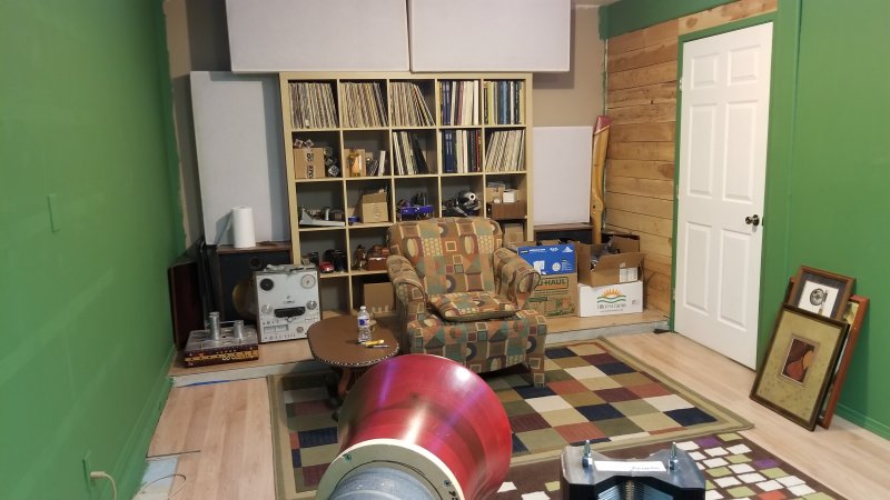

I plan on building the Depot Diffuser for my room. I have an Idea 5x5 bookcase in the back of the room surrounded by bass traps (see pix) and want to build two diffusers as tall as the book case and on hinges so they will be doors. so, do I have to do anything special where the two Door Depot Diffusers meet in the middle?
Also I'm wondering if building them for the front behind my audio rack will add anything to the room's sound quality???
P.S., I am just now setting up the room so excuse the mess.
